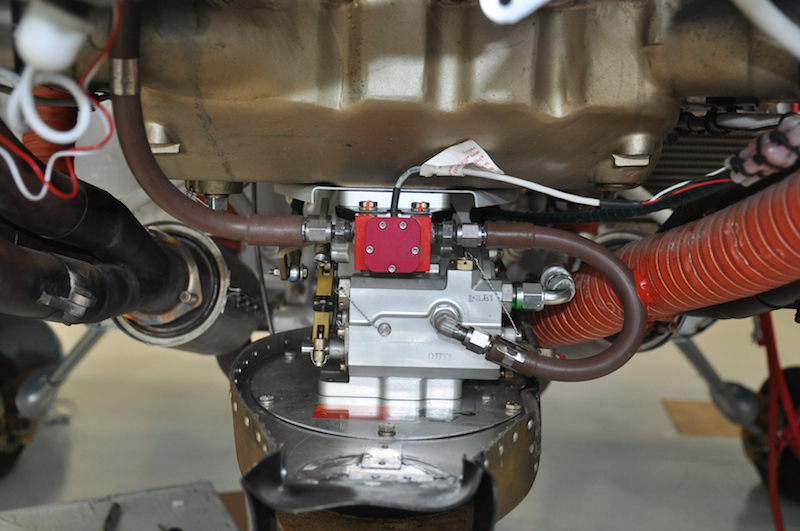

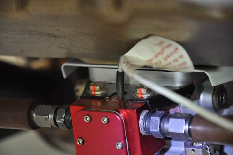

PostPosted: Fri Feb 17, 2017 6:25 am    Post subject: Fuel pressure problems continuing / possibly relocating the Reply with quote
Dan,
I think the best place for the red cube is between the servo and the fuel distributor (spider).  I like the method shown in these pics.  It's an -8, but the idea is the same.  Fab a steel bracket that catches the two forward servo-to-sump mounting bolts.
I'd be looking pretty close at your engine pump at this point, or your pressure sender.
--Dave
[img]cid:ii_15a4c74fb413e6af[/img][img]cid:ii_15a4c74f9180647f[/img]

I relocated my Flowscan from the tunnel to between the pump and spider -
it resolved the inaccurate reading problem. (The problem was actually
pretty minor since I ran the boost pump for such limited amounts of
times but now it's just dead nuts accurate).
I simply cut the fuel line and inserted the flowscan unit wrapped in
head shield. I secured the ends of the fuel line but the flowscan unit
is floating so to speak. I just could see any reason to secure it
further. Many hours later - all okay.
Bill
