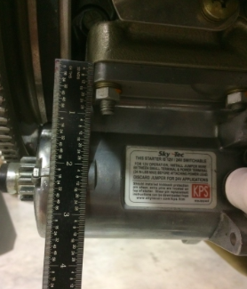

PostPosted: Fri Feb 17, 2017 7:30 am    Post subject: Sky-Tec NL vs LS starter Reply with quote
Tim,
I'm not familiar with the 149-12PM, so I can't comment on the differences between the fit.  However I have the NL, and can't imagine that you would have any fit issues.  It tucks away into the engine nicely.  Perhaps you could have a scat tube, cable, or wire in the way, but I doubt it.
Here's some photos with a straight edge to help put things into perspective.
For the record, I have a dual alt/battery setup with dual PC-680's on the backend.  I also have 9:1 pistons and a the NL starter doesn't even blink at spinning the MT on a single battery.   Plenty of torque off a 680 for the 9:1 pistons.  Your PC-925 and 8.5 pistons (IIRC) won't have any issues at all.
Phil
[img]cid:ii_15a4cadb70a02f40[/img]
[img]cid:ii_15a4cae019fc7c07[/img]
[img]cid:ii_15a4cae50f7acba8[/img]

That's kind of what I figured Phil. The photos all make it
look much longer than the LS/PM versions. The LS and PM
seem to be almost identical, with the solenoid on the opposite
side of the main body. I may have some small wires like for
my lightspeed ignition or something that I have to
adjust but I don't expect anything major. It's just that
going from a short/wide starter to a narrow/long one
had me wondering if I was overlooking something. I guess
I'll know in a couple weeks.
I'll report back after I get them installed.
Tim

philperry9
Joined: 23 Nov 2011
Posts: 381
PostPosted: Fri Feb 17, 2017 8:05 am    Post subject: Sky-Tec NL vs LS starter Reply with quote
I'm at the hangar now, trying to get this thing finished up, so I can give you any measurement you want.
The back of the starter to the front of the sump is exactly 1".

On 2/17/2017 9:26 AM, Phillip Perry wrote:
Tim,
but I doubt it.
any issues at all.
Phil
