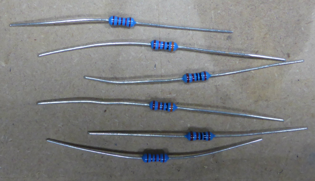

Can you guys tell me what these thing are and what they are used for? (attached photo) They were in a small bag with a bunch of terminal connectors that (I think) came with an engine instrument monitoring package for Dynon Skyview.[img]cid:ii_iyrp9snv0_15a0ad7a39d5d52c[/img]

They look like resistors to me. Try the link below, & cross check with your ohm meter.
Charlie
https://www.google.com/webhp?sourceid=chrome-instant&ion=1&espv=2&ie=UTF-8#q=resistor+color+code

They’re resistors of at least two, perhaps three different values (it’s hard to be sure of some of the colour bands in the photo). Resistor value decoders are available all over the Internet, like this from DigiKey > http://www.digikey.com/-/media/Images/Marketing/Resources/Calculators/resistor-color-chart.jpg?la=en-US&ts=72364a89-2139-476a-8a54-8d78dacd29ff
The only place I recall (off the top of my head) installing resistors in the Dynon setup is at the point each Tacho signal wire taps into the P-leads (in my case at the magneto switch terminals). Small resistors are a dime a dozen, but only one each P-lead is required for that particular task.
