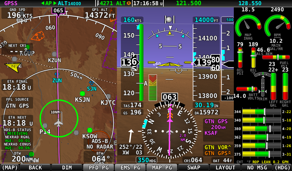

PostPosted: Fri Feb 03, 2017 7:10 am    Post subject: Whirlwind Propeller RV10 Reply with quote
Kelly,
The plane has a stock engine and prop (other than injectors changed as needed to balance the cylinders), and still flying with these !#&$ mags as I wait for the six cylinder pMag.  I tried to keep the plane light (1659 pounds empty after a relatively heavy basecoat/clearcoat paint job).  I also spend a bunch of hours on rigging.  To be fair, the top speed run was done solo at 6500’ with half tanks and the engine ROP.  Airframe modifications include:
<![if !supportLists]>· <![endif]>James cowl and plenum
<![if !supportLists]>· <![endif]>James wheel pants
<![if !supportLists]>· <![endif]>Modified air box
<![if !supportLists]>· <![endif]>Extra shim under the HS forward spar (not really sure if this does much but the elevators seem to me more in trail with the shim)
<![if !supportLists]>· <![endif]>Not yet done is to put the damns back in front of #1 and #2 cylinders, but much shorter than what I started with
The plane was set up from the start for high efficiency LOP cruise.  The downside is the reduced cooling drag requires 125-130 kt climb speed to keep the jugs cool, so no pointing the nose up and hanging on the prop.  The attached screen shot is a typical cross country set up.

Something isn't stock about your speed. You are 5 mph above Van's stated max speed at light weight, and 15 above their stated 75% cruise speed at light wt. I don't know whether your speed is a 3/4 course GPS speed, EFIS calculated speed or something else.
Don't have precise charts with me at moment, but I think 25 sq is a bit above 75%
-sent from the I-droid implanted in my forearm
On Thu, Feb 2, 2017 at 6:45 PM, Carl Froehlich <carl.froehlich(at)verizon.net (carl.froehlich(at)verizon.net)> wrote:
--> RV10-List message posted by: Carl Froehlich <carl.froehlich(at)verizon.net (carl.froehlich(at)verizon.net)>
Yep - add power and the fuel to get it and you go faster.
Carl
RV-10, 188 kt TAS, 25" (at) 2500 RPM, stock IO-540 and Hartzell 2 bladed prop
