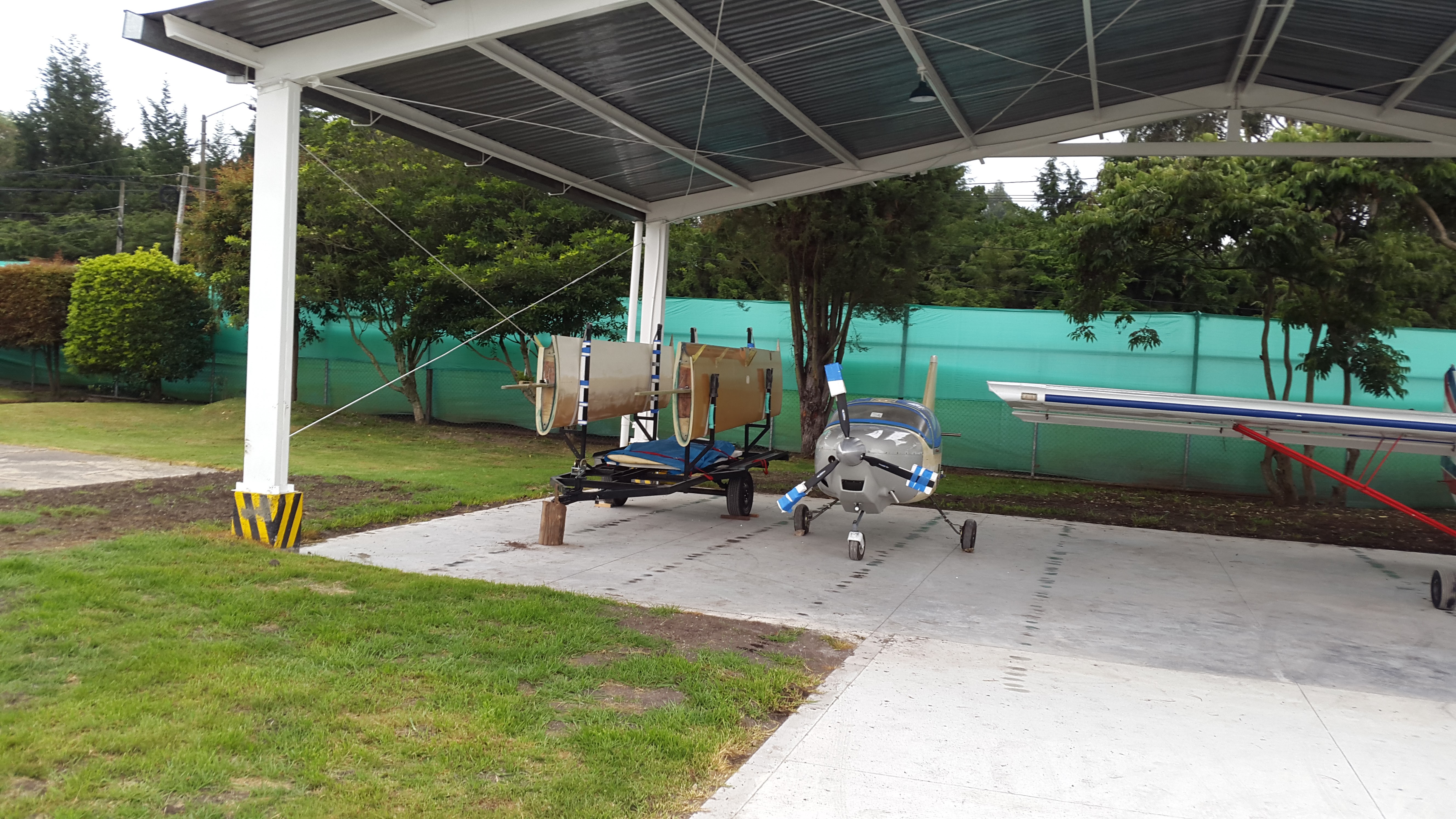

Finally after 12 years ....HJ460 is now in its hangar awaiting paint.  We fired up the engine and the dynon and much to my surprise everthing works
I realize that this is not over and I have merely completed phase 1.
HJ460 is a "fast build" (hahahaha) with gel coat over wings and fuselage and the cloth flying surfaces are filled and sanded.  She has the minor dings and epoxy drips from 12 years of constructions.
