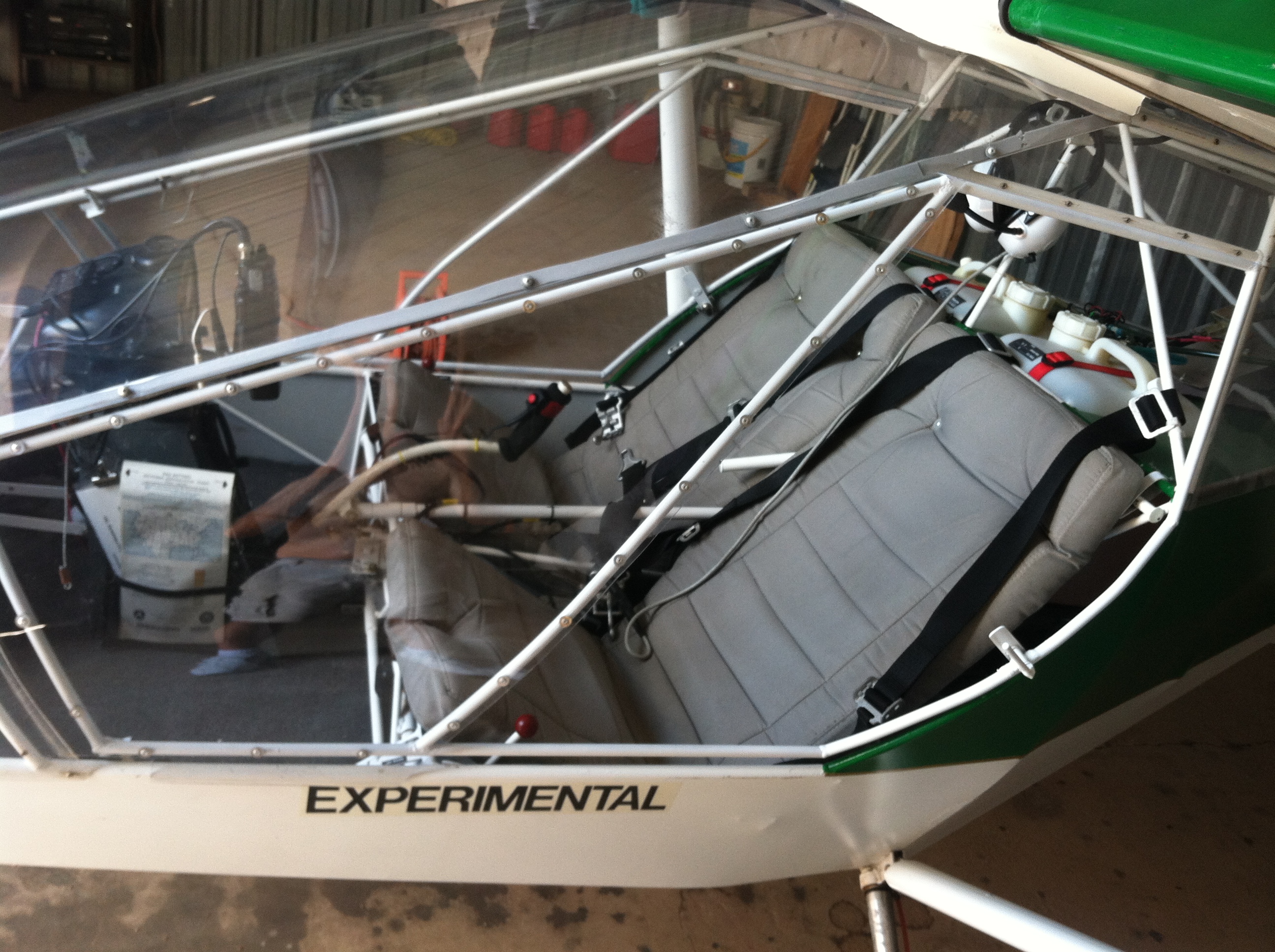

 Filesize:  1.71 MB
 Viewed:  10955 Time(s)
