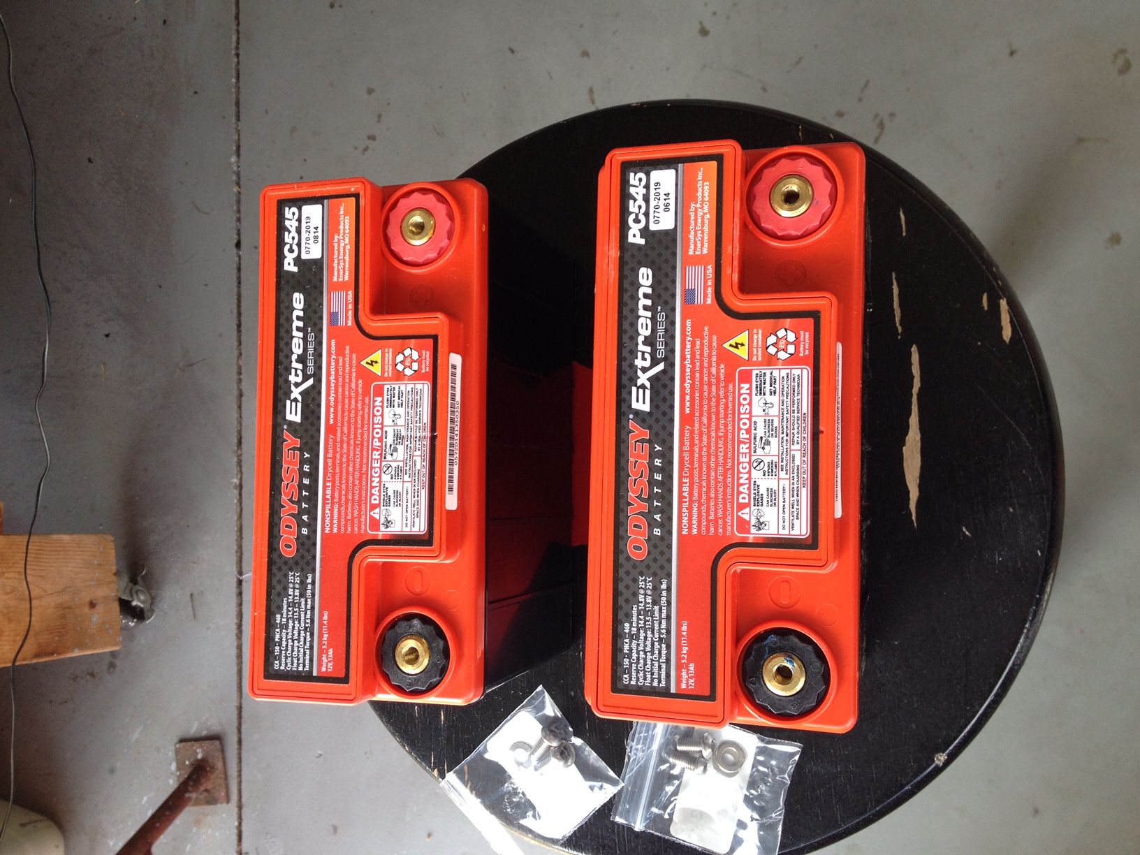

PostPosted: Fri Jan 06, 2017 1:48 pm    Post subject: Battery replacement Reply with quote
2 Odysseys' PC545 in series; love them.

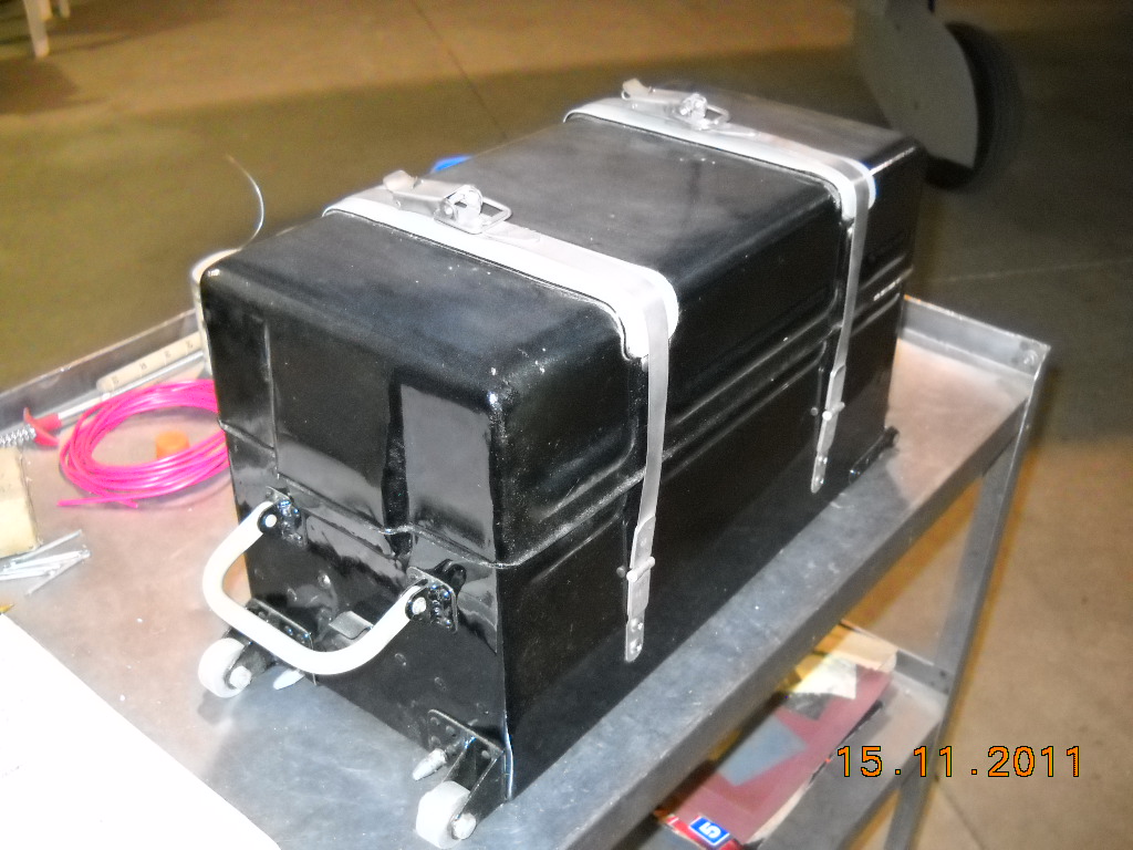

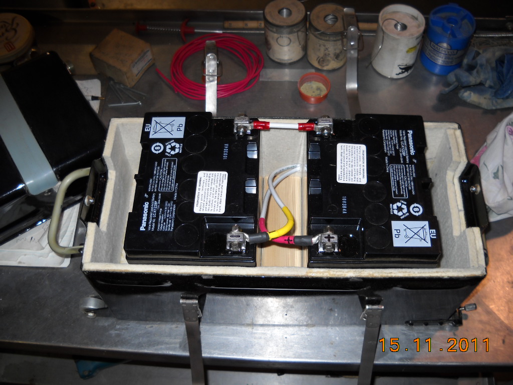

PostPosted: Fri Jan 06, 2017 8:51 pm    Post subject: Battery replacement Reply with quote
Craig;
I have settled on the Panasonic LCX1228P, 12V Valve regulated lead acid. 28 Amp/Hrs. Whole lot of overkill but will out last typical Gill or Concord at least 3 lo 1.
Fits nicely in the CJ battery box – see pics.
In customers CJ (NO battery minder and at least twice inadvertently discharged –switch on) Still strong at sale of A/C after 9 years.
On my CJ. going on 6 years, with a battery minder (type recommended by Mark Bitterlich) I have not seen a no-load voltage less than 26.5. With almost constant de-sulphiding and trickle charge I would not be surprised if they lasted 20 years.
Walt
