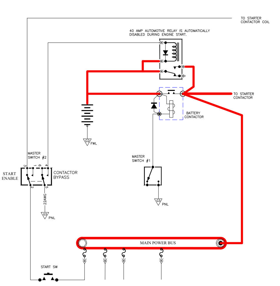

Here is a circuit for those concerned about the master contactor failing. An automotive relay is connected in parallel with the master contactor. The relay is disabled during engine starting to prevent excessive current from flowing through the relay contacts. Prior to turning on the master contactor, the relay can be energized to be sure that it works. The relay must be shut off to start the engine. After engine start, the relay may be turned back on. If the alternator fails, the battery master contactor can be shut off to conserve energy.
During cruise flight, the relay will only carry battery charging current. Aircraft load current will flow directly from the alternator to the main power bus, not through the relay.
When playing with avionics in the hangar with the engine off, the relay can be turned on instead of master contactor. Notice that the arrows on arc-suppression diodes point towards positive.

Joe Gores

If you're going to that much trouble why not just have two independently switched contactors?
There is not much trouble, same number of components either way. The relay has the advantage of less current, less weight, less cost, and less space. I am not necessarily recommending this circuit. Just offering it for others who want redundancy.

PostPosted: Fri Dec 23, 2016 3:26 pm    Post subject: IBBS battery with B and C alternators? Reply with quote
The only contactor failure I've had is when it welded itself shut, due to a short in the starter motor. It's quite unusual not being able to turn off the aircraft..
