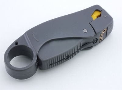

How many of these do you need to do? There
MIGHT be 3-blade strippers like those used
for coax
[img]cid:.0[/img]
These feature adjustments on depth of cut
but the spacing between the blades is fixed
and unique to the mating connectors. Unless
you have a lot of these wires to strip, you
would probably do well to practice making your
cuts with an Xacto knife on some scraps of
wire.

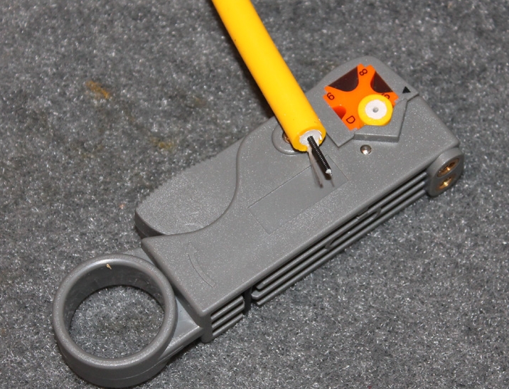

A websearch on spark plug wire strippers
yielded some results . . .
This tool offered by MSD has a blade guide for
manual stripping and also crimps the bear-hug grips
on terminals. I also found what appears to be an adjustable
2-blade tool. Suggest you explore local auto-parts stores
especially speed-shops that cater to the more adventuresome
DIYers.
