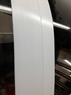

PostPosted: Tue Nov 08, 2016 2:11 pm    Post subject: Caulk around windows? Reply with quote
I filled with micro and glass taped over the edge of the window
[img]cid:F19AB526-8648-48A5-859E-BF51909E986D[/img]

Thanks. I'm talking about the interior side specifically. The outside is already completed.
