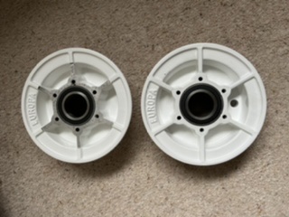

PostPosted: Thu Aug 18, 2022 12:46 am    Post subject: Re: Mono wheel bearings Reply with quote
Thanks for these measurements - the builder manual gives a choice of bearings but one of them leads to a metric sized bearing which is definitely wrong. The sizes above are spot on, thank you
