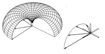

I have read that the radiation pattern from the antenna is horizontal and in the shape of a donut.
Sort of . . . it's 'half a donut' . . .
[img]cid:.0[/img]
If this is true then under seat would seem to be a good location. Also, since I need to add a ground plane, would this serve to reflect any radiation?
The ground plane is essential to antenna performance.
