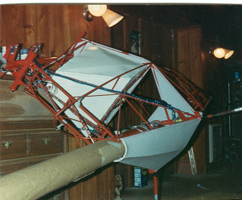

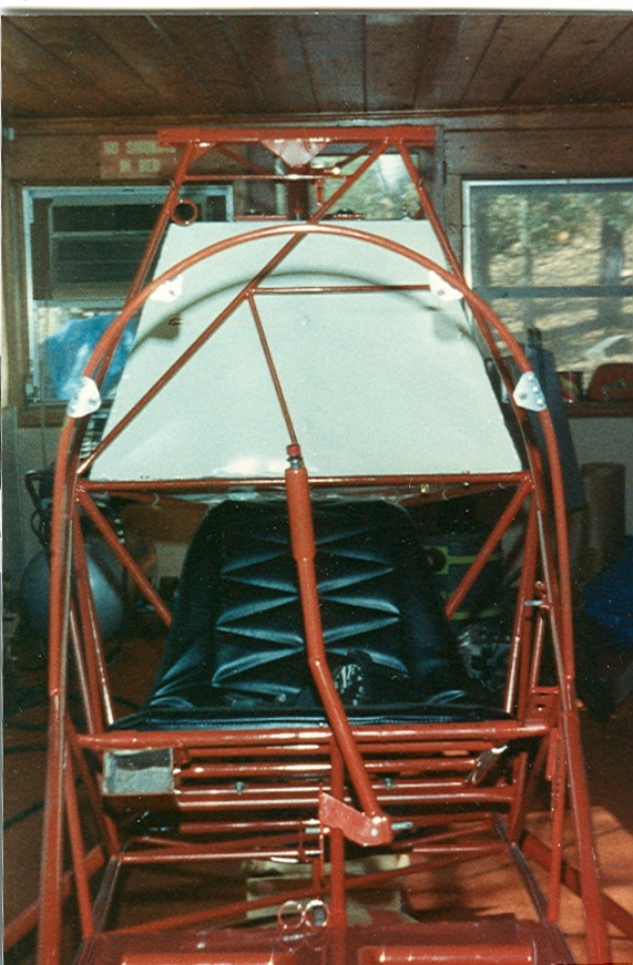

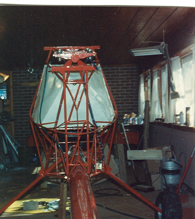

PostPosted: Wed Jul 06, 2016 11:36 am    Post subject: Ultrastar dihedral Reply with quote
I have always liked the original Firestar better than the FSII, and the original MKIII rather than the MKIIIx.
With a few modifications on the original FS and MKIII, both are really good performing, fun flying airplanes.
A fully enclosed fuselage on both models encourages better performance. A few tube here and there in the wing and the fuselage make them even more crashworthy. The angle of the landing gear makes fitting 36" 4130 gear legs a breeze on the original FS. Open cockpit is nice, and a 3" Lexan fairing on top of the windshield will increase cruise speed 5 mph and keep the wind out of your face and over the top of the center section. My Firestar was configured with an 18 gal 5052 fuel tank above and behind the center bulkhead, opening up the bottom of the rear fuselage for cargo. Stuff could also be stored behind the seat and under the seat depending on what kind of hard seat and 4130 seat frame you decided on. Weakness in the original FS was the wings and lower longerons on the rear of the fuselage. Additional bracing too care of the fuselage. 7 ribs and additional larger tubing for lateral bracing of the leading edge of the wing to keep the rib noses in column is another important improvement. Small 4130 streamlined lift struts increase speed and glide, reducing vibration.
Been a long time since I have been involved with an original FS. My last flight was March 1990, 26 years ago. A lot of the improvements Brother Jim Hauck and I made to the FS, we incorporated into the MKIII.
The red partially covered fuselage is my FS during the winter of 1988 rebuild. The photos show the 18 gal fuel tank, additional 4130 bracing, 36" 4130 gear legs, 4130 windshield bow with mounting tabs to hang the instrument panel.
 Filesize:  340.55 KB
 Viewed:  23137 Time(s)
 Filesize:  325.92 KB
 Filesize:  296.33 KB
victorbravo(at)sbcglobal.

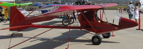

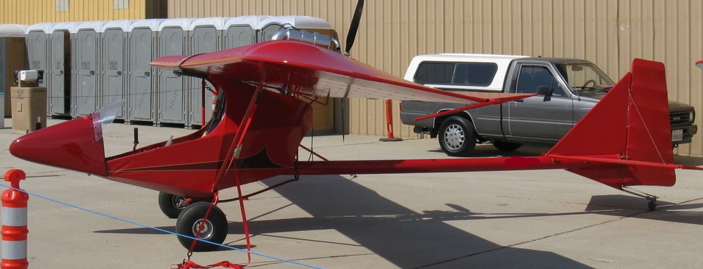

PostPosted: Wed Jul 06, 2016 12:39 pm    Post subject: Ultrastar dihedral Reply with quote
John H. thank you for your comments. Do you or any of the other Kolb List folks recognize this aircraft (photos attached) and/or know anything about it? I am possibly interested in purchasing it. It has some pretty strange visual things, the nose cone looks a lot different, and the bottom of the fuselage looks different (fabric covering contour).
Also John H. the landing gear legs on this aircraft look different than other Firestars I have seen, they are swept forward. The sockets welded in the fuselage come straight out spanwise3 (not forward or rearward), and the builder apparently BENT the gear legs forward so the airplane would not be as easy to nose over. Is this standard on a Firestar 1? I would very much want to install the longer 36 inch gear legs as you mentioned, but I am worried that it could cause a nose-over problem.
Any experience, historical knowledge, and recommendations for this are very much welcome. Anyone who knows this airplane,a nd can tell me it is good, bad, safe, unsafe, problematic, etc. please speak up Smile
Bill Berle
On Wed, 7/6/16, John Hauck <jhauck(at)elmore.rr.com> wrote:
Subject: RE: Re: Ultrastar dihedral
Date: Wednesday, July 6, 2016, 12:35 PM
than the MKIIIx.
reducing vibration.
panel.
 Filesize:  121.79 KB
 Viewed:  23135 Time(s)
 Filesize:  52.55 KB
PostPosted: Wed Jul 06, 2016 3:03 pm    Post subject: Ultrastar dihedral Reply with quote
Not familiar with this aircraft.
Longer gear legs actually reduce the tendency to nose over. I had good luck with 36" legs.
Bill Berle

PostPosted: Wed Jul 06, 2016 3:18 pm    Post subject: Ultrastar dihedral Reply with quote
Thank you John H, but I believe this Firestar was part of one of the Monument Valley fly-ins. I have a photo of it that was apparently taken at MV airport.
Bill Berle
Bill Berle

Thought I had made a comment about Kolb dihedral recently, but undoubtedly I didn't.  I can't find it.  Another senior moment.
Homer Kolb wanted to squeeze every bit of performance out of his aircraft.  He initially designed straight wings, no dihedral.  His idea of flying was right over the trees as slow as he could go, not as fast as he could go.  He wanted to stay in contact with the ground.  The Ultrastar had huge barn door ailerons to control roll right through stall.  All of Homer's designs have aileron authority below stall.  Yep, the ailerons work when the Kolb is mushing and isn't flying anymore.
Homer didn't like the way the wings looked drooped when sitting on the ground.  He put 1" of dihedral measured at the outboard rib, for aesthetic purposes, for the US and FS.  The MKIII got 1.5".  Not long before Homer died, he rebuilt the factory Firestar that Dick Rahill crashed at Oshkosh 1989.  This was the 1985 Oshkosh Grand Champion Ultralight.  In 1985, there weren't any ultralights that performed like the FS.  During the rebuild Homer put 3" of dihedral in the wings.  I flew the FS after the rebuild, but only around the farm.  Didn't even think about the increased dihedral, so can't comment on any improvements.
Experience flying a Kolb indicates Homer's designs don't need to be redesigned to fly quite well.
Kolbs are not rudder, but aileron aircraft.  If you lose ailerons you lose the aircraft.  They don't fly long without aileron control.
1985, I experienced total aileron loss on my Ultrastar.  One of the aileron bell cranks pulled the weld out of the upper torque tube.  Immediately went into aileron flutter (no counter balance weights back then).  Luckily, I was flying 75 MPH straight and level, but at 250 feet AGL.  Without hesitation, I deployed my Jim Handbury hand deployed parachute.  Half an oscillation later, the blink of an eye, and I was on the ground without a scratch.  Airspeed was a major contributing factor in getting a full canopy before I hit the ground.  Thanks, Jim.
