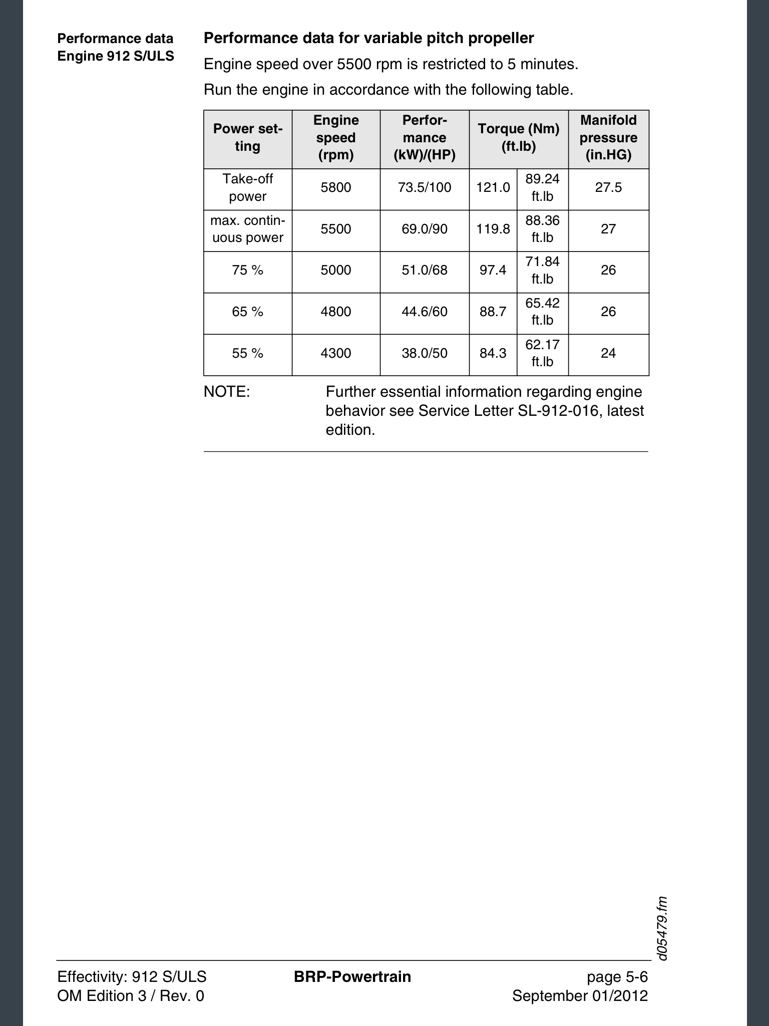

PostPosted: Mon Jul 04, 2016 10:57 am    Post subject: Power settings for 75% power in cruise VP prop? Reply with quote
Jonathan.
The ROTaX manual provides a power setting tables hopefully attached.
The 75% power equates to 5000rpm and 26 MP.
Alan
GOBJT
Sent from my iPad

dg.watts(at)talktalk.net
PostPosted: Mon Jul 04, 2016 11:20 am    Post subject: Power settings for 75% power in cruise VP prop? Reply with quote
Jonathan
Oops, sorry I quoted the 912 figures and not the 912S. I have got both operators manuals because my daughter has got the 80 hp in her Europa.
Dave Watts

Guys, thanks for the replies. Firstly I don't have a manifold pressure guage, but only an old car economy guage to give warning of carburettor ice build-up. Permission was given for this and it works very well, although the needle moves in the opposite sense. Because my 912 ULS engine isn't turbo boosted, there's no chance of "overboosting".
Now to my puzzlement about the consequence of using a constant speed Airmaster propeller and changes in horsepower without changing rpm. In my simple brain, if I have 5000 rpm selected for cruise and move the throttle within the governed range, then the horsepower MUST increase as I move the throttle from lowest position at which 5000 RPM can be maintained to the fully forward position, still at 5000 RPM.
Therefore the tables provided in the engine manual become nonsensical regarding RPM vs horsepower. It's more likely to me that the only immediate indication of horsepower being produced must be manifold pressure.
So assuming I generally cruise at 4700 RPM for aural comfort, indicating 115 to 120 KIAS and at a fixed throttle position, what remains for me to have an idea of what % power I'm using is fuel consumption. Somehow I've acquired the idea that 18.5 litres/hour suggests about 75% power.

PostPosted: Mon Jul 04, 2016 3:10 pm    Post subject: Power settings for 75% power in cruise VP prop? Reply with quote
The VP prop will adjust itself within the limitations of the propellor pitch adjustment to maintain the rpm setting although if the throttle is not open sufficient there will be insufficient power to even maintain the set rpm on full fine and the rpm will drop at lower throttle settings. Therefore power is related to the throttle setting and this will adjust the MP until Wide Open Throttle is achieved. Full consumption will rise as you open the throttle and therefore produce more power.
Not sure where you have obtained the 18.7 number from but the Power/Fuel Consumption performance graphs in the ROTAX Operating manual should be your guide and more important I suggest a MP Guage to provide you with the performance settings you want to achieve and also measurement of the fuel consumption for your aircraft at chosen cruise altitudes so you best able to determine the performance and range of your aircraft. Relying on someone else's figures is never wise.
