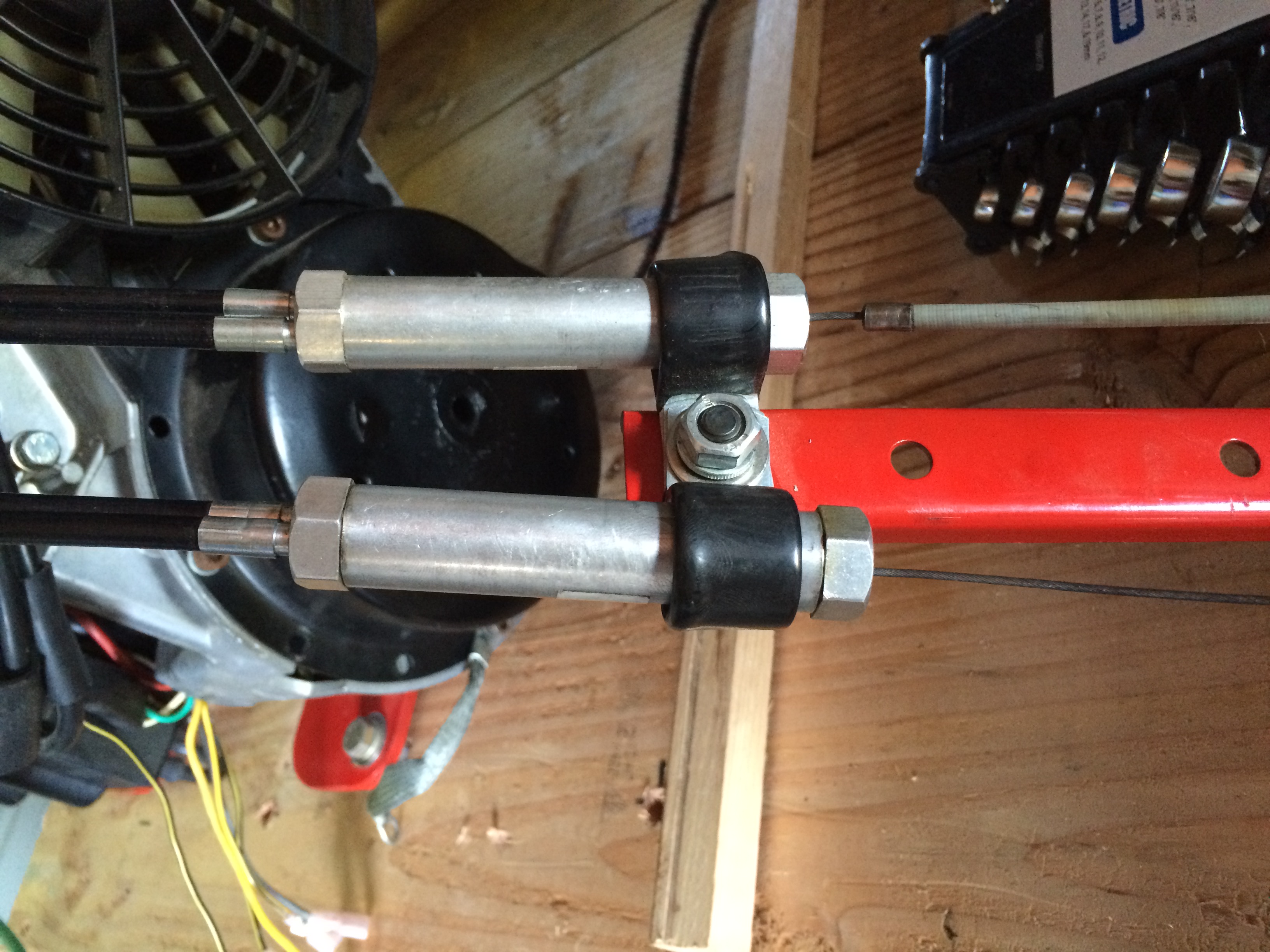

Looking for some input. I want to replace my throttle and choke cables for my 503 from the fitting which combines the individual throttle and choke cables to my throttle and choke controls. The end which goes into the combiner is rather small and I just can't seem to find any at Aircraft Spruce or general internet searches. Any input will be appreciated.

Kolb has them . I stopped by and bought them for my last Firefly..Herb

I'm just taking a wild guess... Aren't they the same as break cables for a bike.     Every thing on my plane came from kolb,   they should be able to help !

Recommend contacting Kolb Aircraft for the correct cables.

Take a look here: http://www.greenskyadventures.com/throttle_cable/itemized09.htm
This will also be helpful: https://www.youtube.com/watch?v=mRu04zt-hnk
