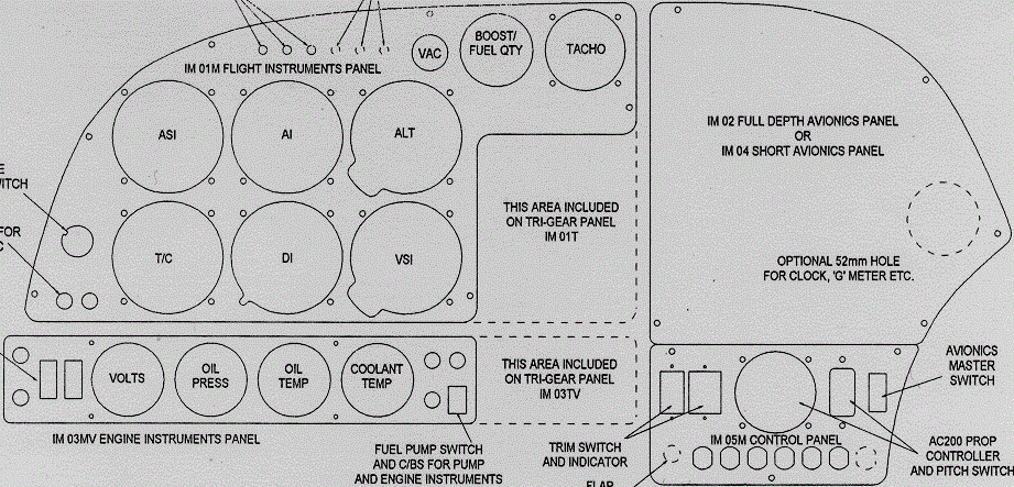

PostPosted: Sun Jun 05, 2016 12:03 am    Post subject: Re: New panel Reply with quote
Vince, here you are.
Width 27.807"
Height 12.905"
Blue skies, Jacques.

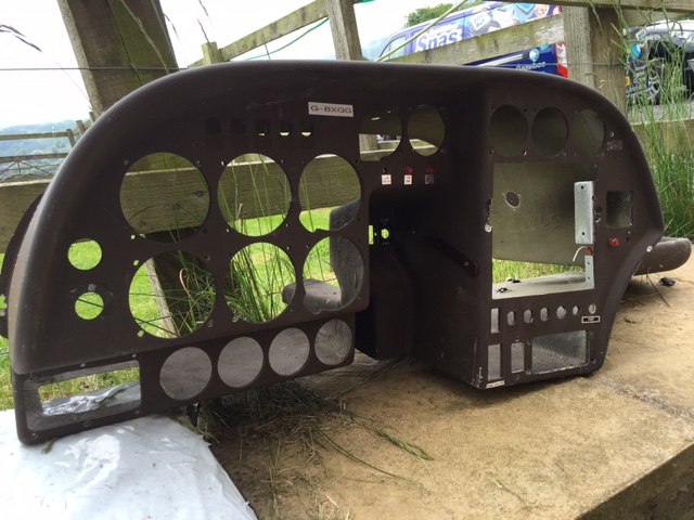

PostPosted: Sun Jun 05, 2016 2:21 am    Post subject: New panel Reply with quote
It's the whole unit I removed mine and replaced with a new one as it needed changing pic enclosed for you
[img]cid:3C6D1341-59F5-4D7B-BDFC-6AEF485201A5[/img]Rgds

Vince, You can always do it the pre CAD way - cut your existing panel out where you want the new removable section (with a thin saw), and use the cut out as yourpattern for the new panel. Make paper shapes of dimensions of instruments to go in and play around for best fit. It has worked well for me for three panel designs.
