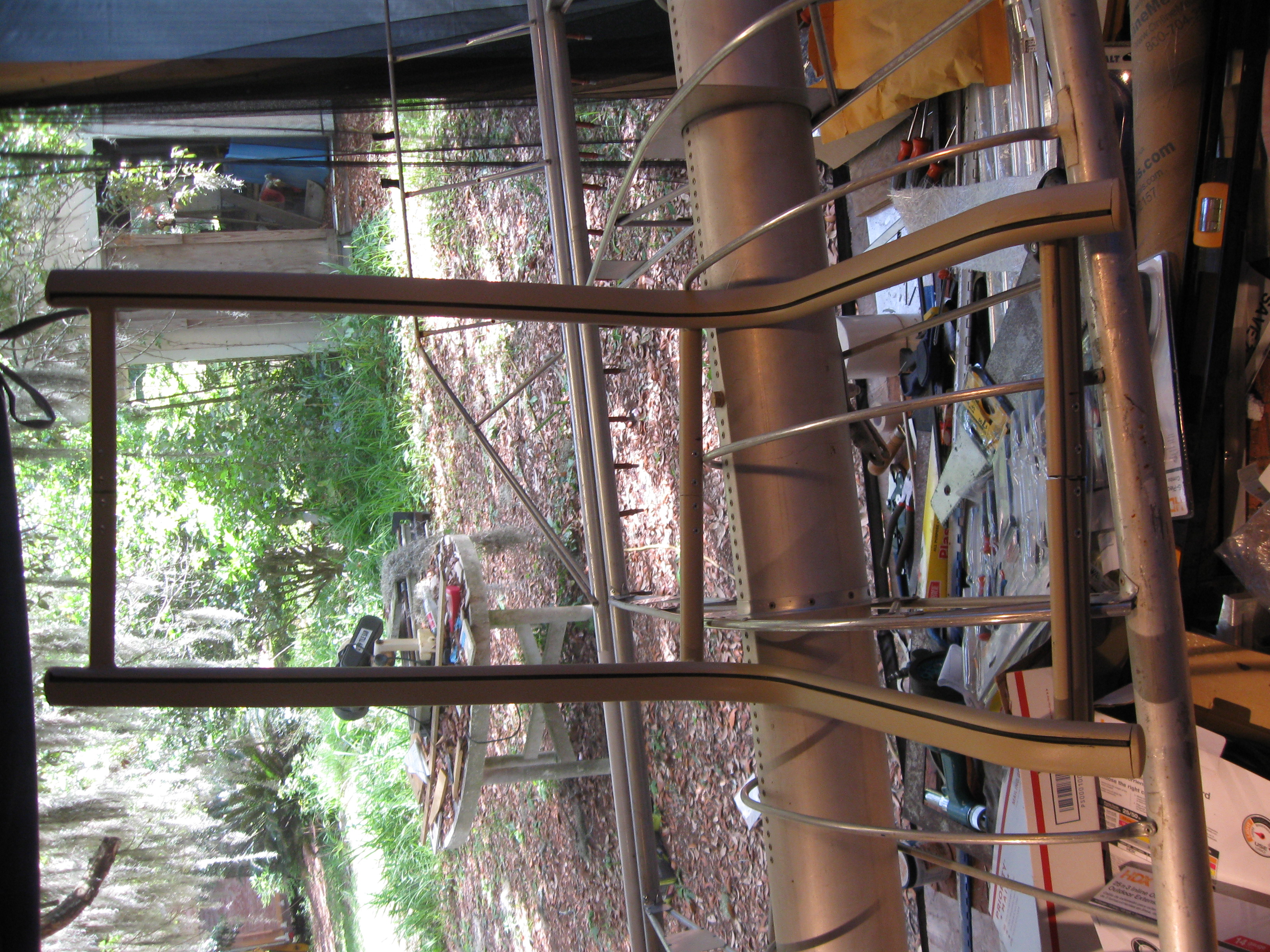

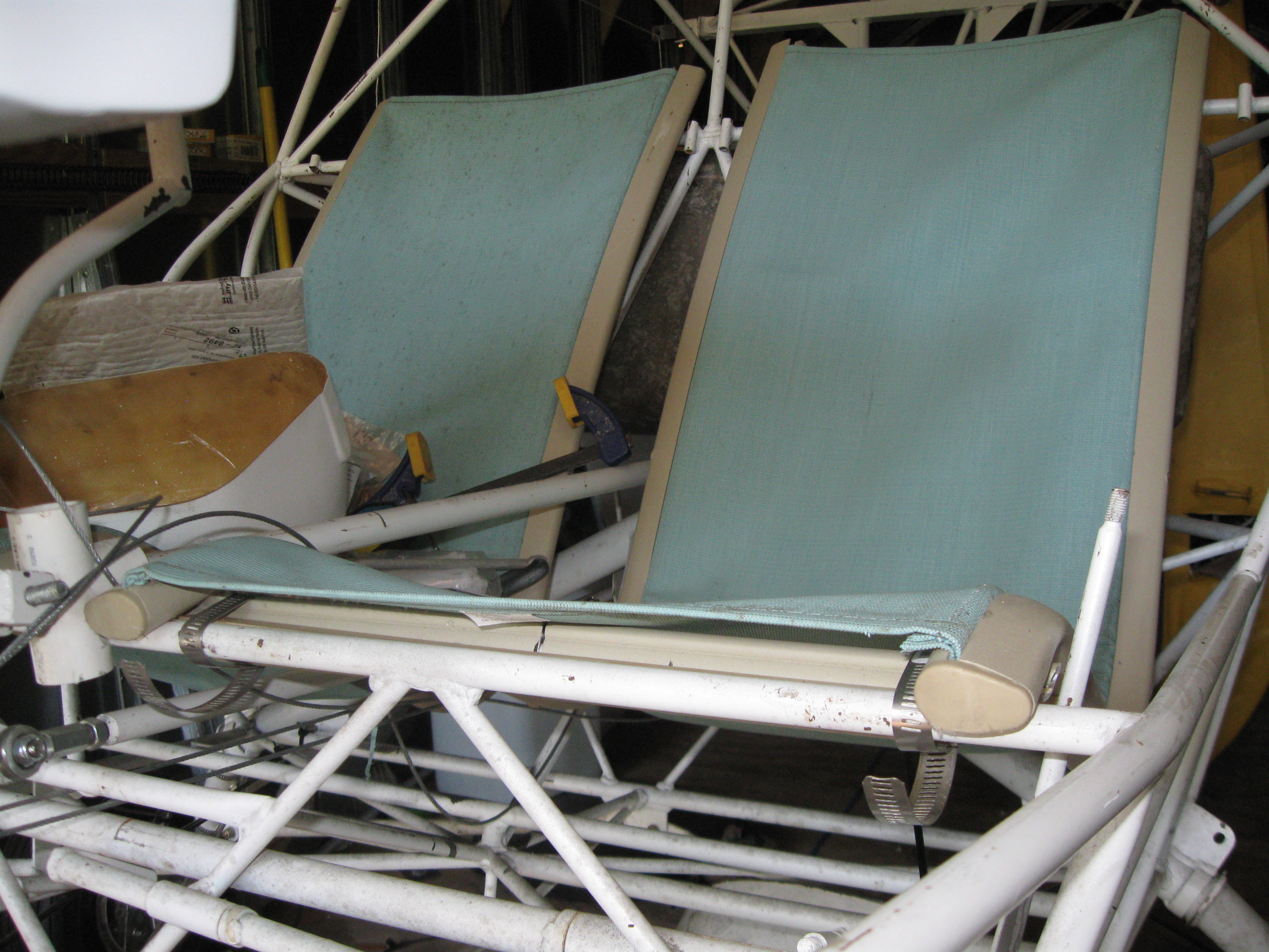

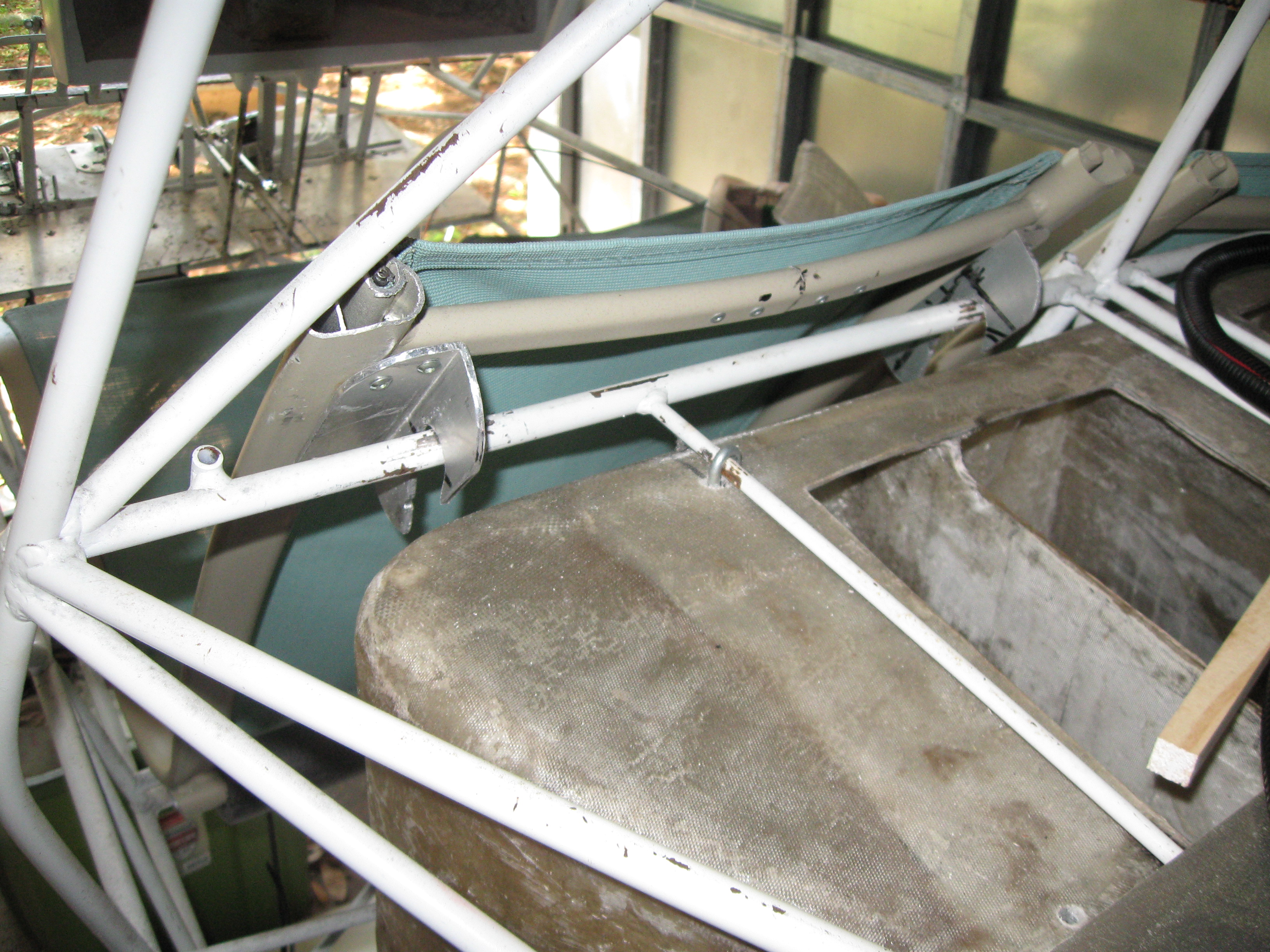

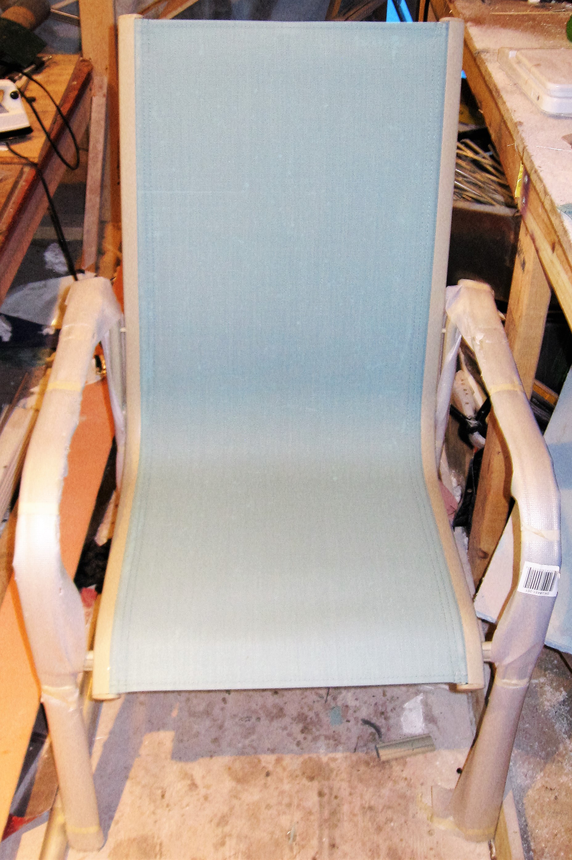

I found some aluminum patio sling chairs (powder coated steel will work, just heaver) at Home Depot. Cut off the legs and in my case I narrowed them by first removing the cloth (it's held in by a spline inside a pocket sown into the cloth that's slipped through a channel in the frame) cutting out a section of each cross member by 2", inserting 3/8 x 4" steel tubes and riveting them back together. The cloth for the seat can be narrowed by sowing a pocket or as I did fold the cloth in the proper place crease it lay the spline against the fold and thread it back into the channel. I used 2" aluminum angle to make hooks for the upper seat bar. The lower seat cross member is slipped behind the lower seat bar with the ends of the seat frame sitting on top held in place with a s/s pipe clamp. I find this seat very comfortable and it's much lighter than any other seat frame I know of. Hope this is of value to you.
