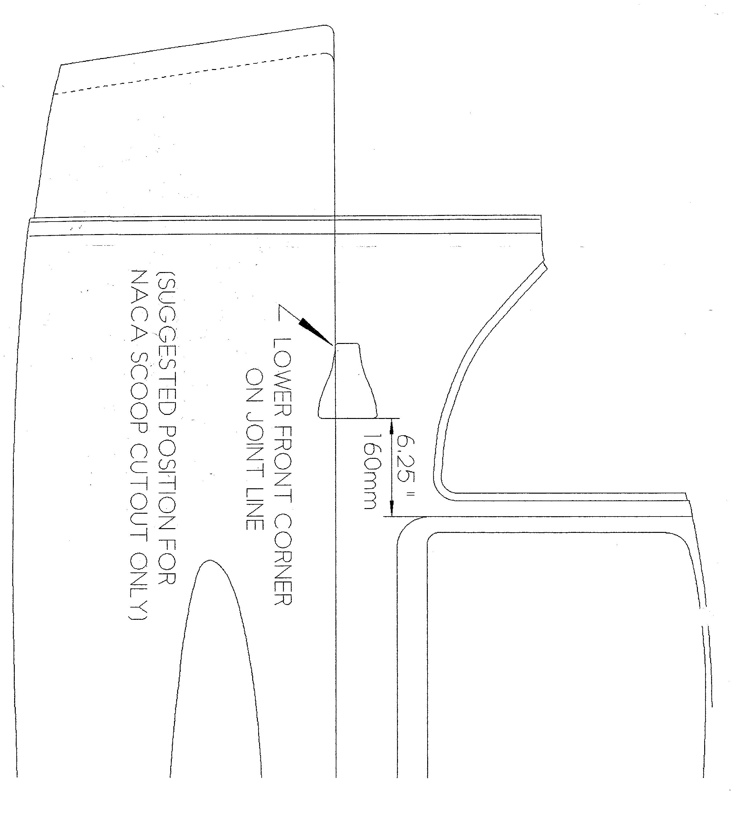

I can’t find any mention in any of my build manuals of the NACA scoop mouldings that came with my XS kit, or how and where to fit them.
I notice that other builders appear to have made their own choices of location - see the composite picture in my dropbox at:
https://www.dropbox.com/s/hkyd4ldm1x634id/scoop_locations.jpg?dl=0
I’d like to site my scoops in a way that makes it easy to fit eyeball vents on the inside; as the eyeball vents I’ve got have their own on-off control I don’t plan to use the adjustment feature supplied (one of which broke anyway within minutes of unwrapping it). I’d prefer to avoid the need to construct serpentine ductwork (as related recently in The Europa Flyer) and want to keep the eyeball vents clear of my knees. I imagine that lower locations are more likely to be high-pressure and higher locations less so or even low-pressure, but I wonder if there are any real no-go areas.
The fitting instructions packed with the scoops (made by Ayton & Co & supplied through Aircraft Spruce) show how to fit the scoops on the inside face of the aircraft skin, but as the flange is only about 2mm recessed from the outer surface of the scoops I think it will be necessary to cut back the inner skin to allow them to sit flush with the outer skin.
All input on this topic welcome!

There was a recommended position from Europa for the NACA vent but I can't
lay my hands on it at present. From memory it was along the split line of
the top and bottom of the 'canoe'. I thought it was in the Company Tech
talks but I have failed to find it.
Hope this gives a pointer.

NACA positioning instructions attached, David Joyce, GXSDJ

David - much obliged. Wonder why that wasn’t included in my manual.

Rowland, I believe it came on a separate piece of paper with the inlets. David

Well done David - that's what I was looking for.
