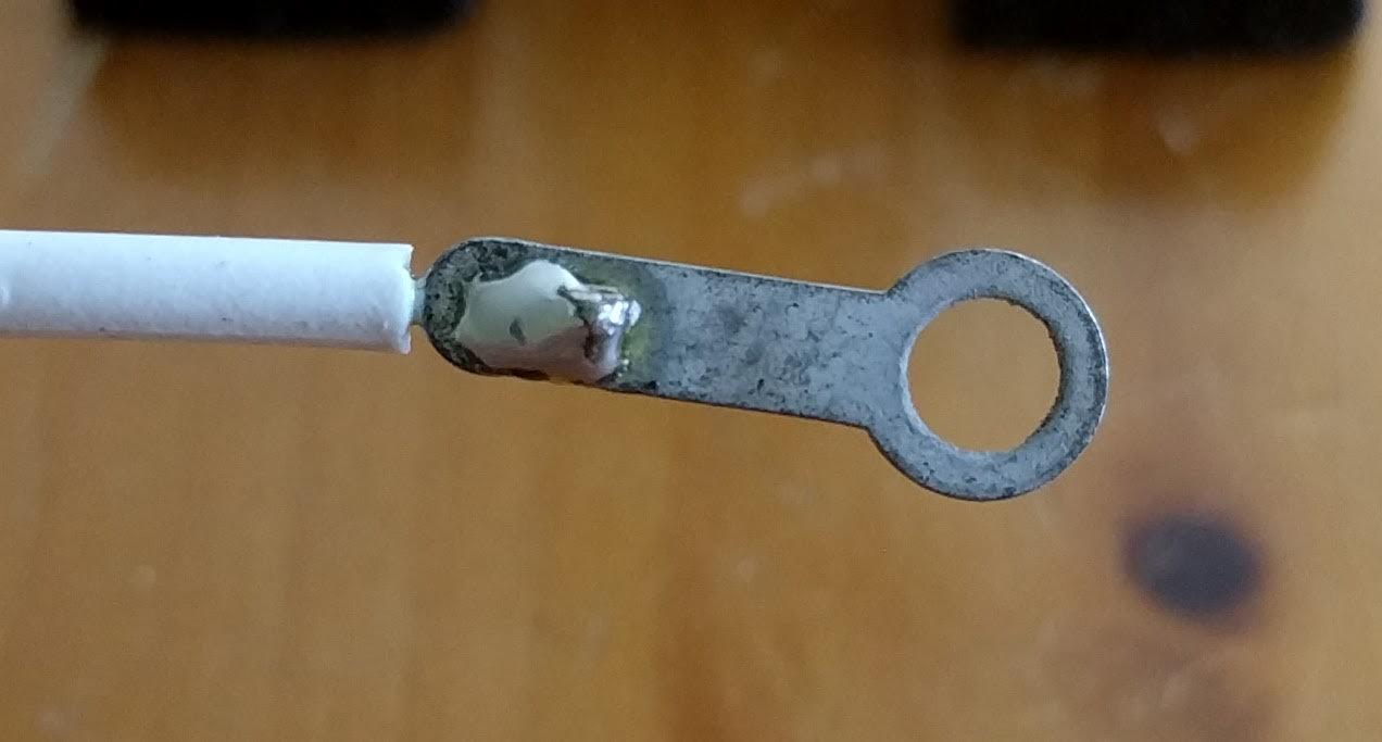

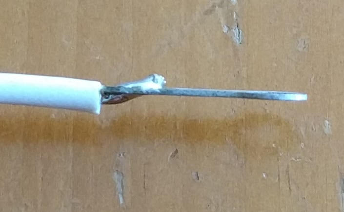

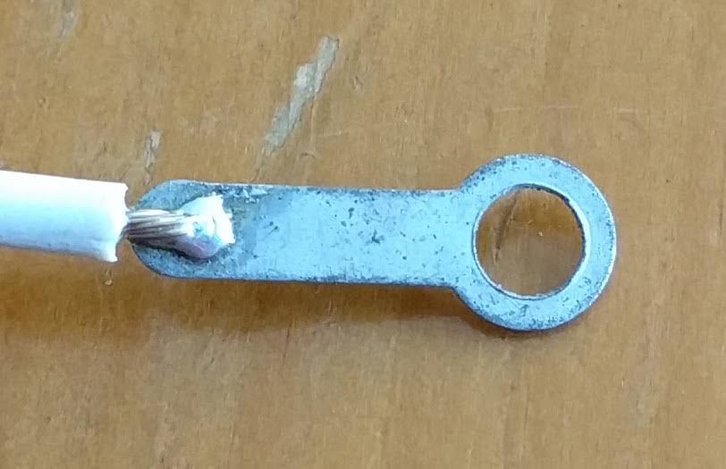

I found some old dogbone connectors in the basement and have been doing some practicing. Googling didn't turn up any examples of a well soldered joint so please give me some feedback. (I did find a YouTube video of someone teaching soldering... he had a roll of electrical tape!) The wire is 20 AWG in this sample:
[img]cid:ii_inezoyo40_15449d2b2cf72449[/img]
[img]cid:ii_inezoyot1_15449d2b2cf72449[/img]
[img]cid:ii_inezoypa2_15449d2b2cf72449[/img]
Is that how it should look?

That joint is probably quite adequate. There
are some signs of 'beading' for the molten
solder at the interface with the terminal . . .
an effect of terminals exposed to the air
and moisture for some time . . . solder
has difficulty getting an aggressive wetting.
The really BIG difference in solders has more
to do with flux than the alloy. There are
really 'active' fluxes that would produce
a more wetted joint but I wouldn't be afraid
of what you've produced.
One thing you might 'practice' with is a technique
I call "flushing" the joint. Put some heat to the
terminal as if you were going to 'tin' the
end . . . but push some solder into the melt
until it drips, then wipe it off with rag before
it cools. Some solders I have are very active
flux and the excess melt+flux goes a long
way to preparing the base metal to accept
the soldered wire. You wind up using perhaps
2x to 3x of solder necessary to complete
the joint but the act of flushing with some
excess melt + flux can be useful to the
finished joint on 'stale' surfaces.
That's something you can play with but what
you've shown us is certainly adequate.

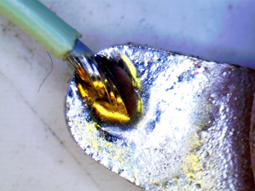

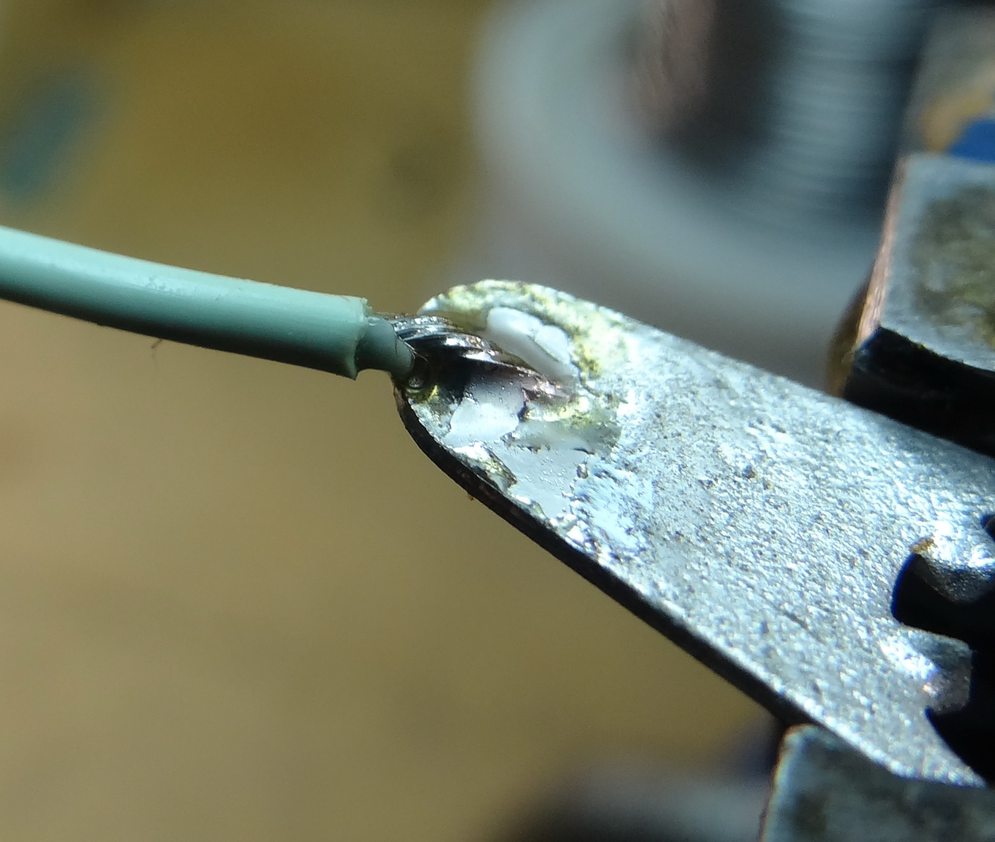

You're looking for something more like this:
[img]cid:.0[/img]

At first glance, that pic shows a poor solder joint.
The wire is captured correctly but, the joint to the terminal is poor. The solder should pool out in a graceful way and appear very attached. Sometimes best to lightly sand the terminal metal first so solder can attach to base metal.

Oops. . . I probably spoke out of turn.
I did not see the 2nd image where the wire passes thru and is soldered on both sides. That joint maybe Ok. . The only flaw is that I cannot see the smooth fan-out of the solder edges. It looks like the solder is fighting against some sort of plating on the terminal. On a joint like that, I would probably try to flow some solder on the terminal first. Just enough to get a wet look but, not enough to block the wire hole. If that flows normally, then attach the wire and flow additional material to bind it all in one unit.
