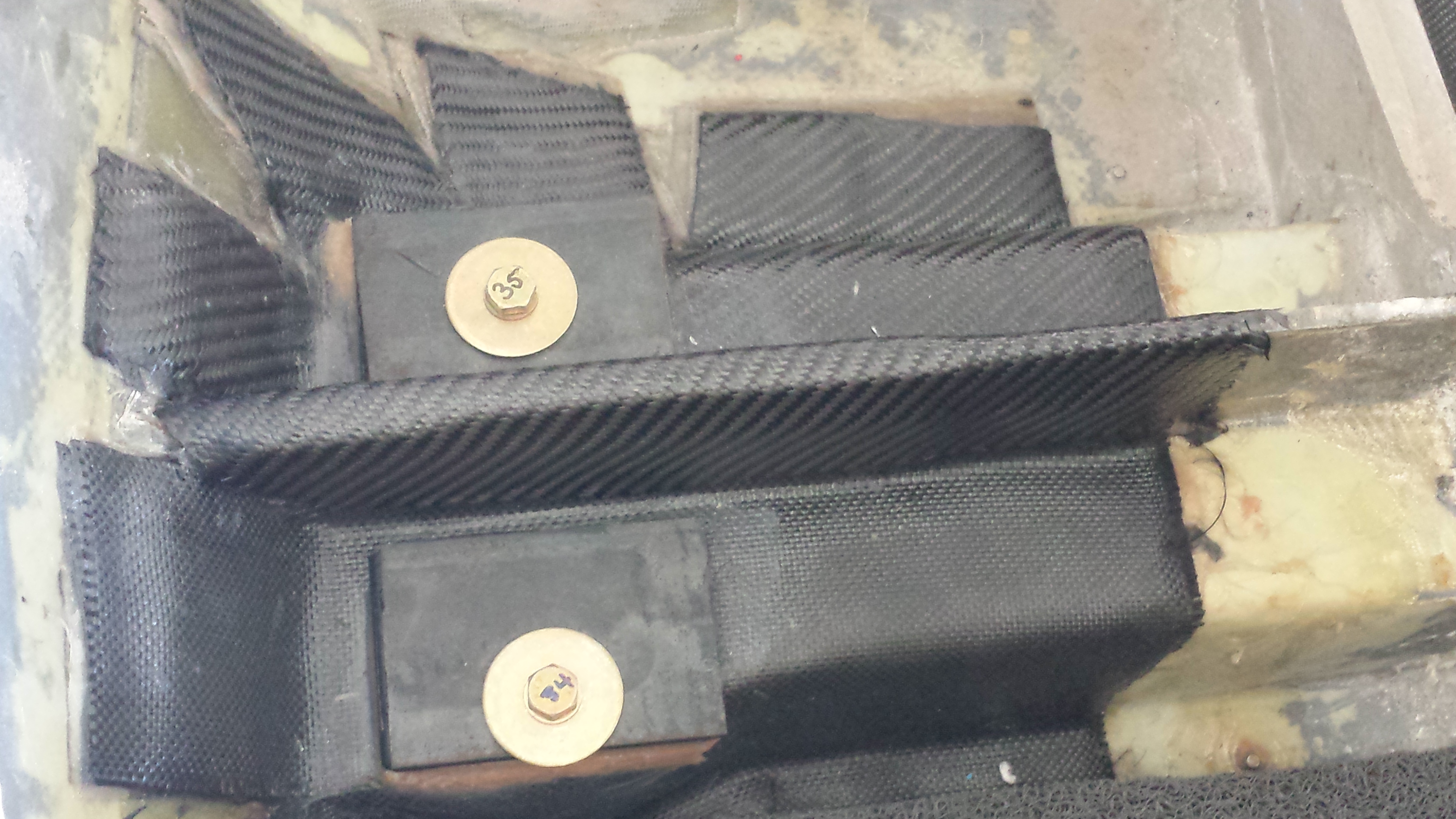

Mark K, Mark T;
Here is a photo of how the main landing gear attach point repair turned out as you asked for during Sun-N-Fun. This is the Co-Pilot side of the airplane. The repairs are 20ply of 9oz Fiberglass, 2ply 9oz Carbon Fiber, a 3/16" steel plate with a "hard rubber" mat between the plate and the Carbon Fiber. The steel plate extends about 1-1/2" past the old damaged area on each side. The area between the front and rear attach points have a 2ply Carbon Fiber "cap" but this was just for looks. The bolts are now AN7-34 for the front and AN7-35 for the rear instead of the old AN6 bolts.
Overall I think the repair came out very nice and should be more than strong enough.
