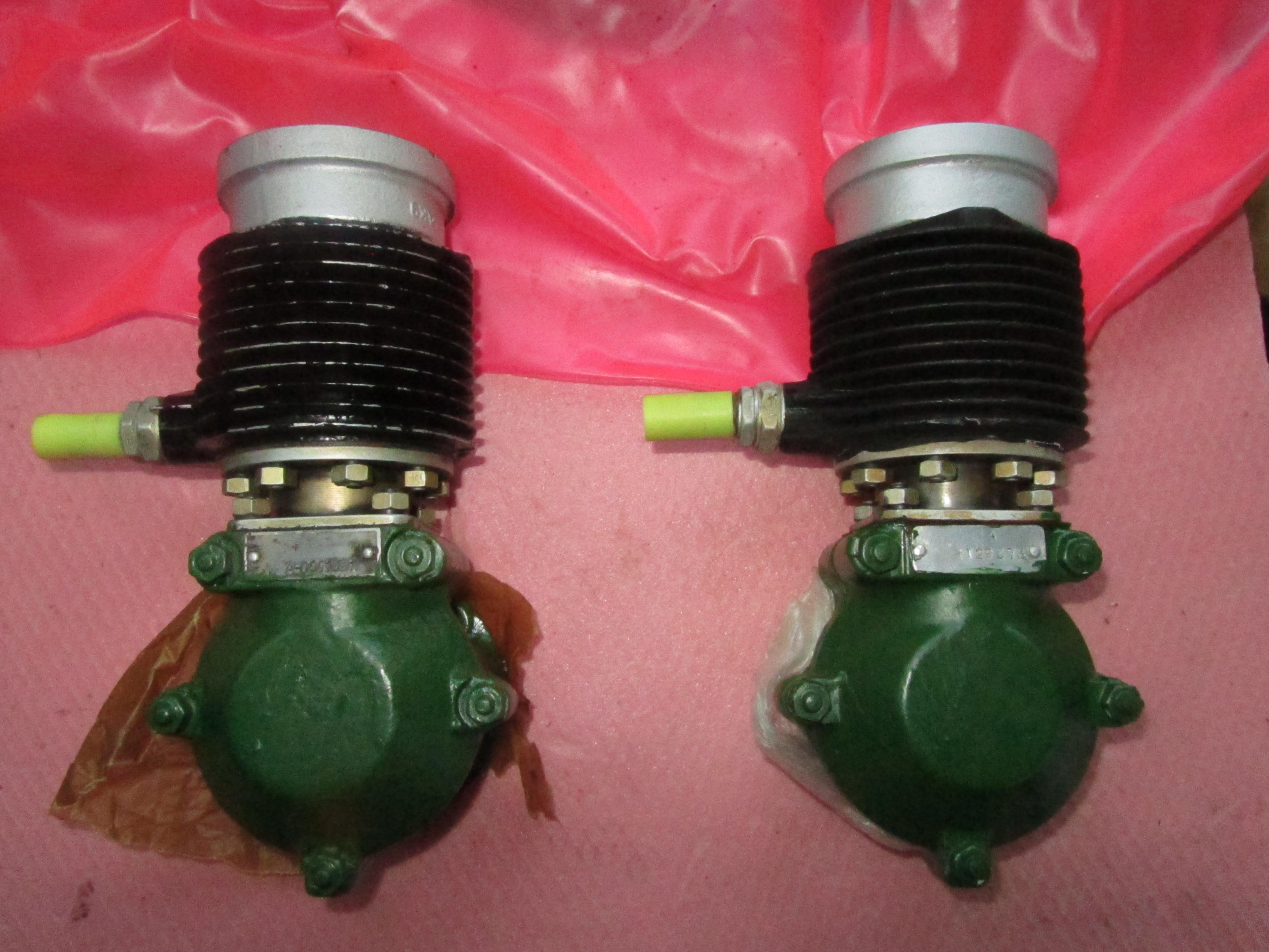

Forget these guys.

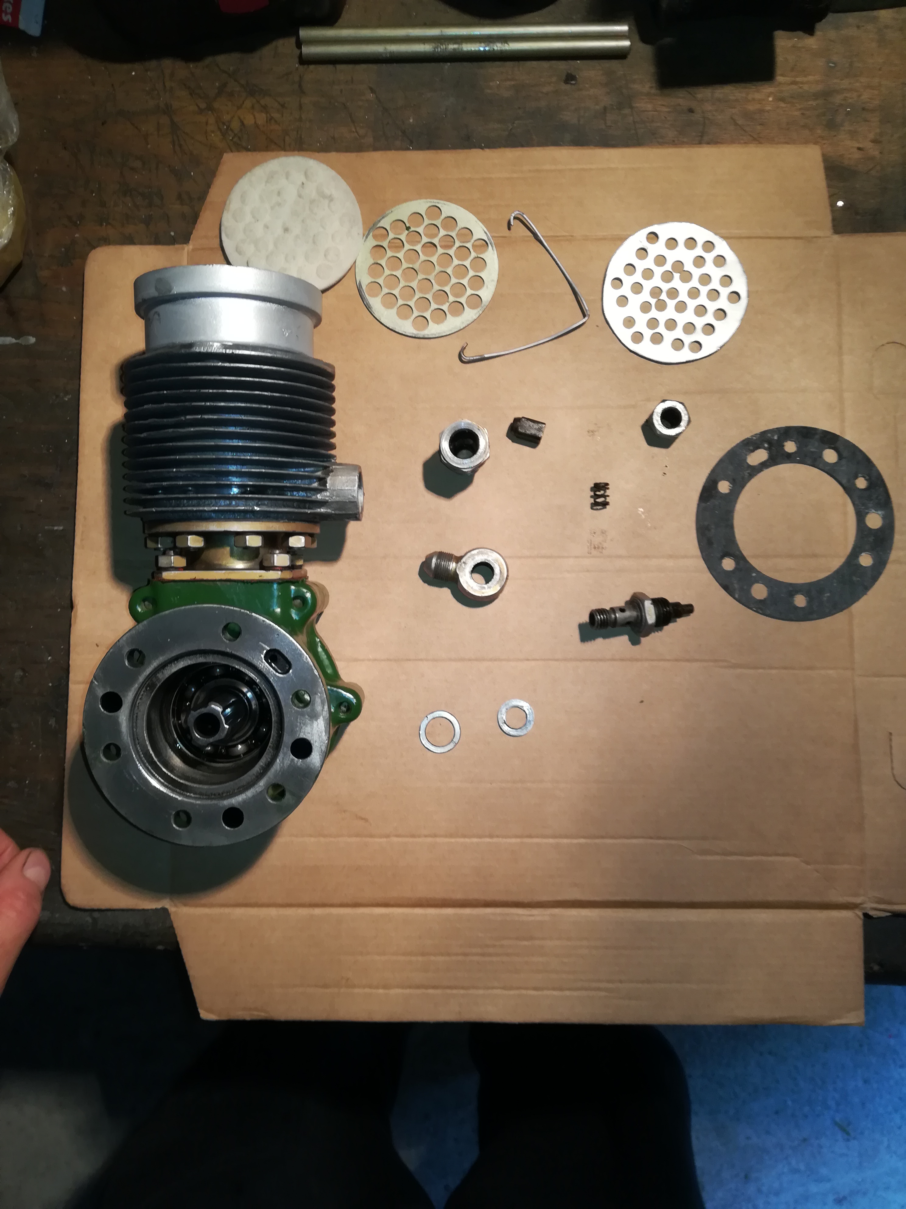

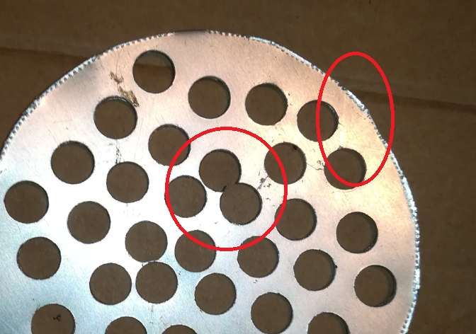

Just bought an AK50 air compressor and the first one was just repainted, a new air filter and nothing done inside.
Even the air filter support was done, I am sure by a kid. Just look pictures.
It is a shame how they want to crock you.
The second one was exactly the same shit.
These air compressors were on advert since years and when I asked a refund, they told me that they just received from a military overhaul facility and that they had to paid them with my money.
Not only crock but liars.
Look he pictures and judge by yourself!

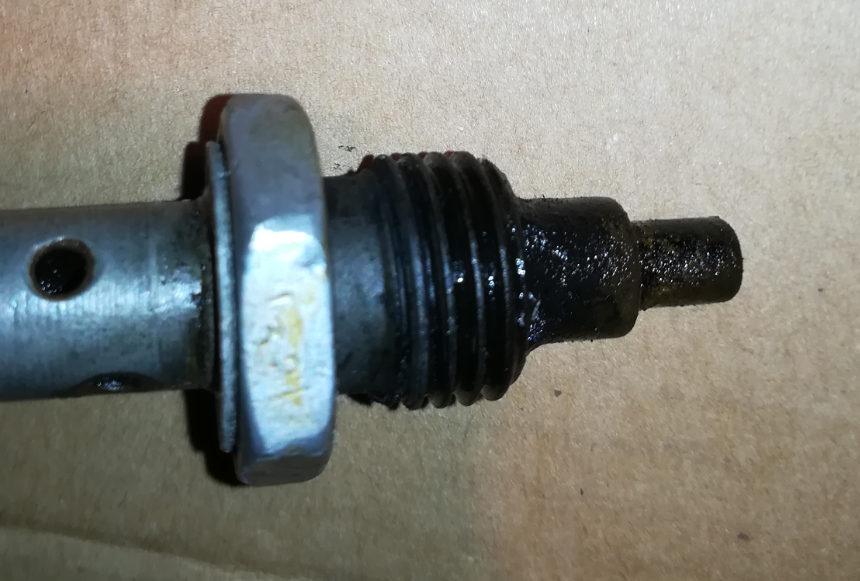

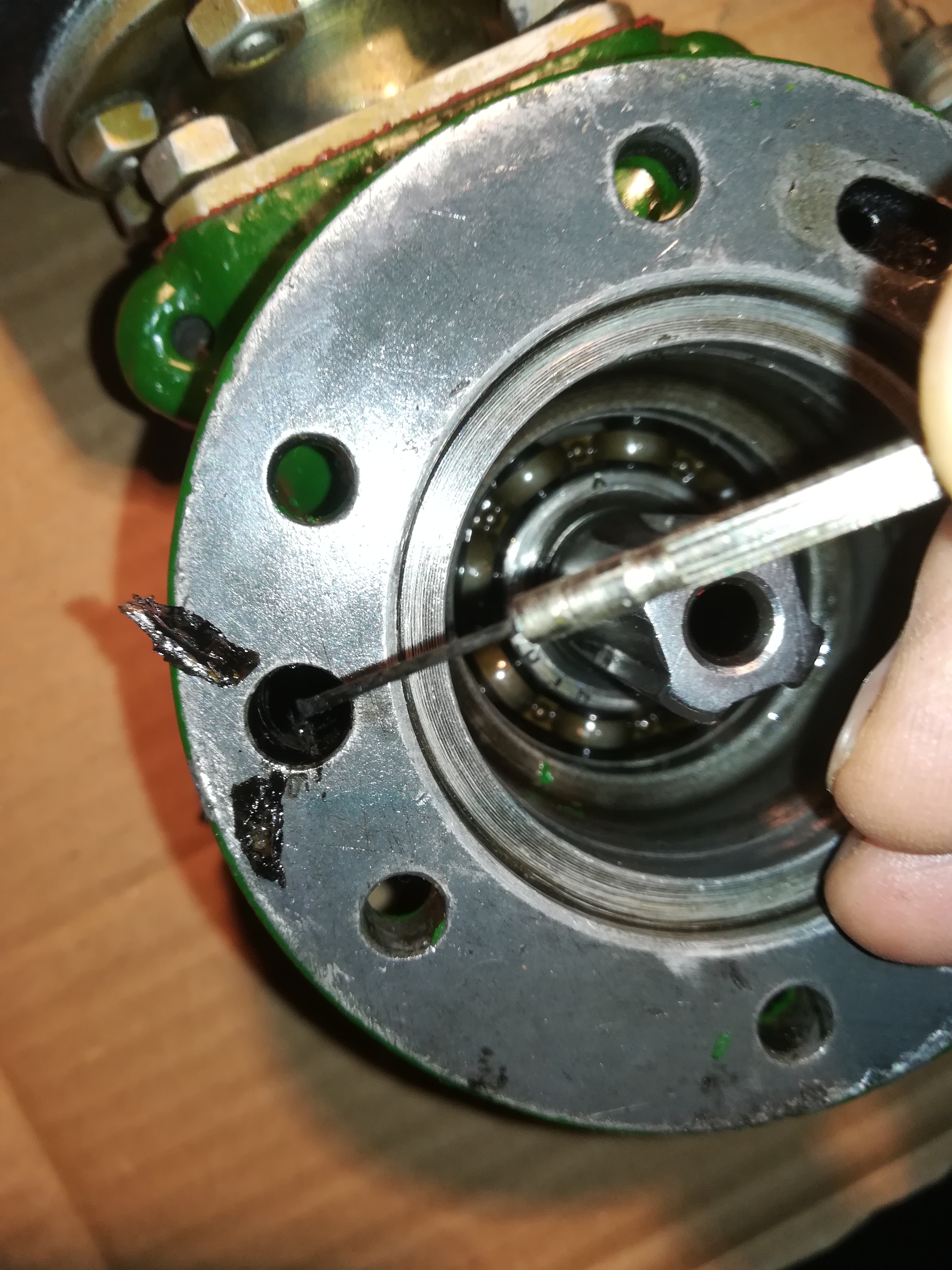

jacques
Joined: 06 May 2009
Posts: 36
Location: Pessac, France
PostPosted: Mon Nov 04, 2019 11:17 am    Post subject: Re: Reputation Check on Plamen Petkov Reply with quote

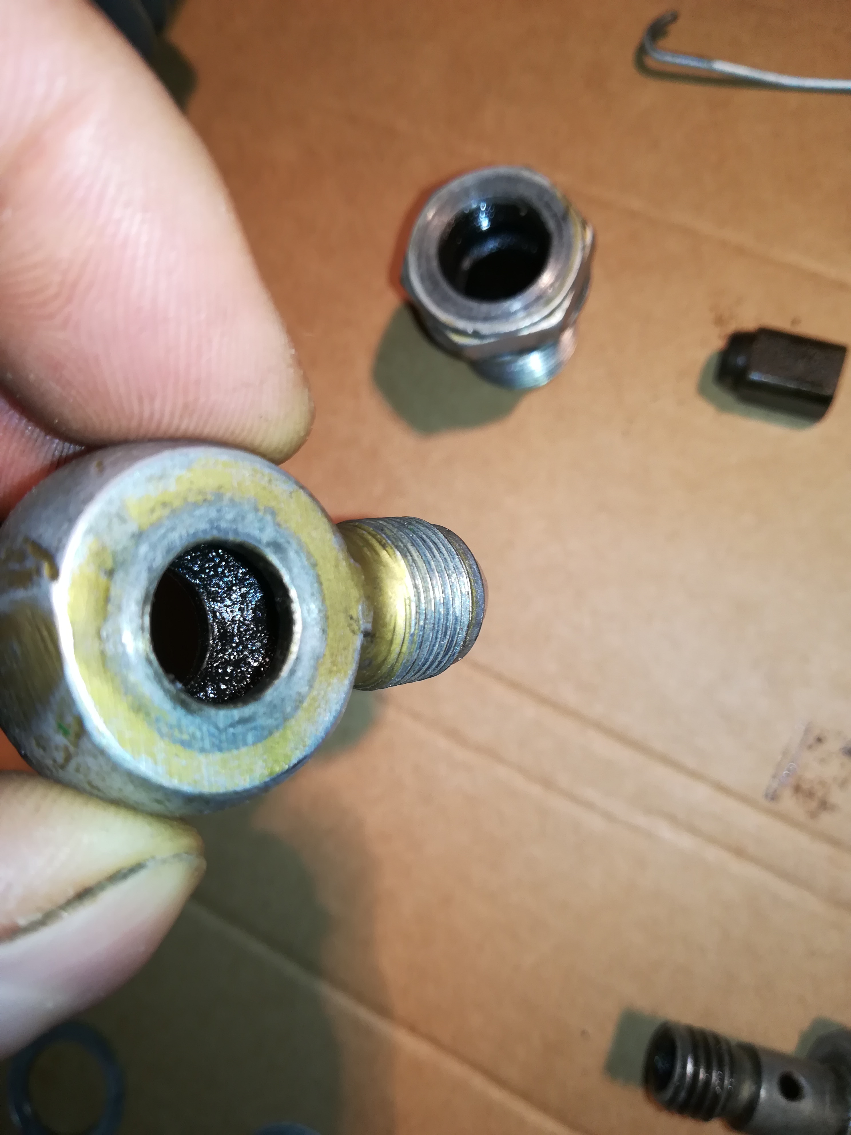

More
 Filesize:  2.92 MB
 Viewed:  17610 Time(s)
 Filesize:  1.86 MB
 Filesize:  2.14 MB

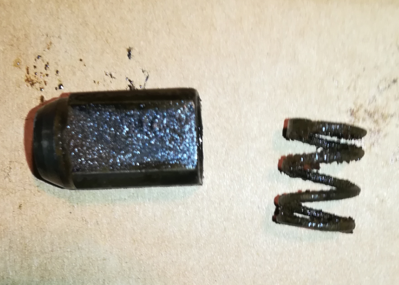

 Filesize:  973.05 KB
 Filesize:  955.73 KB

Just to remind :
Ordered 1 air compressor overhauled, received an old one just repainted. I asked a refund and they refused, they send another one, exactly same shit.
Returned both and I asked refund. they said they cannot refund because they paid the military overhaul...They refused to take both compressor when they were delivered by post.

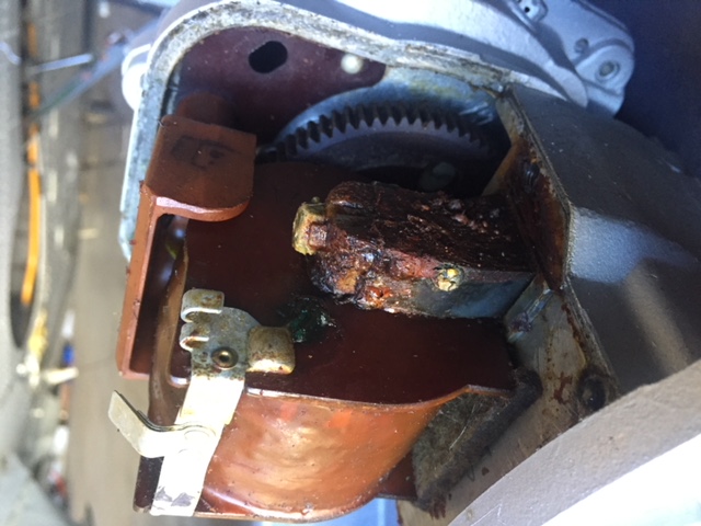

I ordered 2 magnetos from Plamen Petkov (avioserviceblg) them. They were painted fresh silver on the outside, but completely rusted and corroded once you pull the caps. Completely junk. They offered to send new "pencils, coil and insulator", but by the time I pay someone to rebuild them... it really didn't seem worth the trouble. He said his mechanic checked that they had spark, but did not remove the caps.
 Filesize:  122.35 KB
 Viewed:  16980 Time(s)
 Filesize:  105.58 KB

Like always : new paint on shit and they always have an answer! Magneto's have a spark....
For my compressor : pressure is tested and compressor were overhauled by military, so we can not refund...
I have returned both air compressor and they have refused to take them 8 times from the postman!
Now they are again at home. So I have two air compressors, the one you can see on pictures, with rust, old oil, worn cylinders, piston and rings but they have a court case on their side...
Stay away these crocks.
