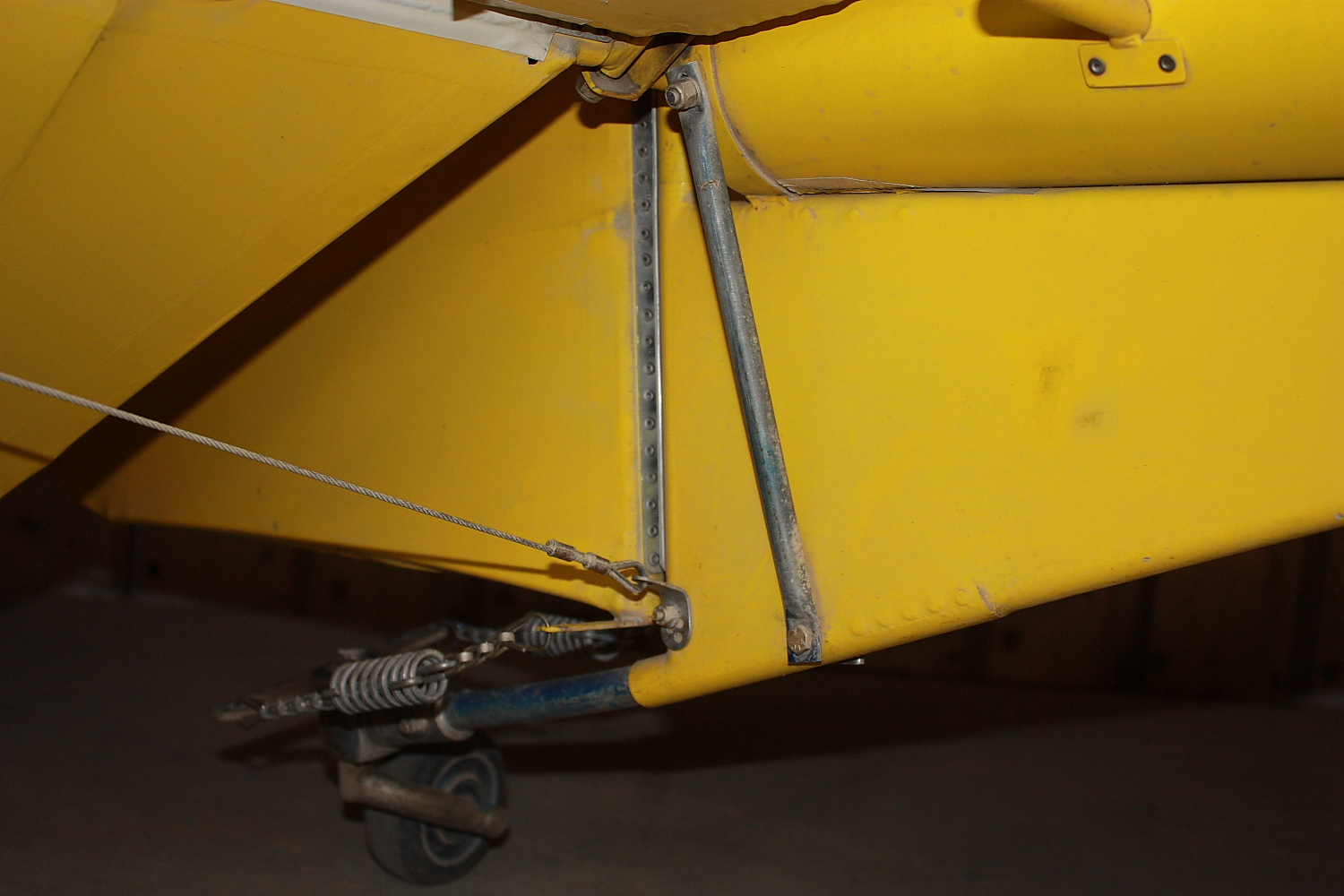

I am working on my tail wheel tube, replacing with the solid aluminum over the existing fiberglass one. Would anyone have a photo of the solid aluminum installation that they would be willing to share? I would like to see where the securing bolts are placed.
thanks in advance.
Mark

Since mine is close I am sending you a picture of the way that mine is done. Mine had a alum tail wheel rod that came with it, so I only braced it to reduce the stress on the rudder post as suggested by John H. If you have not already done so, I would suggest that you brace it on each side when you replace the rod.Larry
