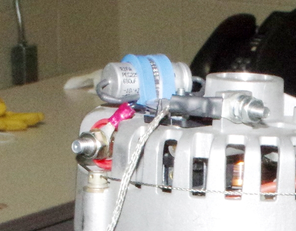

  That IS the legacy rationale for adding such things
  and it's a deeply rooted idea did
  a failure analysis on a modern, 100A alternator
  that came equipped from the factory with a 680uF
  electrolytic capacitor mounted right to the back
  of the alternator.
[img]cid:7.1.0.9.0.20160327122948.0099ede8(at)aeroelectric.com.0[/img]
  I am quite certain that noise from this alternator on
  EMC laboratory equipment would not be materially
  reduced for having added the capacitor. I'd
  LOVE to see an EMC test report that illuminates
  the 'benefit'.

Is that the actual size of the capacitor for that application?
Rich Ulmen

Rich, this is what was recommended by the avionics shop
