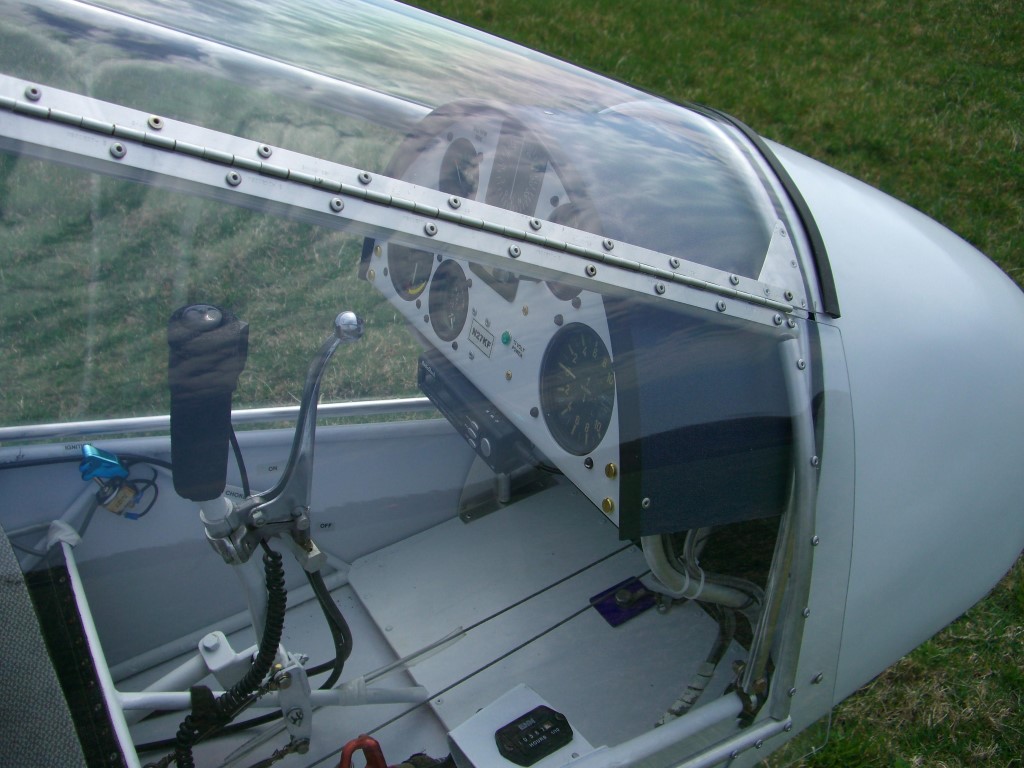

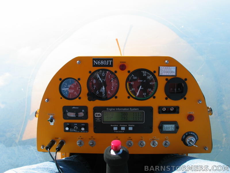

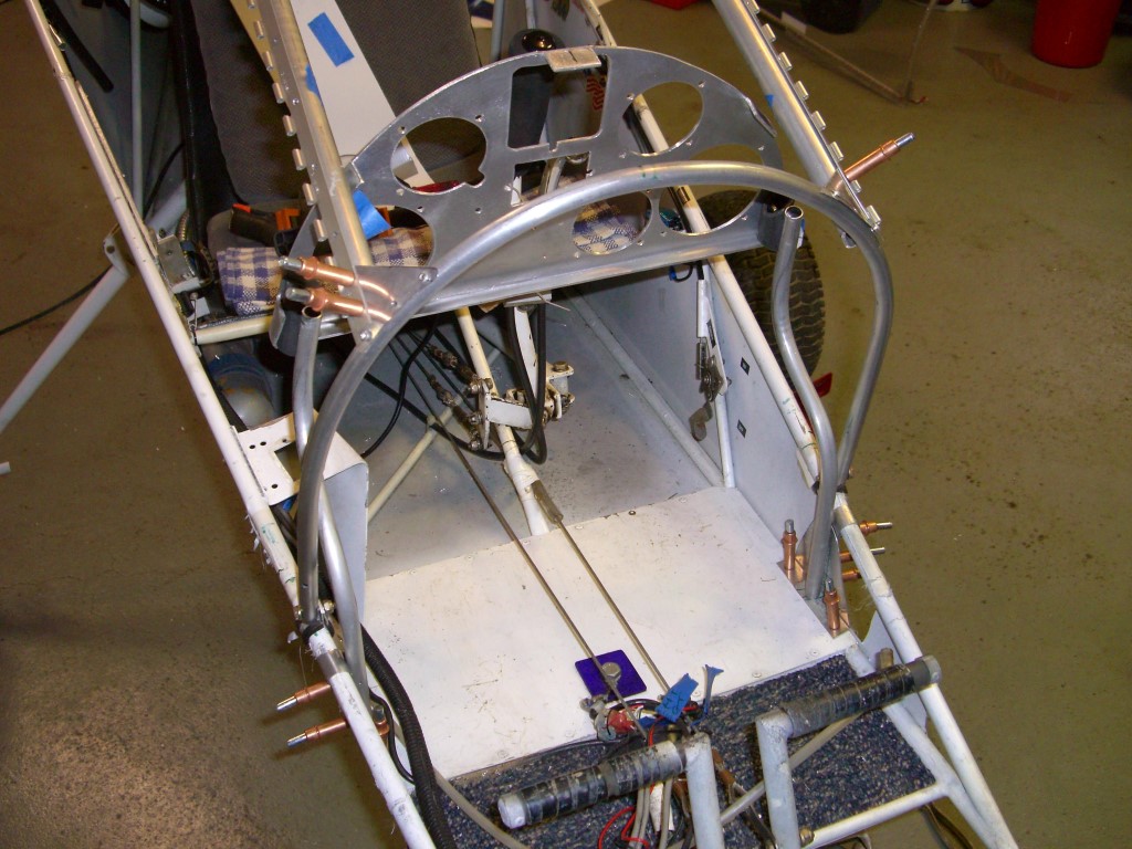

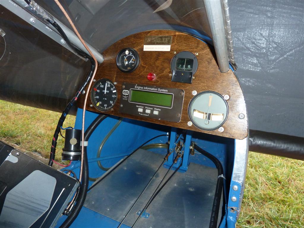

I would like to extend my fs2 Inst. panel I have seen a few have done it and was hoping to get a little guidance and or pictures of the process. I was thinking to hinge it for better access.
How far to extend
What materials how to fabricate it
How to hinge and how to secure to existing panel?
I found these pics on barnstormers and really like the layout.
Thanks for any help
Mike

Being one who must remain conscious of leg room, I would be careful how deep you make your extension and/or the top to bottom measurement. Too much in either of these dimensions will cut down that leg room. Looking at the inside shot of the pictures you posted, there's not much room between the pilot's shins and the bottom edge of the extension.
As Beauford would say.... "Worth what you paid fer it.."

PostPosted: Sun Mar 06, 2016 10:05 pm    Post subject: Extending instrument panel Reply with quote
I am not sure how big you are, but let me tell you how I get into my plane. I am 6 feet- 235 lbs. I sit backwards on my seat, lift my left leg over the stick, and down onto the rudder pedals. I of course reverse this process to get out of the plane. My plane has longer gear legs, so I had to change the method of entering the cockpit. With the smaller gear legs, One can lift up the wind screen- stick the left leg in, then put your butt on the seat. Much like what you do to get into a sports car. These are only ways to get in that I have found. Smaller younger pilots will be able to do things that I probably cannot.
The only thing on my cockpit that I need to do anything with is adjust the altimeter. I do that on the ground. The rest of the controls that I need- tank selection- fuel pump, strobe, ignition switch are all located in various spots that are within reach.
Primarily what I am saying is that you can position every thing that you need in spots that allow you to reach them while seated and flying. It just takes some thinking on your part. However you are the one that will be flying it, your choice, but give it some serious thought. I have a small center console in front of the stick that holds my radio, all my switches- plug ins for the intercom. HAC man system on the left side by the throttle, fuel selector switches on the gusset to the left of my seat. Take a poll and see how many have moved their console out.
Larry

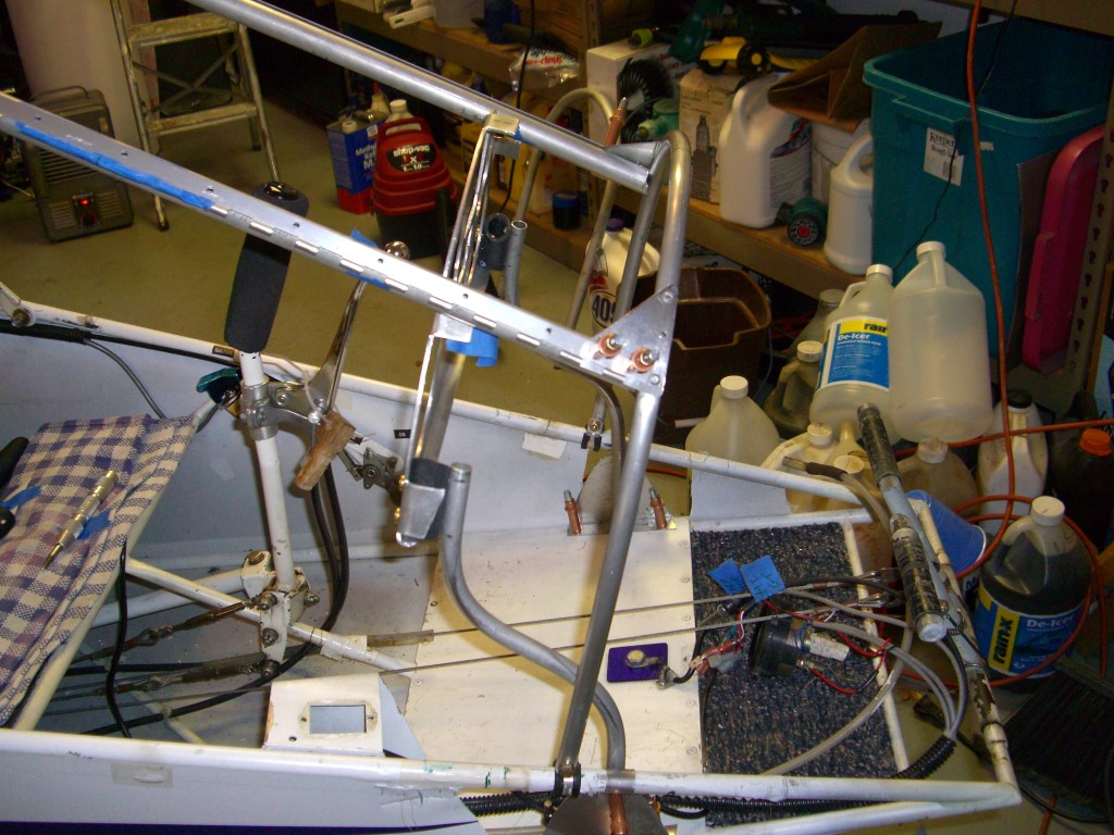

PostPosted: Mon Mar 07, 2016 4:29 am    Post subject: Re: Extending instrument panel Reply with quote

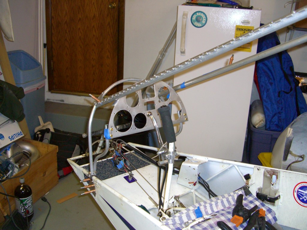

This is how I did it. The panel is attached to a rubber hose at the bottom. The top rests against the nose cone. This allows the nose cone off by itself. Not attached to the panel at all. Yes you lose a little shin room. Just be sure to account for that. I rounded off the panel at the bottom so I didn't cut my legs off in a crash.
Two things I would do differently next time around. The compass needs to be vertical. The panel should be painted black.

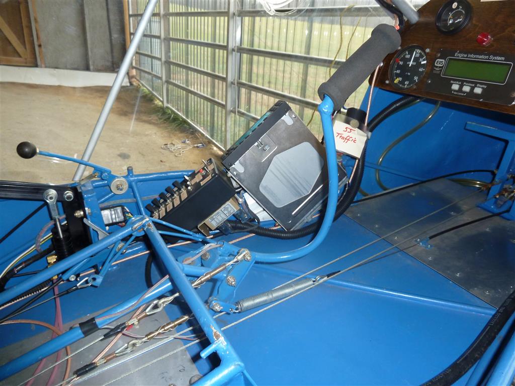

I agree with what Larry says here. (Even if Scott Olendorf's panel setup is extremely cool)
It is really easy to make the panel on the FSII slide out a bit; notice that the wood has holes drilled in it and the windscreen tubes fit through it. You remove one screw on either side and the panel will slide up the tubes about 8 inches, plenty of room to get access to the back side.
Radio Shack is out of business, but the little black box with all the switches on it has lots of room for all your wiring needs. Probably other electronics shops sell similar boxes.

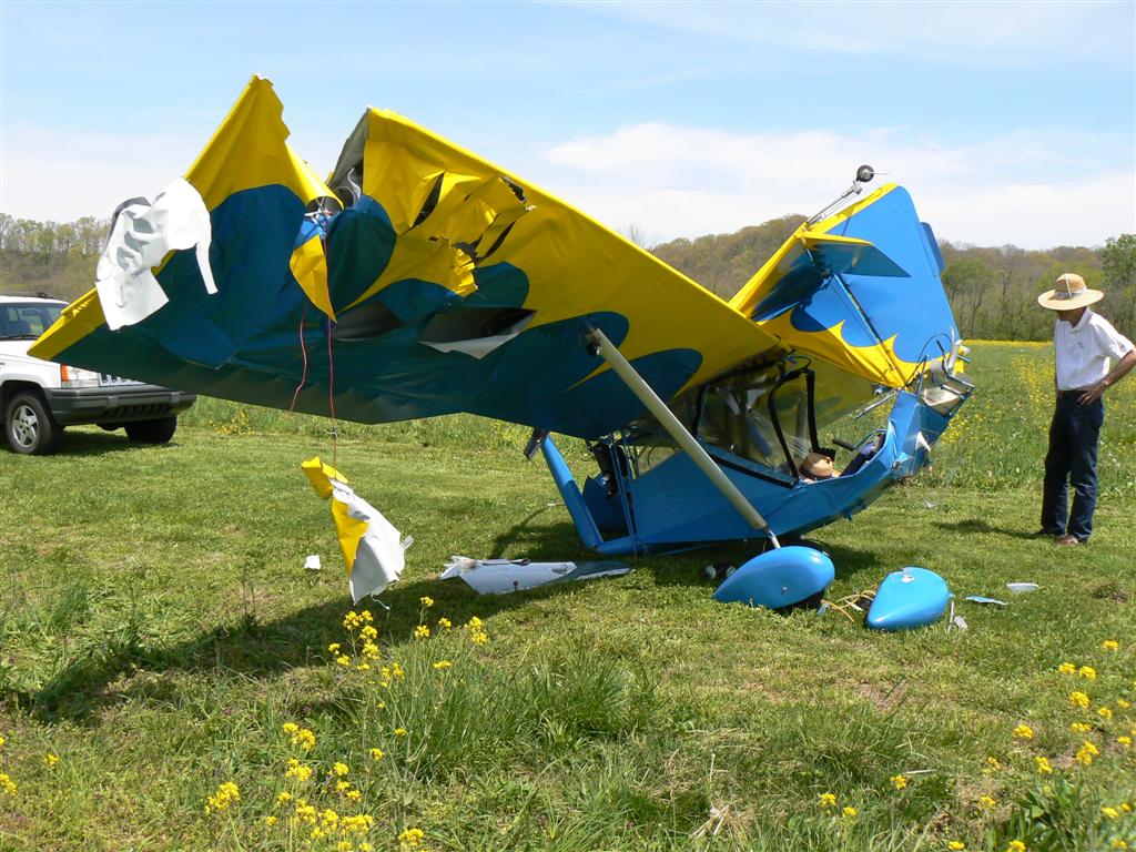

One more thought: if you do extend the panel back toward your shins, make sure it is not rigidly attached to anything.

Richard- Ouch! that looks like it hurt! a lot.... it hurts just to see.
Larry
