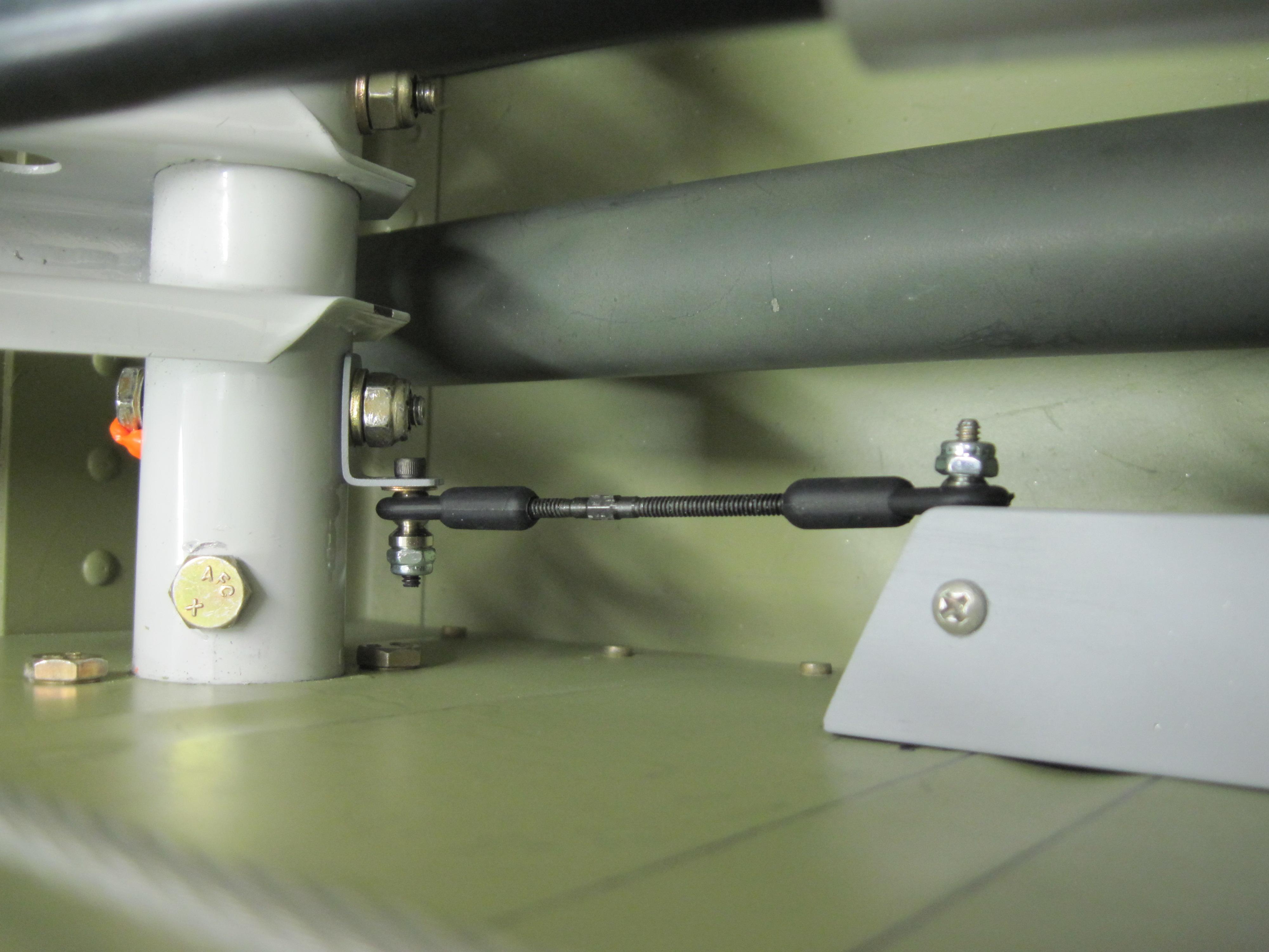

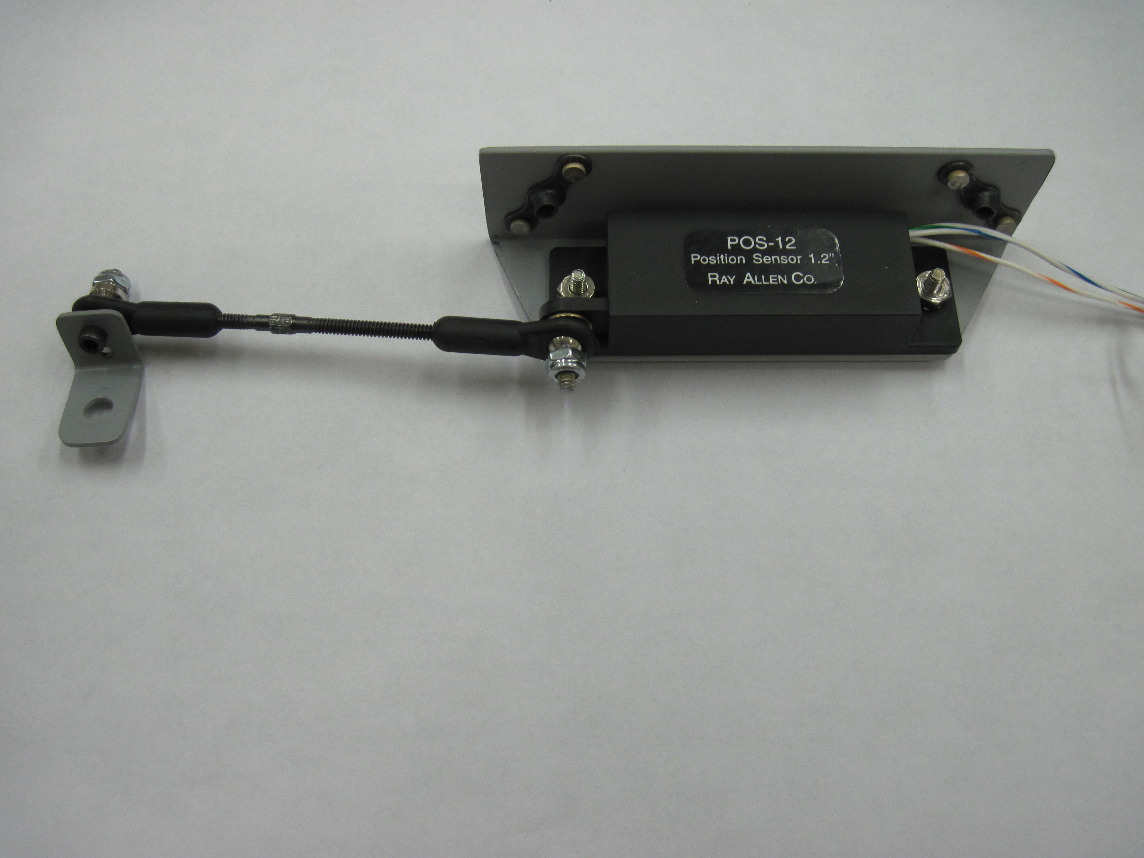

Phil
I understand your frustration. If you wish, I'll certainly take your project off your hands at no charge to you!.
Failing that, what I did was mount the POS12 on the foot-well wall using a small length of hinge. I then, as others have, installed an adel clamp to the flap with a tube. The adel clamp had a small L shaped bracket that attached to the POS-12 arm. Very simple and quite similar if not identical to what others did.
The trick was to get the hinge / pos 12 on a place on the foot-well where the full range of the flap movement wouldn't over / under extend the POS-12 arm. This I did by trial and errior. When I had it exactly where I wanted, I used pop rivets to attach the hinge. I used aluminium tape to hole the hinge pin end in place so I could remove easily at a later date if required.
Here are a couple of trial that may help visualize things.

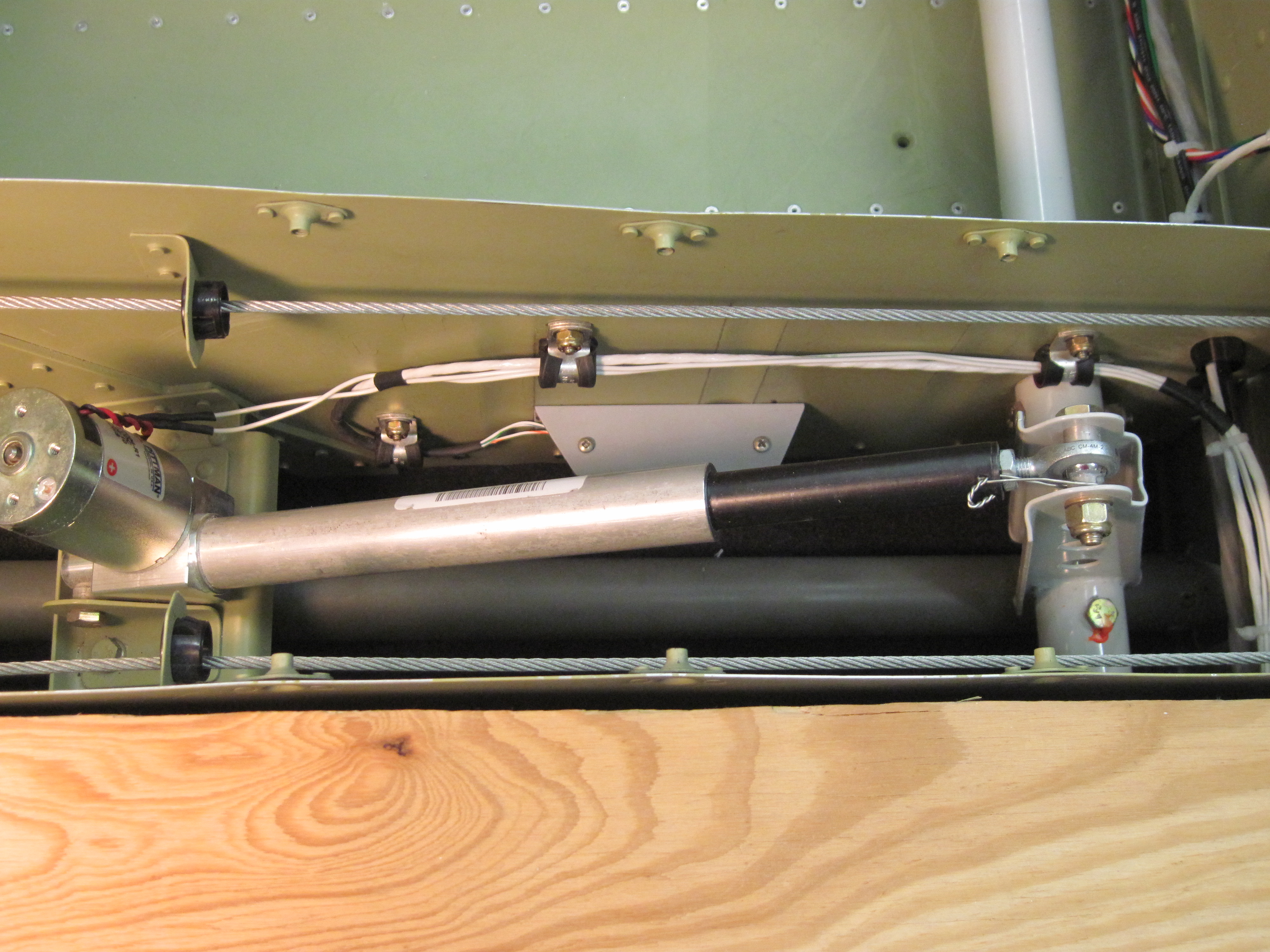

PostPosted: Wed Mar 02, 2016 6:32 am    Post subject: Re: Those @&$#^ flap position sensors! Reply with quote
Here is how I did it. Remember, you do not need full travel of the sensor, so keep the radius as small as possible. 50% travel will do just as well as full travel. The rods can be purchased at any RC hobby shop.
 Filesize:  2.1 MB
 Viewed:  11678 Time(s)
Bill

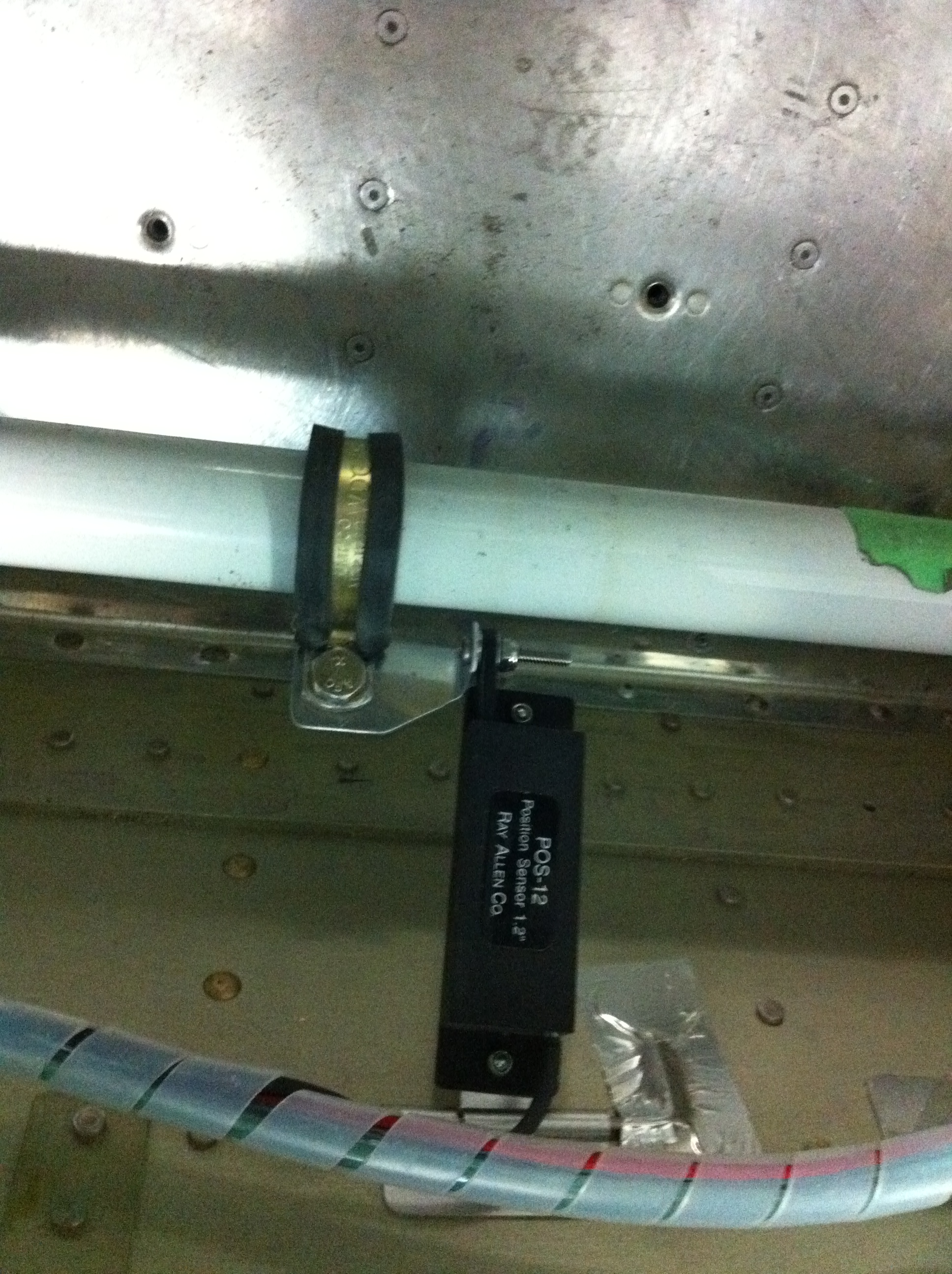

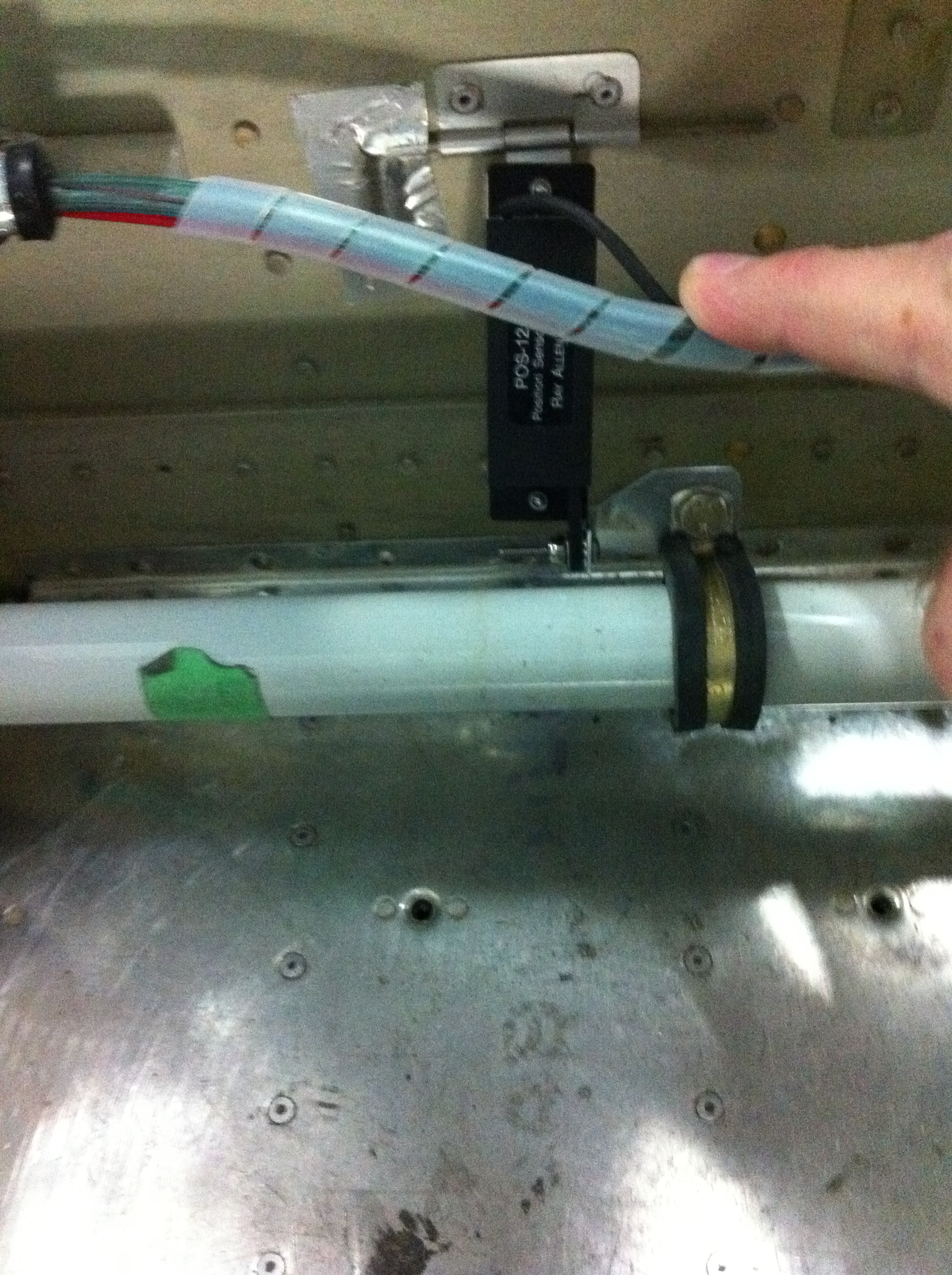

PostPosted: Wed Mar 02, 2016 6:35 am    Post subject: Re: Those @&$#^ flap position sensors! Reply with quote
More Photos
 Filesize:  1.91 MB
 Viewed:  11673 Time(s)
 Filesize:  2.7 MB
Bill

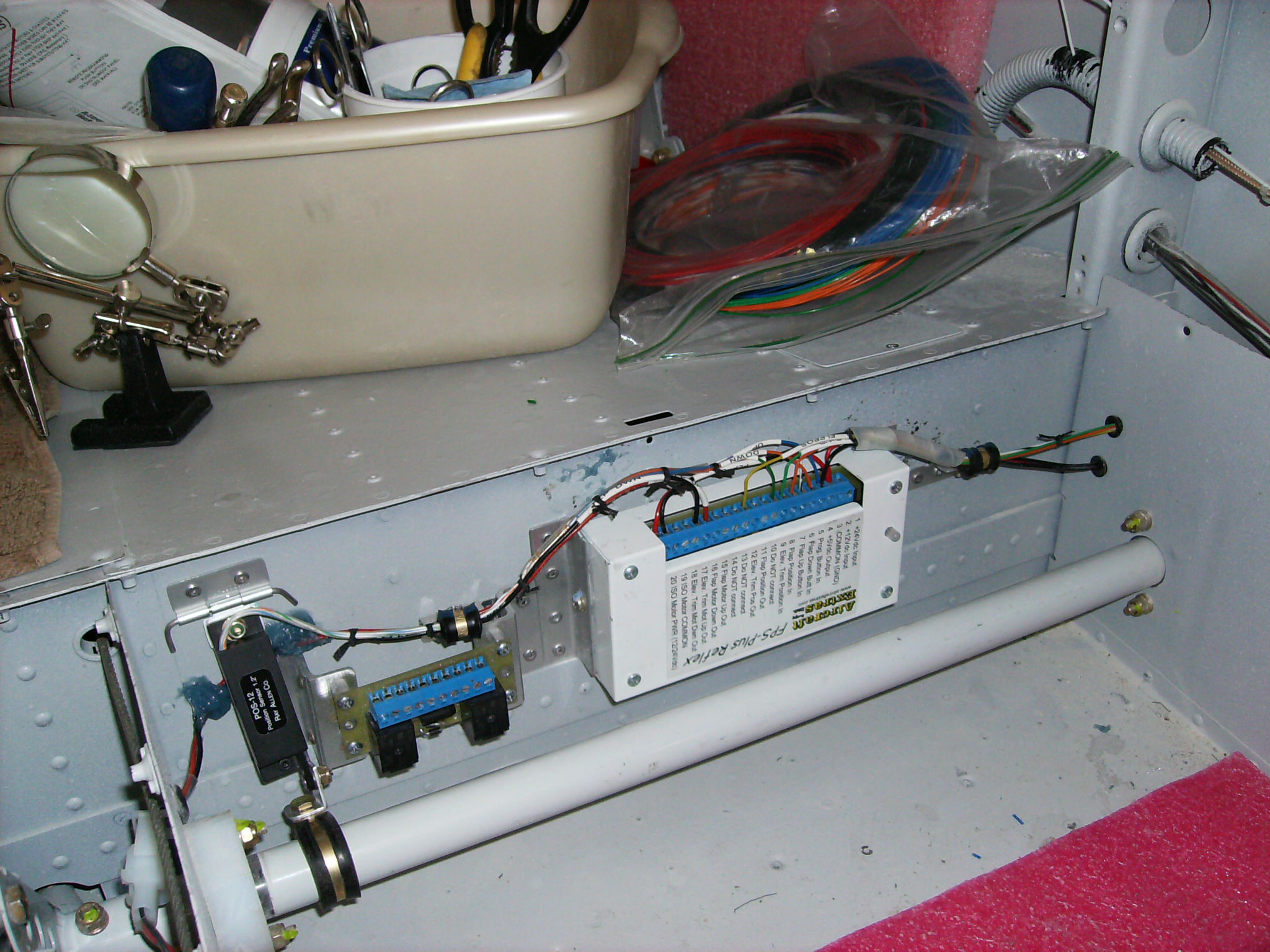

PostPosted: Fri Mar 04, 2016 7:42 am    Post subject: Re: Those @&$#^ flap position sensors! Reply with quote
Here's what I did... Really simple and flying without issue for several years.
Jay
N433RV
