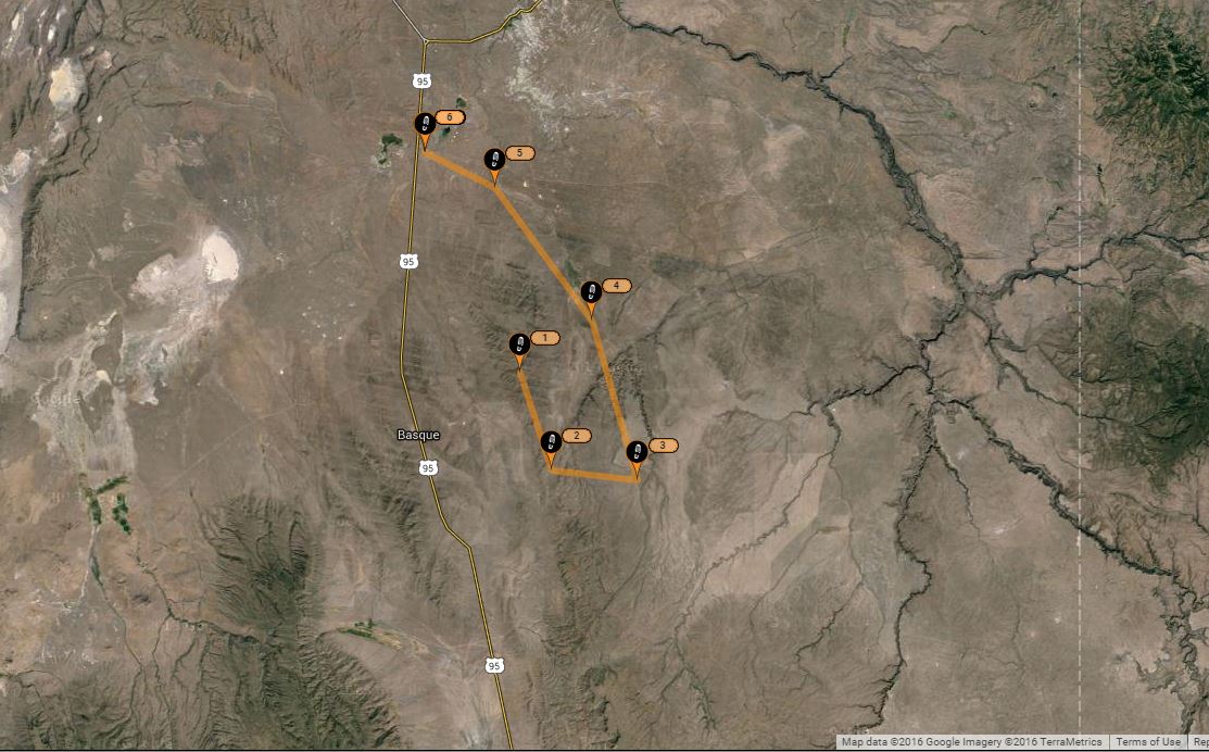

Yesterday I inadvertently posted that I was going to check for some Elk, so today I did so. None were to be found! I took some video anyway, and figured I would share. From the looks of things you are not having very nice weather in the East, but it was nice here today. A bit cool 42 degrees when I took off.
https://vimeo.com/156633142  password owyheeflyer

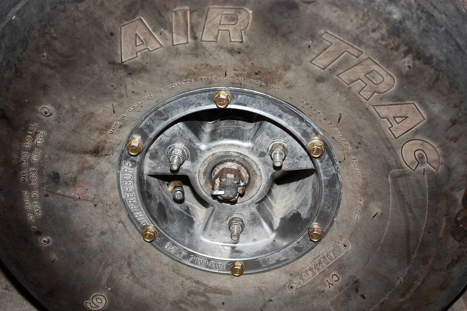

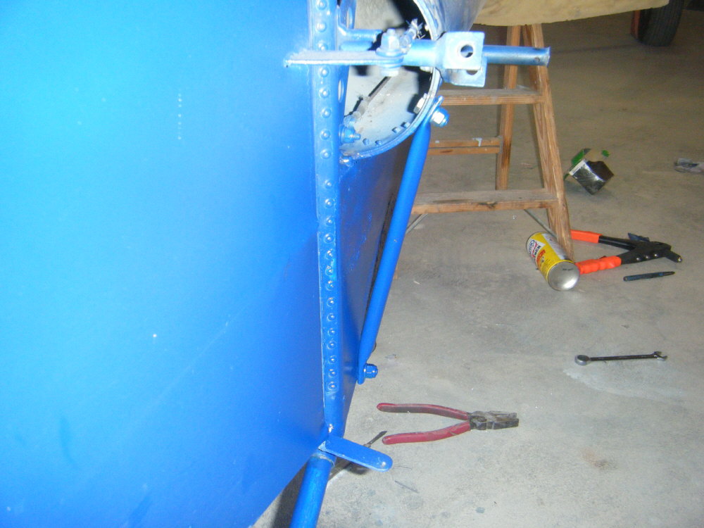

One of the tire companies is now making "tundra tires" that will fit on the 6 inch rims that most are using. There was a recent (last 6 months) I think from Nick Cassara about them. Fairly spendy however. I have 800 x 6 on my firestar with the tires secured by screws so that I can run 6 lbs of air. Other wise the tires spin when you land and shear off the valve stems. I personally prefer individual brakes, and a breakaway tail wheel. You will also need to brace the tail post, so that it can withstand the pressures put on it by the individual braking.
 I have 6 inch mech brakes, and it seems to be able to do the job for me. I got on them a bit hard last year and it caused the plane to do little jumps as it was bouncing the plane back up in the air. So I know that I get all the braking that I need. I would prefer ?possibly? the hydrallic ones but that requires buying two entire systems to have individual.

Larry how do you put screws into the tires without puncturing the inner tube, or generating cracks in the rim? If I'm seeing your photo right, are you flying your FS up there in NV someplace? Where are you based?

Tell me about bracing the tailpost... braced in which direction, and braced to what?

http://www.jegs.com/p/JEGS-Performance-Products/JEGS-Wheel-Rim-to-Tire-Screw-Kit/756883/10002/-1  It was pointed out to me that you could get the screws cheaper than what I spent on these. YOu just need to have the right size drill bit because you want to cut some threads into the rim. I don't think you are going to have any problem with Alum rims cracking.
The rim is aluminum, and the bead of the tire is big enough that the screws don't touch the tube. I did however use a washer between the screws and the rim to make sure. Almost all of the tundra tires are secured to the rim with screws.

 One of the tire
