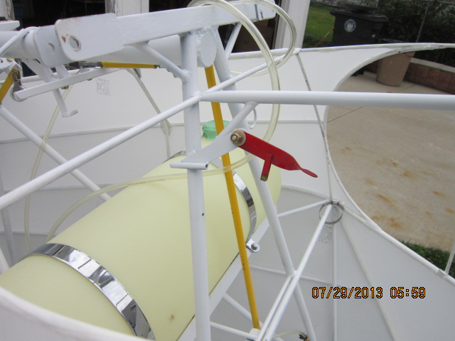

I was able to come across a used dune buggy fuel tank, but the owner put me onto this site for his original purchase.
http://www.pacificcustoms.com/round_poly_fuel_tanks.html
Seems like they have all the fixin's

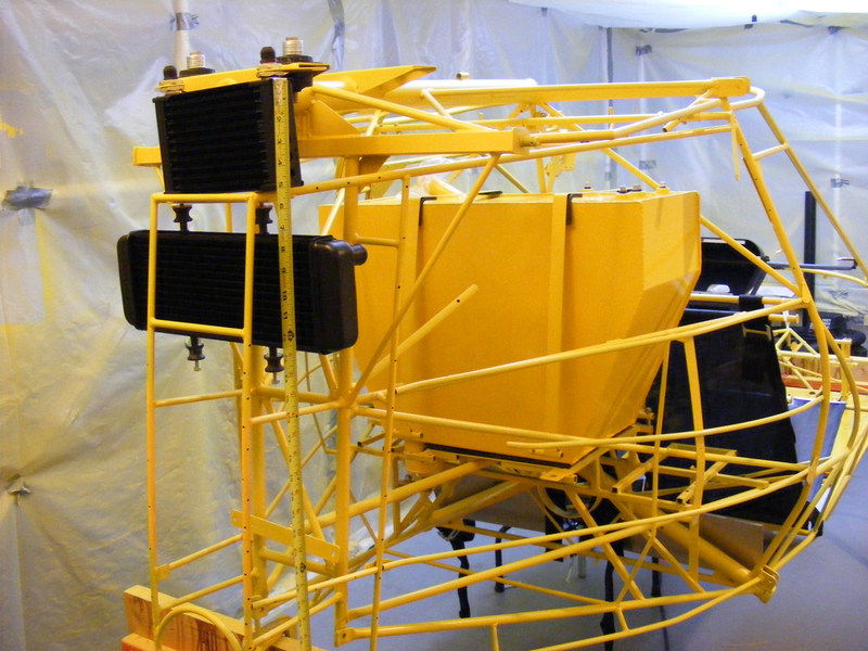

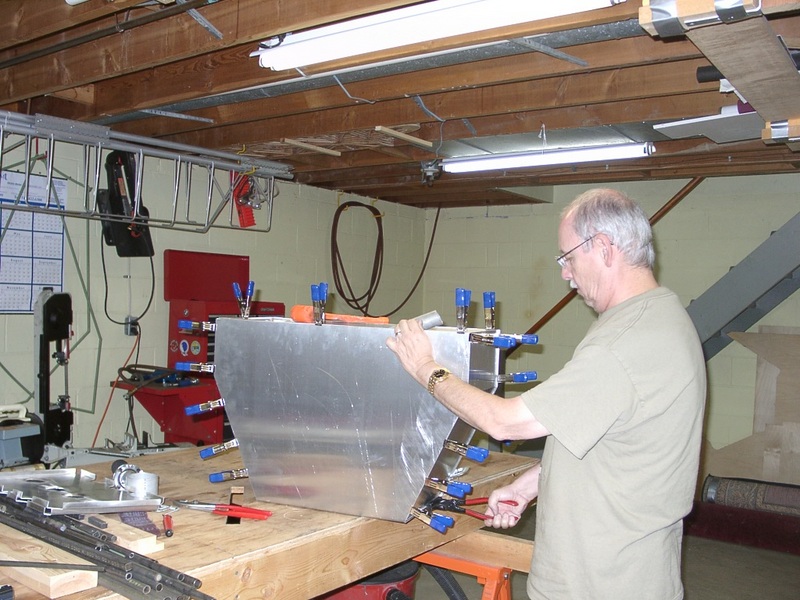

I fabricated an aluminum tank that holds a little over 18 gal. Had a vendor that I worked with at the time do the TIG welding. Probably heaver than plastic though. See attached pics.
