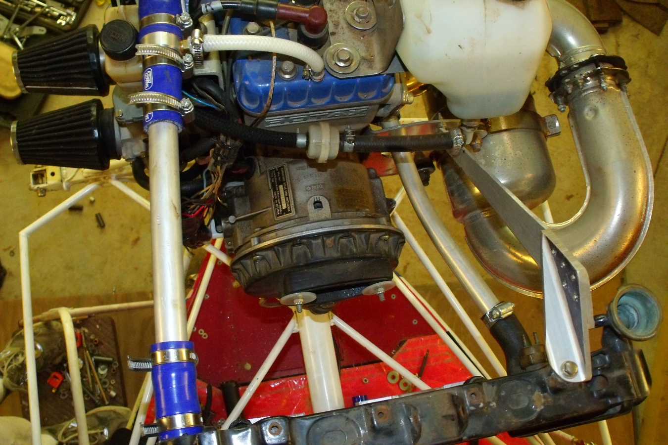

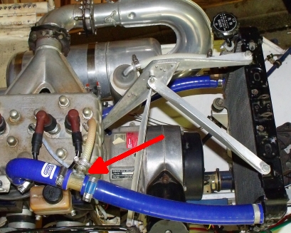

The twin radiator set up is designed for a tractor installation. They don't work worth a damn on a pusher like the Kolb. On top of that they're meant for a "C" gearbox mount AND Rotax wants over $800 for the complete kit. There's a better way.Somewhere in the archives is my report on a radiator that does work. It's off a Honda Magna motorcycle, has the fittings in the right location and can be had for anywhere from $25 to $200 so do your shopping on eBay.
How well does it work? I took off on a July afternoon when the thermometer read 117 and climbed direct to 6,000 ft. Needle on the coolant temp meter never came out of the green on a three and a half hour flight. I almost boiled over but the engine never came close.
Rick Girard
PS You'll notice that there's two different systems pictured. Worked perfectly both times.
