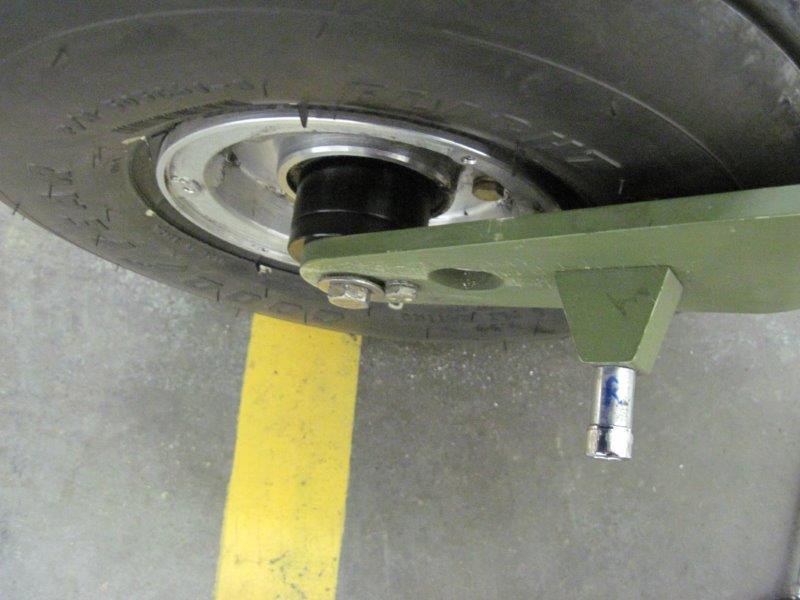

PostPosted: Wed Feb 03, 2016 4:19 am    Post subject: Re: Tow Bar Reply with quote
Here is a photo of how I extended the tow pins and used chrome hex bolts. I also used a helicoil for the attachment threads
 Filesize:  56.89 KB
 Viewed:  12314 Time(s)
 Filesize:  56.89 KB
