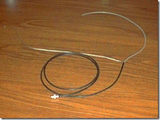

Cheep Dipole Antenna
[img]cid:FEB381D4D2B14166933CE5D8C066E966(at)BYoungHP[/img]
This is a picture of my $5.00 antenna. It consist of a bnc connector on a piece of rg 58 coax. To make the antenna cut 25 inches of the insulation from the end of the coax and pull the center conductor out through the braid. pull the braid tight and cut to the same length as the center conductor. On the first antenna I made I cut the braid to about one inch and crimped an eyelet on the end and bolted it to the frame where the nose fairing attaches to the frame. I used some clear packing tape and taped the center conductor to the side of the nose cone and across the top. After it was installed I used an antenna analyzer to check for the best swr and had to cut to match, I have been able to talk to another plane over 120 miles away, my radio is a sportys A 300 and puts out a 1 watt carrier, the signal report I recieved was that the signal strength was good but there was a bit of background noise. (wonder where that comes from in a KOLB). With the antenna pictured I left the braid intact and taped it across the bottom of the nose cone thus trying to eliminate some electrical noise from a direct connection to the cage. I have been very pleased with the results. when changing to noise canceling headsets the background noise was intolerable until I reduced the mike gain, I am very happy with the system. I used the first antenna for the ELT. and mounted it on the other side of the nose cone.
