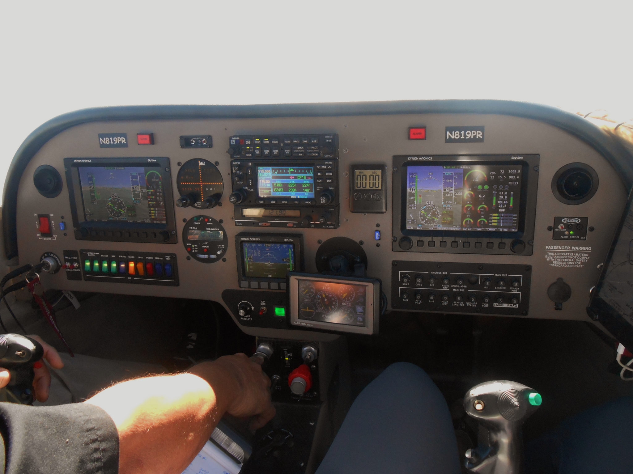

Al;  My airplane is full IFR with triple redundant flight instruments, dual
redundant certified IFR navigation equipment, two additional non certified
navigation sources and heated pitot tube. My navigation sources are
connected to my autopilot and altitude hold module so it can do an approach
if needed. You can see the instruments on the attached photo taken while
doing an approach (DME Arc to Rwy15 at MSSS) in actual IMC conditions back
in 2014.

The DYNON is not a navigator but flight instruments. The Garmin 430W and the VAL INS-429 are both IFR certified navigation systems. The DYNON provides the flight instruments and displays the navigation data from the G430W with the VAL INS-429 as a completely independent IFR navigator.

Adding to what others have said about IFR equipment certification, even
though "TSO'd" equipment is not required for an EAB, in order to legally
fly GPS IFR the GPS unit it must be certified to TSO-C129 or equivalent as
per AIM 1-1-19. This requirement specifically applies "*for any IFR
operation*" thus making it applicable to EAB aircraft.
The TSO covers much more than just an accurate GPS position source but also
includes the database(s) and error (RAIM) checking. If you can demonstrate
your GPS complies with the requirements of TSO-C129 then you can use it as
a GPS navigation source for your EAB aircraft. However, you will probably
find that if you went through the extensive paperwork required to prove
your GPS complies with the TSO you might as well obtain the TSO,
increase the number of aircraft you can sell to and the point will be moot.
Here are some links that cover this specific issue:
https://www.faasafety.gov/gslac/ALC/course_content.aspx?cID=38&sID=247&preview=true
A good discussion on this topic can be found on the DYNON forum:
http://dynonavionics.com/cgi-bin/yabb2/YaBB.pl?num=1362597418
ADS-B "OUT" position sources don't have to be TSO's but must still meet the
equivalent (14CFR-91.227 amongst others) requirement. The position
source (doesn't have to be a GPS based) manufacturer must document it meets
the requirements and again is true for all aircraft, not just EAB. The
Catch-22 is that certificated aircraft require an authorization from the
aircraft manufacturer for installation and they all have required TSO'd
equipment. But nothing says you can't install a non TSO'd ADS-B position
source that meets the requirements in a certificated aircraft using an
FAA-337 as long as you have compliance documentation, an A&P or avionics
repair station signs off on it and the local FSDO agrees.
Smile
On Sun, Dec 13, 2015 at 8:39 PM, Alfred Rosa <fredorosa(at)gmail.com (fredorosa(at)gmail.com)> wrote:
Cool panel. I knew you got the 2 Dynon EFIS recently and since they're not IFR rated thought you were VFR equipped.
Al
On Sun, Dec 13, 2015 at 6:30 PM, Galin Hernandez <galinhdz(at)gmail.com (galinhdz(at)gmail.com)> wrote:
Al; My airplane is full IFR with triple redundant flight instruments, dual redundant certified IFR navigation equipment, two additional non certified navigation sources and heated pitot tube. My navigation sources are connected to my autopilot and altitude hold module so it can do an approach if needed. You can see the instruments on the attached photo taken while doing an approach (DME Arc to Rwy15 at MSSS) in actual IMC conditions back in 2014.
Smile
On Sun, Dec 13, 2015 at 5:26 PM, Alfred Rosa <fredorosa(at)gmail.com (fredorosa(at)gmail.com)> wrote:
Galin,
I didn't think your plane was IFR but you say you broke out of the clouds at 800 ft ?

Well, yes and no at the same time. The Garmin 430W navigation box complies
with the TSO but the TSO does not specify which external display must be
used only that it have an external display with certain features. The
Supplemental Type Certificate (STC) Garmin obtained for specific airframes
indicates which external displays can be used and the displays can be
different depending on airframe. Since an EAB does not have a type
certificate, there is no supplement for a non-existent certificate the
specific equipment list Garmin provides in their STC(s) not apply. The
airframe STC is a different animal from equipment TSO requirement.
This brings us right back to the fact that if the equipment (in this case
the external display) meets the requirements of the TSO it can be used in
an EAB as long as the manufacturer has documentation proving this. DYNON
has repeatedly stated the SkyView external display meets the requirement,
have the documentation on file and the FAA is fine with it. This is why you
can use the DYNON or any other EFIS (Garmin G3X for example) external
display in an EAB and still be legal to fly GPS IFR with it. This
requirement does not apply to the VOR, ILS, LOC or NDB receivers, just GPS
Navigators.
In my specific case, in addition to the SkyView EFIS I have a TSO'd VAL
INS-429 unit that is also an external navigation information display. I can
actually display my G430W information on both the DYNON SkyView and the VAL
INS-429 at the same time. This way I have two independent external displays
for my G430W, one TSO'd and the other non-TSO'd. Since I fly real IFR I did
this as part of my multiple redundancy quest not just to make sure I
complied with the FAA.
