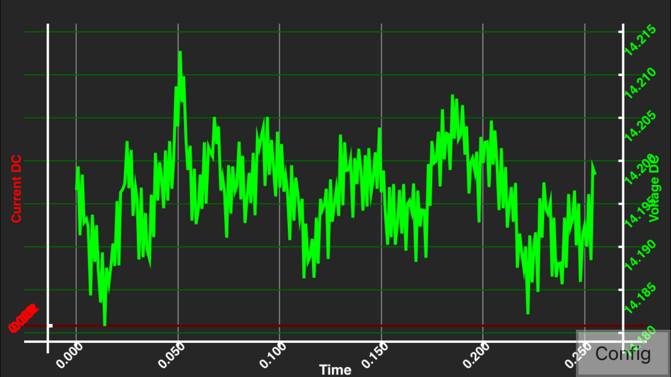

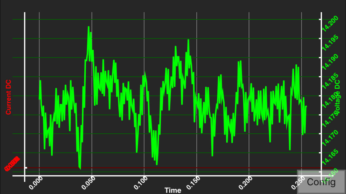

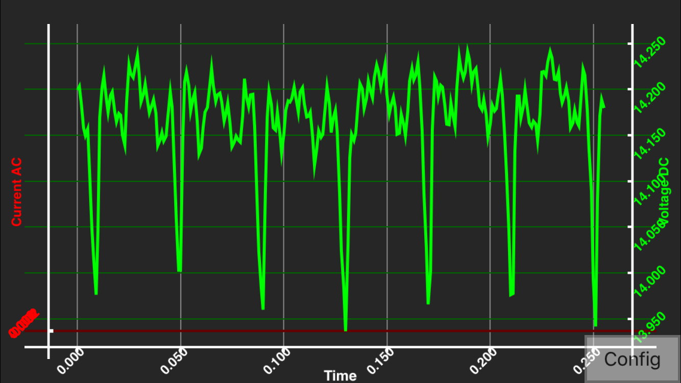

I took some measurements of bus voltage using a Bluetooth oscilloscope called a Mooshimeter. Here are 3 graphs. I'm also including a fourth one which is picture of the voltage in my car cigar lighter for comparison.
Two things are noticeable:
1. The amplitude of the ripple in the aircraft is smaller by a factor of 3 or 4.
2. There seem to be higher frequency components in the aircraft than in the car.
Does anyone have any thoughts about this?
I'm thinking that maybe the noise suppression capacitor is fried and I'd like to test this hypothesis without shelling out $125 for the Cessna part. Can anyone suggest a sensible capacitor I could try out?
