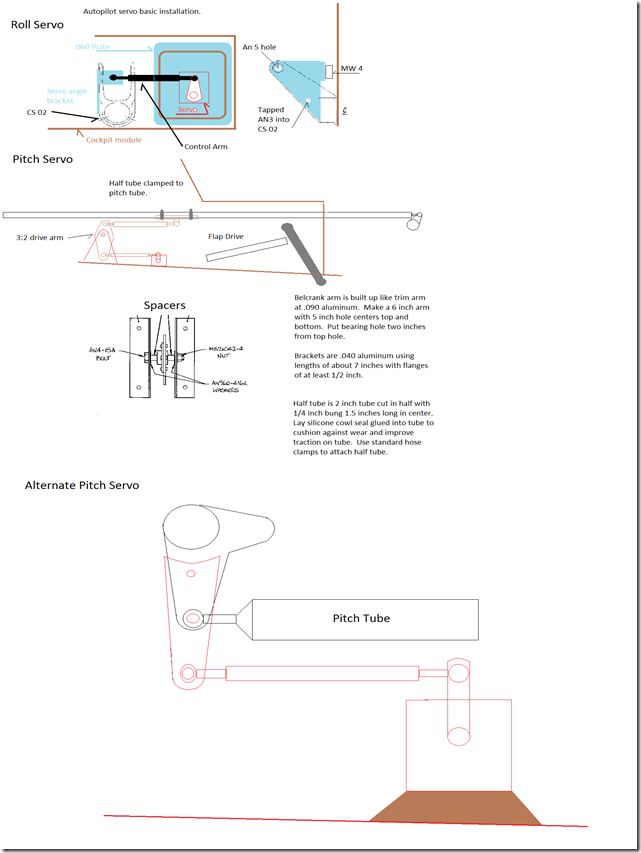

Will, A simple solution is one Graham Singleton made an approved mod for, and which I have been flying with happily for 13 years It has a Navaid actuator bolted to the side of the tunnel on the floor just behind the pilot's R heel, with the actuator link joined to a light alloy bracket on the side of the U shaped bit at the bottom of the control column. It sounds as though it might get in the way but in fact doesn't. It is in a box, takes v little current and cooling is not an issue. It is of course just for a single axis controller. If it is of interest I could dig out paperwork and a picture and I have no doubt you could either get appropriate bits from Graham or adapt the design to a more modern actuator/s.
Regards, David Joyce, GXSDJ

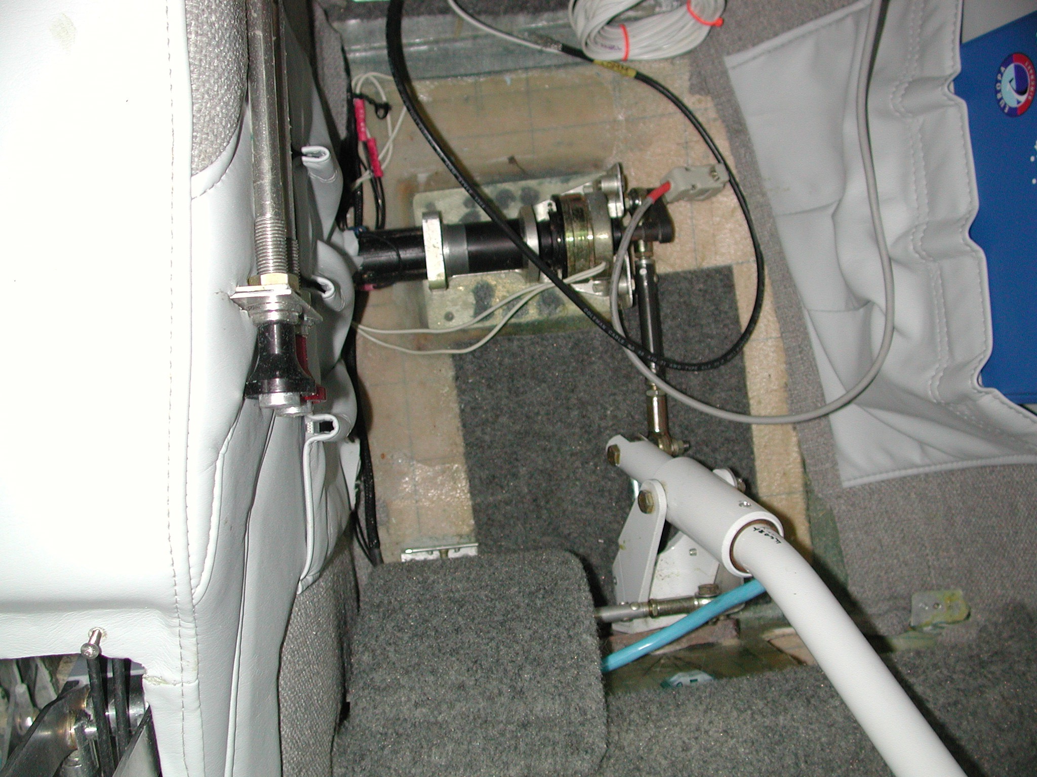

Not bound by LAA, I have my pitch servo under a floorboard between the
pax seat and the floor shelf holding the rudder pedals.

Will, I am afraid I do not have any pix on file, but I will take some next time I visit the plane, although with Wx as is that might be a week or so. Regards, David

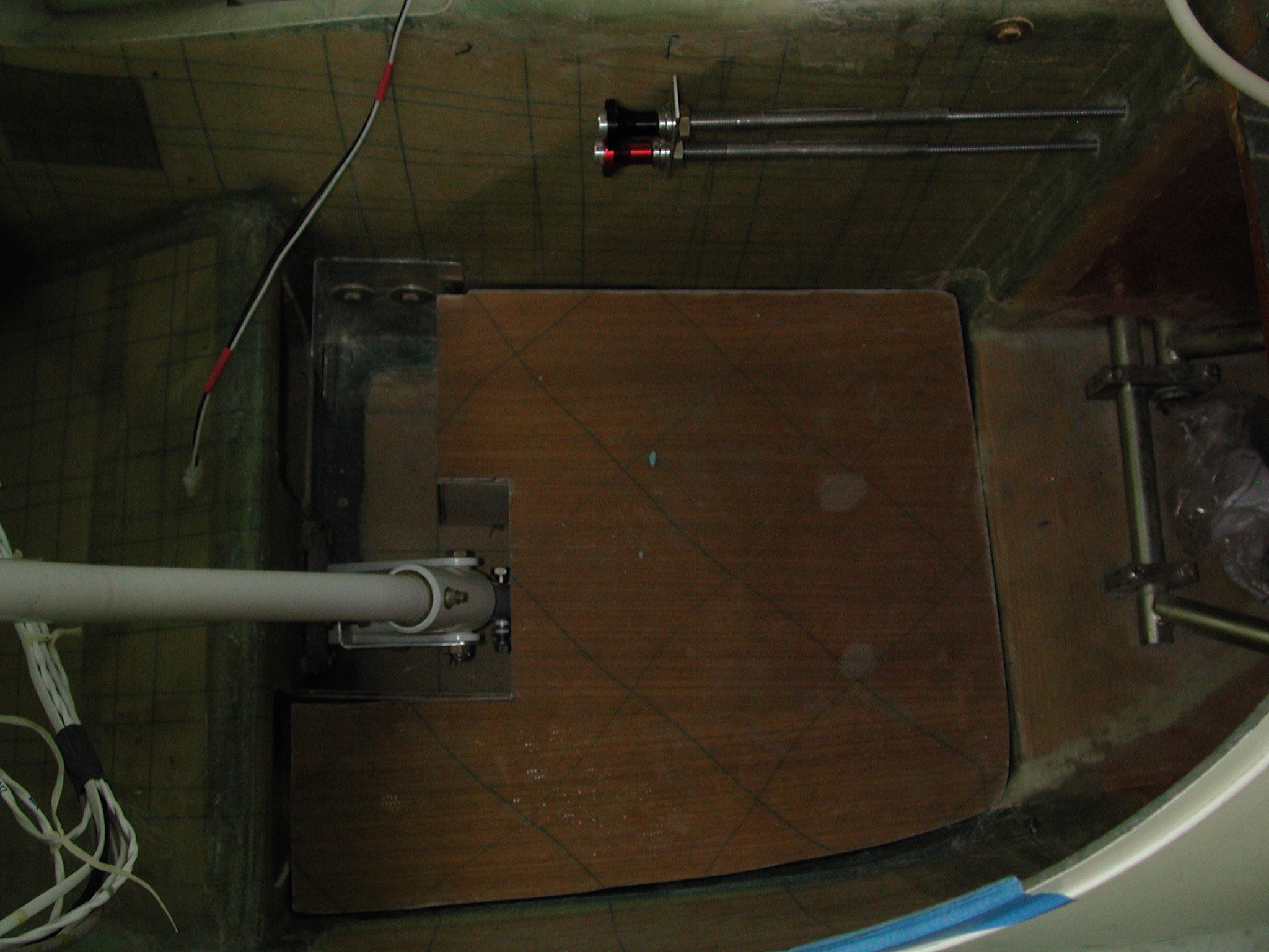

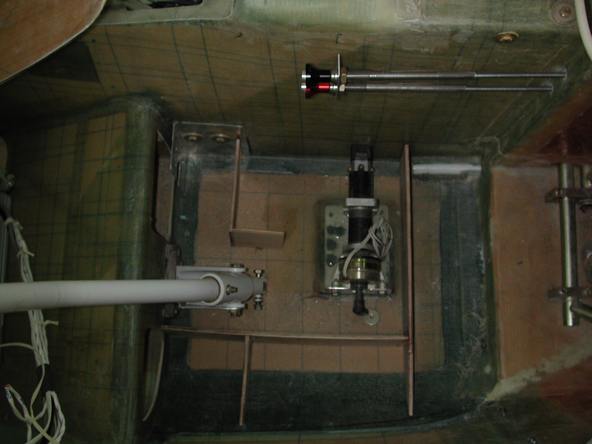

OK, some pix. All pix oriented looking down in front of pax seat.
 Filesize:  640.63 KB
 Viewed:  18747 Time(s)
 Filesize:  768.78 KB
 Filesize:  577.05 KB
Ira N224XS

Excellent thanks,
Do by any chance remember what rod end part no you used for the connection between the servo and the AN5 bolt at the bottom of the control column
I like the your way of connecting the wing servo.

--> Europa-List message posted by: "rampil" <ira.rampil(at)gmail.com (ira.rampil(at)gmail.com)>
Ira N224XS
http://forums.matronics.com/viewtopic.php?p=448754#448754
http://forums.matronics.com//files/servos_173.jpg
http://forums.matronics.com//files/floorboardsupport_128.jpg
http://forums.matronics.com//files/floorboard_852.jpg

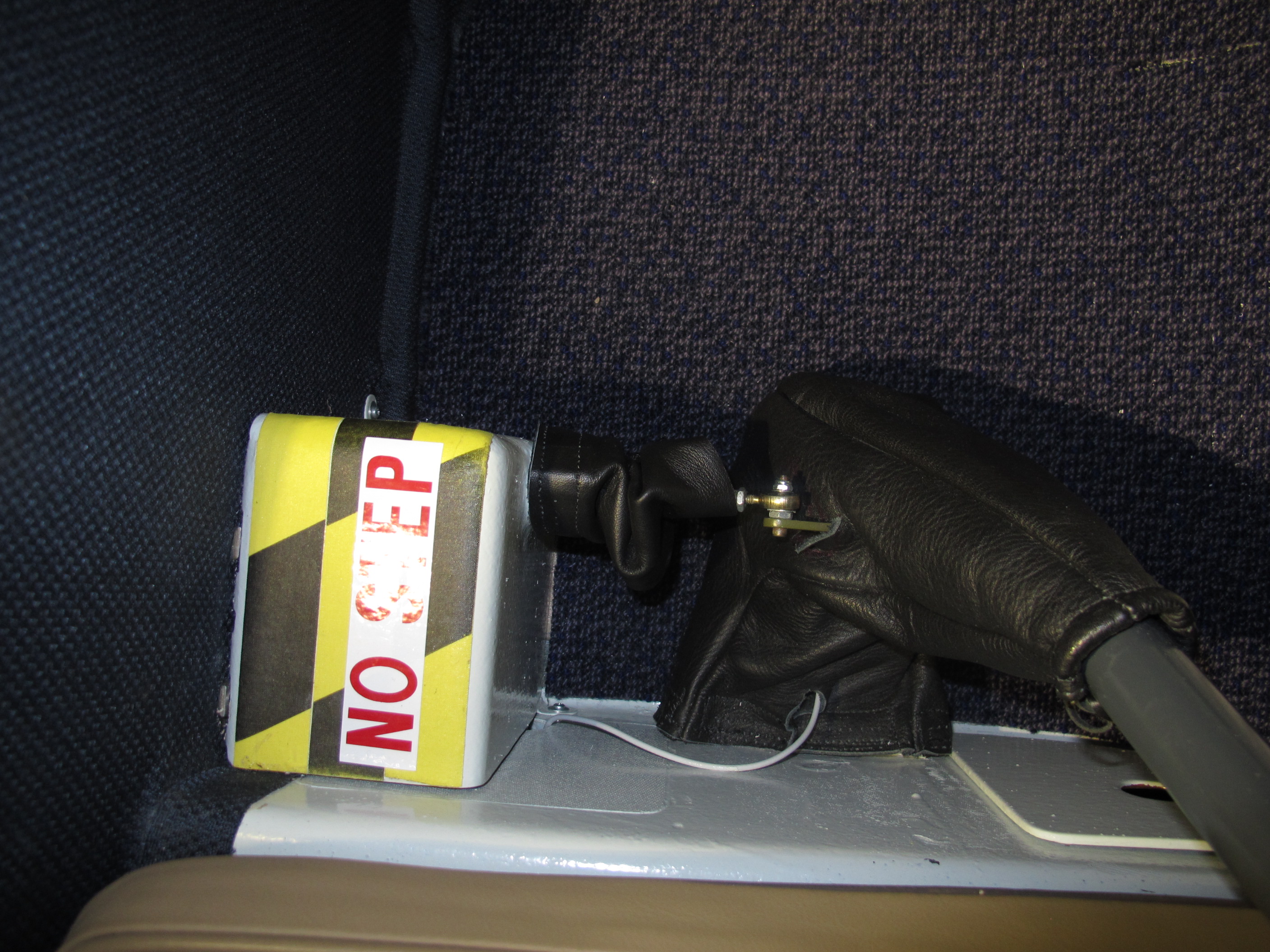

William,
Attached is a picture of the Navaid Autopilot servo mounted on the passenger side footwell of my Europa. Pretty simple installation.
Regards, Alfred
 Filesize:  1.46 MB
 Viewed:  18705 Time(s)

William,
Regards, Alfred
http://forums.matronics.com/viewtopic.php?p=448888#448888
http://forums.matronics.com//files/navaid_servo_151.jpg

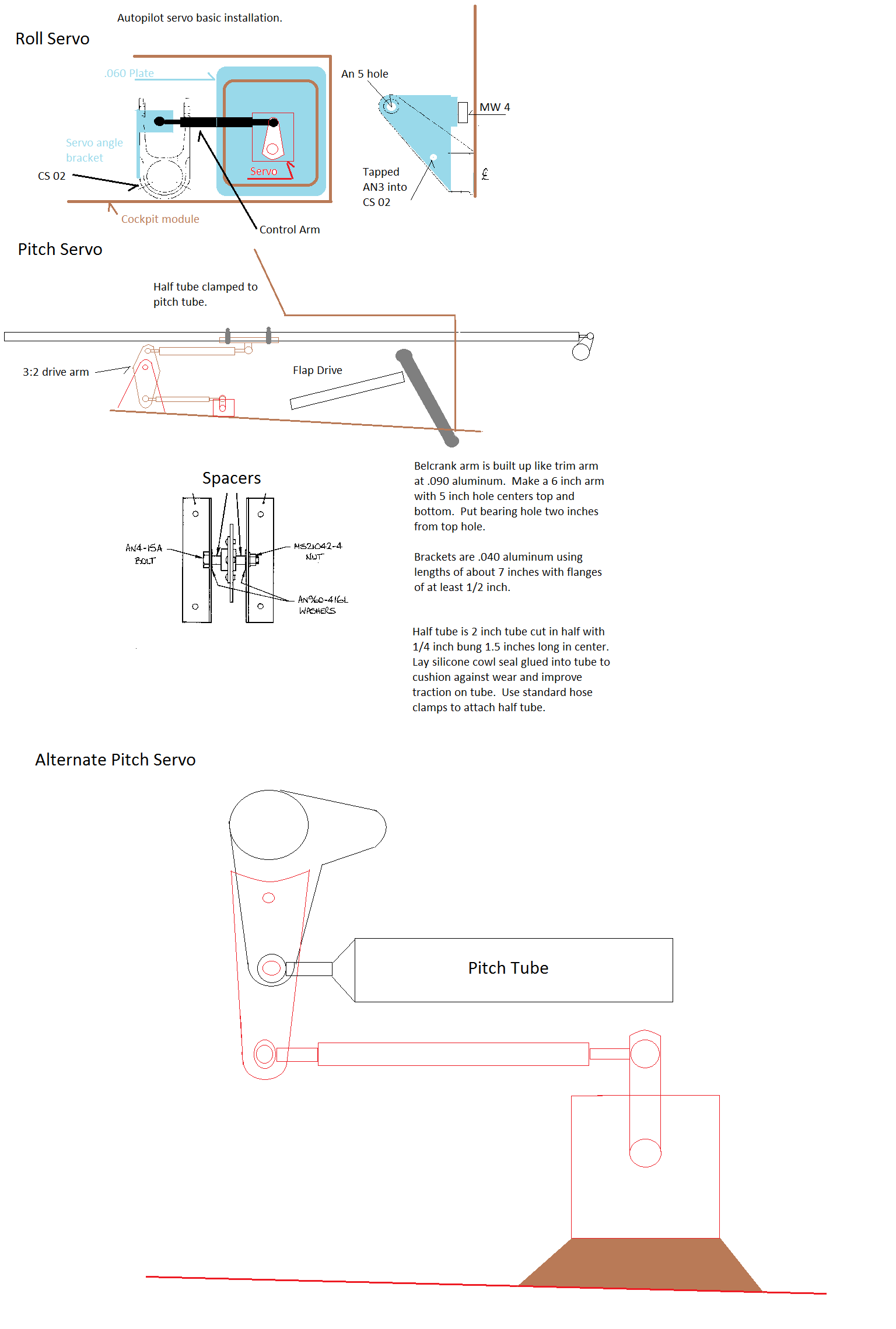

I’m to blame for the install of servos under the passengers feet. I did this in 1999 on 419PL when I started building it. I don’t do this any longer as taller passengers tended to dislike this loss of foot room as it puts their knees higher than comfortable while flying along. OK for those who fly with their feet on the rudder pedals or are a standard sized 5’ 10”. Also, these are heavy servos (Navaid, Blue Mountain, etc.) and weigh about 5 pounds. If you put the battery in the front, watch the weight in the cockpit. Strive for the 60-61 inch empty weight CG. You’ll have to keep the panel light. These are very long servos also, so in a crash, just unscrew it and it makes an excellent club for survival.
This setup under the feet also is a bit tough with the Garmin, Dynon, TruTrack and GRT servos. These light weight servos (about 2.5 pounds) are very good also, plus they have a smaller footprint, but they are taller. Reducing the foot well even more.
Here are two other ideas I have used for quite some time.
1st is a design I made to put the servo behind the baggage bay. See the drawing. It is dumb simple. It is a 3 to 2 arm on a bearing and two push rods so as to allow the servo to move about 45 degrees. Bob Berube and I consulted on this and I have made it my standard for retrofits where the only place to put the servo is behind the baggage bay. It can be installed after the top is on in a finished airplane by access through the D panel. It is not comfortable.
In all my aircraft, the roll servo goes under the pax seat. Make a simple metal plate of .060 aluminum and four nut plates to the face of the inboard seat hole. Attach the servo to it. Make an arm and attachment bracket for the stick. Fab a fiberglass cover to prevent the pax from impacting the arm.
2nd is a simple extension to the stab tube attachment point and hook up. Pretty simple, easy to bolt up if your plane has access panels which are positioned properly. I always have three access holes.
A 4 inch sight hole for the MAC trim servo, a 6 inch abeam the mass balance arm as in the book. I then put on the port side a single 6 inch to access below the pitch push rod to stab tube attachment. If you have those small Europa mandated sized holes for drug addicted anorexic maintainers, this may be painful to try unless installed during the build and access holes are well planned.
Always plan your servos so they cannot go over center and jam the controls. Many servos come with limit arms to prevent this, use them. The limit arms typically allow 45 degrees of movement max. Why use 45 degrees or close to that is to allow the servo to have a larger movement as the clutches and servo settings do not work well when the servo is limited to a full throw of less than 30 degrees.
I have better drawings in my archives, but it will be a while to get them as my servo was hit by lightning and fried so it needs to have its hard drive recovered.
[img]cid:C7B246FC6CA14382B8678A584046BD84(at)PCADMIN13[/img]
Just a thought as legroom in the Europa is at a premium.
Bud Yerly

Is there any reason for the 3:2 arm on option no2 for the pitch servo.  Would it be possible just to build a "bridge" over the rudder wires to bring the servo up to the right level?
Will

The 3:2 is to give the servo a bit more more throw. The pitch tube only moves about 1.25 inches which translates to a very small movement of the pitch servo arm.
On the pitch servo in the rear, it takes a fairly high block or bridge. Just make it robust enough. It’s dimensions escape me as it varies by servo. Depending on your servo choice and orientation, some fiddling is required to get it fairly level and yet clear the main tube and above all, be serviceable.
Just make sure the servo can never jam the flight control and is robustly attached to the airframe.
Regards.
Bud Yerly
