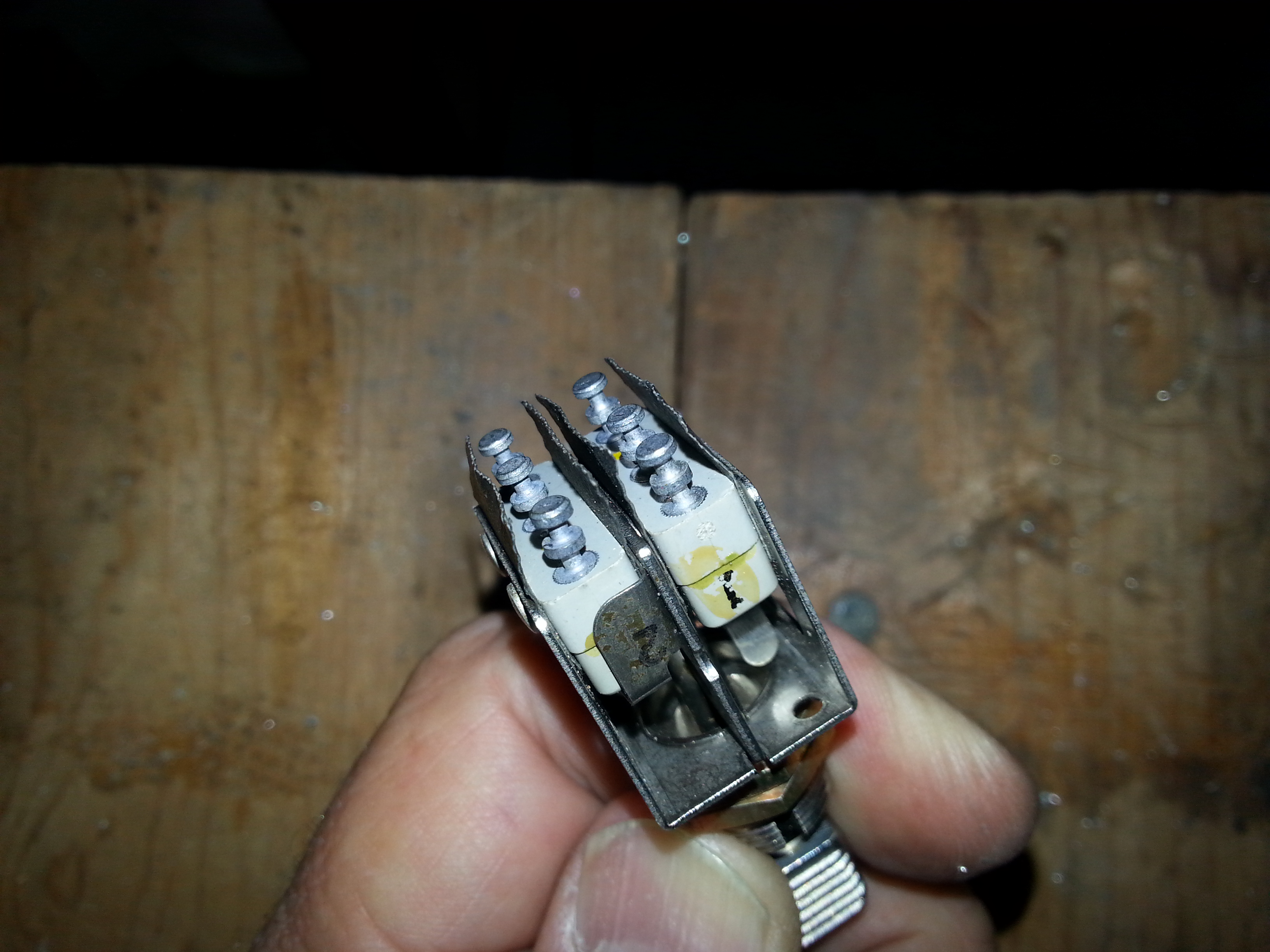

Can someone help me identify what kind of connectors are used on this
switch? I want to use it on the flaps for an RV7A. Part # 13AT437-T2
7711 or M8805/26-010, not sure which one is the part number.
Thanks!

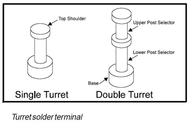

Those are called solder turrets:

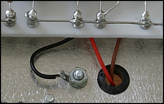

There is no mating connector. They're meant to have bare wires wrapped around them then soldered, like this:
I'll leave it to others here to discuss their suitability for use in aircraft.

Thanks for the reply!
