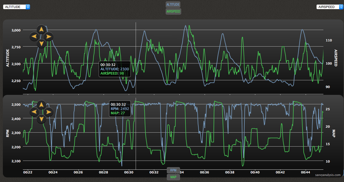

Do you have any idea of the engine RPM / manifold pressure on those flights?

PostPosted: Tue Oct 27, 2015 12:17 pm    Post subject: Soundproofing the QB fuselage Reply with quote
Jim,
engine RPM was 2500 RPM as CS and limited to that as otherwise they
would not pass the noise measurement in this country.
Actually measured levels were
#1 77.2-79.5 dB(A) we had 1019 hPA QNH on that day, RPM varied between
2477 and 2575 (the 79.5 dB(A))
#2 (He might have MP logged) 74.0-76.2 dB(A) we had 1018 hPA QNH on that
day, RPM varied between 2489 and 2500

PostPosted: Wed Oct 28, 2015 1:31 pm    Post subject: Re: Soundproofing the QB fuselage Reply with quote
Jim MP was 27 decreasing to 26.5 climbing from 2300ft to 3000ft with around 98 KIAS.
Although subjective I consider my -10 less noisy compared with the ones I flew in before. But truth be told there were always month and years between these flights so they would barely hold up to any proof. Werner had the direct comparison as he switched planes right away.
Cheers
Michael
