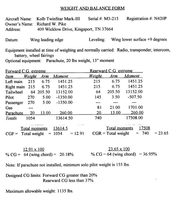

Looking at your figures, I realize that my answer is not exactly what you need, sort of an apples and oranges thing - here is how I did mine using the manual; see attachment.
Looking at my figures, my most forward CG is 12.91" from the LE, and the most rearward is 23.65", but your results may vary.
Note - when landing with a very forward CG, suggest not using flaps unless you have gap sealed the elevator to the stab, and the underside of the stab has VG's. Even then you will notice reduced control authority from the elevator.

The range I use for my MkIII is:
Aft CG Limit is 23.1" or 35% of wing chord
Forward CG Limit is 16.5" or 25% of wing chord
