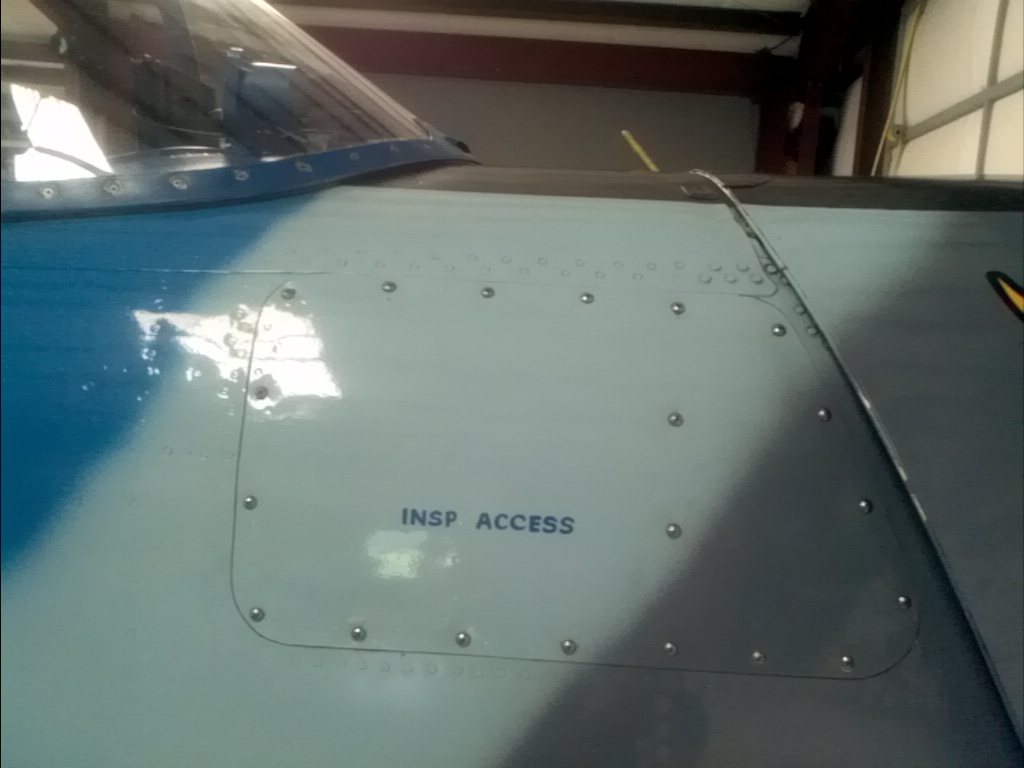

clouddog22(at)gmail.com
PostPosted: Thu Jun 25, 2015 4:56 am    Post subject: HS6/Chang Triplex Gauge Reply with quote
Harv, it is the large inspection panel on right side of aircraft just aft of the cowling. Here is what you are loom ng for. There are two side by side  to the right as you are looking into the cavity after you remove panel. Can't remember which one goes to front gate vs back have. On Jun 25, 2015 3:20 AM, "Harv" <martin.harvey(at)kbr.com (martin.harvey(at)kbr.com)> wrote:

PostPosted: Thu Jun 25, 2015 7:04 am    Post subject: Re: HS6/Chang Triplex Gauge Reply with quote
Excellent...
Thanks for the pic, it all makes sense now! Very Happy

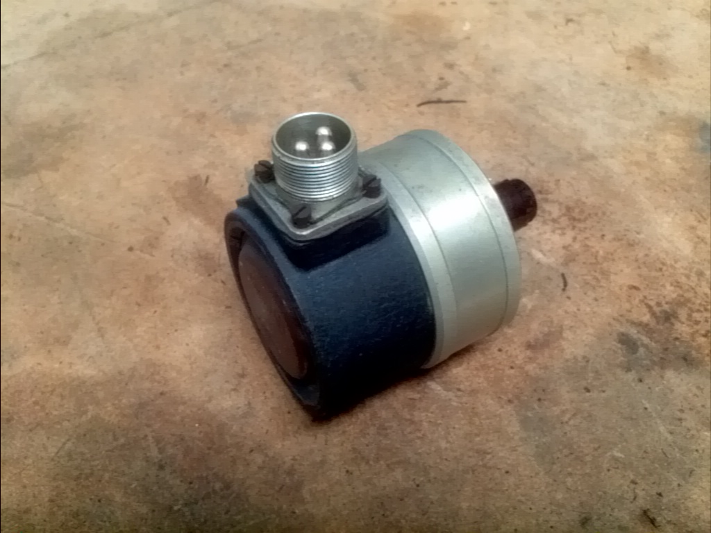

Update
I removed the access panels and established which oil pressure sender gives signal to front and rear cockpits respectively. Cleaned and swapped cannon plugs and the rear reads fine with the front still being at fault. I assume from this then the front cockpit triplex gauge is defective.
Does anyone have a good gauge for sale?
Also what function does the blanked off tube pushed onto the sender serve??
dsavarese0812(at)bellsout
PostPosted: Sun Jul 05, 2015 1:06 pm    Post subject: HS6/Chang Triplex Gauge Reply with quote
It's a vent tube.

I'm certain it's a wiring problem as the gauges behave normally when put into the rear cockpit, probably a bad joint at one of the cannon plugs on the front loom.
I'm not sure though how to debug? I've unscrewed the plug ends and eyeballed the internal joints which look ok. My idea is to now test the cannon sockets one by one, so socket connection pin marked as 1 goes to the other end of the wiring loom which is also marked as 1 on that cannon plug?
I will have to dig through my wiring diagrams.
GeorgeCoy
Joined: 02 Dec 2010
Posts: 310
PostPosted: Mon Sep 21, 2015 7:15 am    Post subject: HS6/Chang Triplex Gauge Reply with quote
I hope you guys reversed your senders to confirm it is not a sender problem.
Swap the two cannon plugs and see if the problem follows. We have seen bad
senders in the past.
