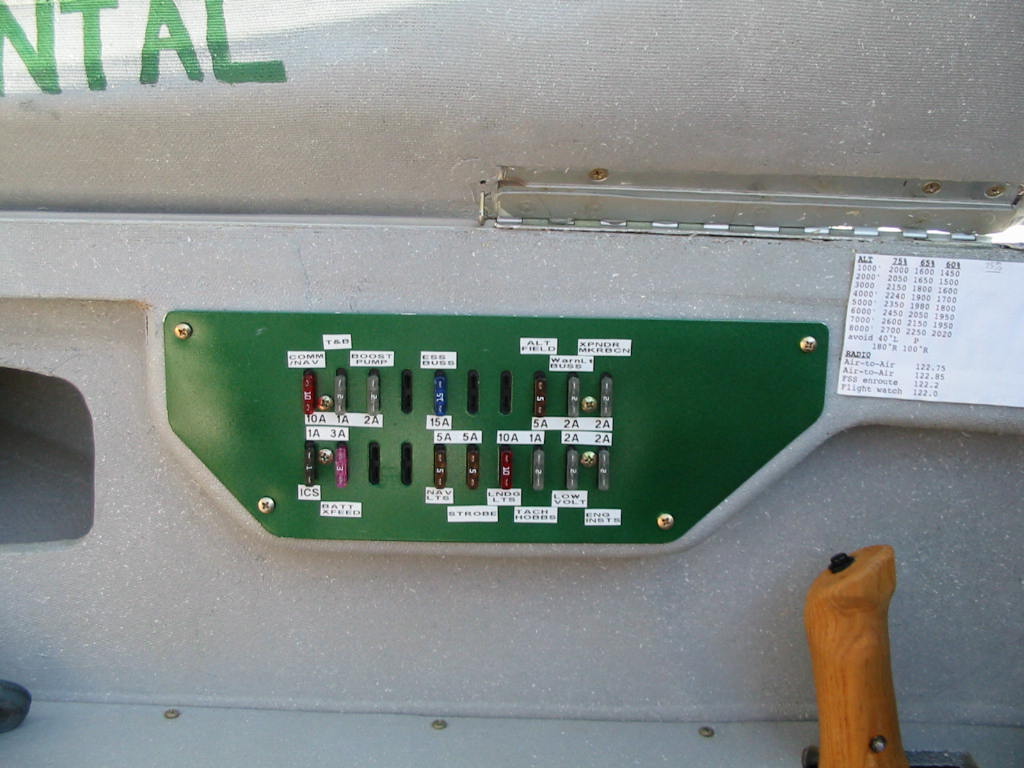

In my setup, I took a multi-fuse Bussman fuse block (pic) and cut the interior center conductor to create a main bus and essential bus. I silver-soldered a copper tab on the smaller essential bus side of the center conductor (left side in the pic) to wire battery power to the essential bus through an “essential bus” switch which is normally off. The main bus provides power to the essential side through a diode and all is powered. In an emergency, I can turn off the master switch and power the essential bus via the essential bus switch. Sorry, don’t have a better pic but you get the idea, I hope-Kent
