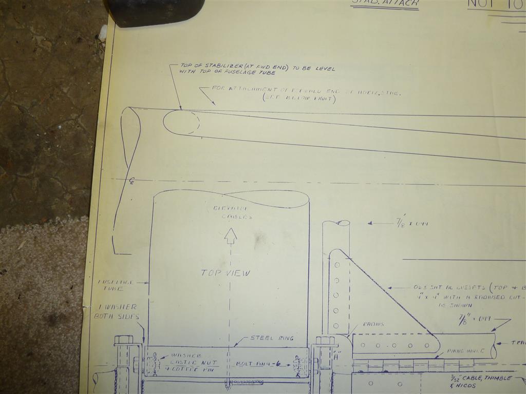

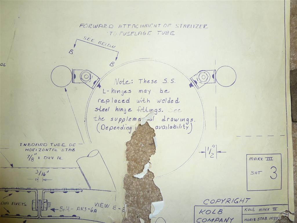

PostPosted: Thu May 14, 2015 5:47 pm    Post subject: Re: Horizontal stab position Reply with quote
Dude, I'll do you better than that: here is what's left of the blueprints that tell you exactly where they are supposed to go. The front of the horizontal stab is even with the top of the boom tube.
Caveat: this is for the MKIII Classic.
Parts of the blueprint are missing: the mice got hungry.
True story.

PostPosted: Fri May 15, 2015 7:57 am    Post subject: Re: Horizontal stab position Reply with quote
Hi Tony,
Before you change anything, how did the plane fly? I had an issue like this on my MkIII Xtra that made the aircraft unsafe to fly, but if the flight went well on your aircraft maybe there are no changes to be made.
Now, like John H mentioned, if the aircraft needed full up trim then maybe the Horz Stab angle is set incorrectly. But all these planes are a little different to each other and I would review the flight handling first before making any change. Also, make small changes using washers, etc, if you can, until you get it dialed in.

PostPosted: Fri May 15, 2015 9:51 am    Post subject: Re: Horizontal stab position Reply with quote
The L.E. position of the horiz. stab. has been changed several times since the Xtra came out. I set mine per instructions from Brian at TNK and it has worked great. I think it was given in degrees using the motor mounts as a base. He also gave me the wing angle based on the same. I used a digital level. Call Travis or Brian for information.
Rex (will have my 40 hours flown off by this summer)
