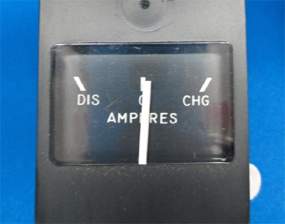

Say you DO put it in the (-) side of the battery . . .
how would you use the information presented?
Ammeters are pretty worthless in the cockpit.
They WERE originally installed as a go/no-go
indicator of system performance. The zero
center, un-calibrated instruments were
battery-ammeter clones of the instruments
found in cars. As long as the needle was at
or above 'zero' all was right with the
universe.
[img]cid:.0[/img]
If your DEK180 has a voltage display
function . . . and better yet, a low volts
warning function, the usefulness of the
panel mounted ammeter as a flight management
instrument goes to zero.
If you become aware of a low voltage condition
that mitigates with reduction in load, then
the alternator is CRIPPLED and you reduce loads
to keep voltage at or above battery discharge
level of 12.5 volts. If no mitigation is
possible, alternator is CRAPPED and your
plans are necessarily modified.
Values of CURRENT under all conditions
of flight are predictable and should be known
as part of your load analysis and system design
goals. The idea that having a continuously
monitored current will assist with a aw-S%$T-
flip-a-switch situation in the cockpit is
unrealistic and easily replaced with PLAN-B
that calls for flipping at most 2 switches
with predictable result that does not depend
on an ammeter for confirmation.
Recommend you put the shunt in the alternator
b-lead. That will be most useful as a GROUND
diagnostics tool AFTER plan-b got you comfortably
on the ground.
