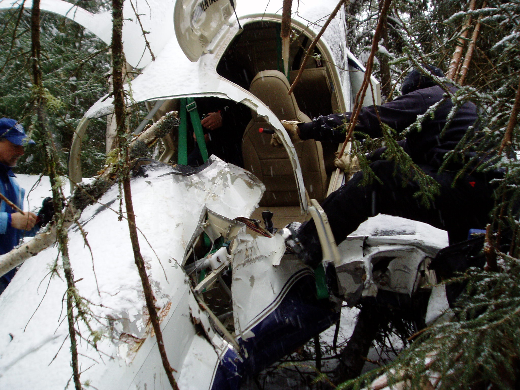

Last night I was thinking about the images in Doug's photos and was really curious to know how effective the shoulder harness anchor bolt is in that situation.
My curiosity stems from seeing a friends Culver Cadet (no shoulder harnesses in that old plane) that he landed off field 7 years ago.   It's still sitting in his garage and has a pair of human head shaped indentations in the glare shield.  If he had effective shoulder harnesses, it would have saved them some blood and a deviated septum.
We've had a handful of RV-10 accidents that have tested the integrity of the shoulder harness anchor bolt possibly being pulled through the fiberglass hole.  I just wonder how it really performed in each of these accidents.
1) Have any of you seen, first hand, an RV-10 airframe after it has been in an accident where the shoulder harnesses were stressed significantly?
2) Would any of you know where we could get that information?  Perhaps a FOIA or something similar?
I'd really like to get the real details on how that shoulder harness performed.  We've probably got 5-6 accidents where that information could/would be collected.

I think it's worth considering that if the harness bolt is pulled in the intended direction, it seems to me that it would be loaded in shear, not tension.  So if the crash is survivable, the bolt pulling through the cabin cover isn't what we would see.  I'm not an engineer, but I did copy the front mounts for my rear inertia mounts...and I wondered the same thing until it occurred to me that the bolt gets tugged in a line approaching the direction of flight.  I don't think it would get pulled through.

Well, I'd say the front harness mounts see a substantial amount of tension as well as shear.
Looking at the photos and the text, it appears a large section of the left roof failed. I wonder if the forces exerted by the shoulder harness contributed to this? Or did the roof fail only after experiencing an unsurvivable loading, say more than ten times the pilot's weight, from the harness? Or was the failure due to crash forces applied directly, independent of the harness?

Good questions. Lacking data however I evaluated the canopy top fiberglass thickness for the pilot and copilot shoulder harness anchor points less than adequate considering the significant countersink depth needed to have the anchor screw flush with the cabin top. Again, no data to say my evaluation was correct or not.
I added several bids of glass on the inside of the canopy top for each anchor point. The first layer being 1/16" thick covering an area of 10" by 10" or so, then another 6" by 6", 1/16" or so layer on top of that.  The objective being to allow for fairing with the rest of the bottom of the cabin top. This resulted in sufficient thickness for countersinking the head of the anchor screw such that it was slightly below the surface of the canopy top. I flatten the screw edges and installed the anchor screw in some flox as I wanted to make sure it would not turn when tightening the nut onto the inside. Sanded the flox flush, a layer of glass on top of that, then a skim coat of micro balloons to fair it in.

I did the same thing on mine.
I'm just curious how they've actually performed in the accidents that have been logged.
Perhaps an I need to make a call into the NTSB and see if there is more information beyond what is available in the docket.

What about that crash near Lake Placid Airport in NY that went into the trees in the cold.  All occupants walked away OK with minor injories.  There was also the one in SoCal, Ramona RMN that put it on a hillside into terrain and walked away.  Seems the belts and airframe performed as designed on those instances.
I think the key is survivable impact.  I’d hazard a pretty safe guess that Van’s engineered the structure appropriately.  Who knows if they used the official 170lb FAA weight or the bubba weight though?

From the Lake Placid NY crash...
Preamble: It has been just over 2 years since this crash. On several occasions I have started to do a write-up on the incident. Each time I have tried I get tangled up in my own brutal self judgment. I am know as a very competent and conscientious pilot. 2,000 hours flying since 1986, instrument rated since 1989. At the time of the accident I was very IFR current, in a very capable aircraft, yet I allowed myself to follow a series of small events into a classic accident scenario. While I have flown over 100 hours since the crash, I still have a difficult time reconciling this in my mind. I remain confident in my pilot skills, but have an excessively conservative approach to the passion of flying.
I will try to post a thorough synopsis of the accident in a separate post in the next few days. Please hold off on questions and comments about the crash until I post this as a separate thread.
As for the airframe, the majority of the impact was absorbed by a side load impact. That impact contacted the fuselage on the pilot side at the junction of the leading edge wing root and the fuse at the instrument panel station. The entire panel and front of the fuse were displaced about 1 foot to the right.
The lower portion of the fuselage separated from the fiberglass upper structure in that area. The remainder of the fiberglass top remained intact. The shoulder harness attach points showed no sign of stress or compromise. There was no impact bruising from the harness on any of the occupants. Due to the initial side impact, and subsequent wing leading edge impact with multiple pine trees as we descended the final 100 feet, there was minimal frontal impact when we came to rest nose down on the mountain.
The RV-10 withstood a tremendous amount of impact damage, and the cabin remained a safe haven. I am almost done building a new RV-10 to replace N10FD.
Best,
Frank

Wow - thank you for the posting. Gives us all a lot of confidence in our craft. I love the casual, "as we descended the final 100 feet." We all look forward to your more extensive post. God Bless you and we wish you many years of safe flying ahead. Perhaps you could give a lecture with Q&A at OSH this year!
See you OSH '18
