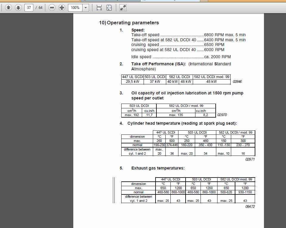

I've added the page from the 447 operating manual that contains the nominal operating temps for the 447. 1200 Deg EGT is max. I've set my Grand Rapids unit to reflect that as Red Line. I normally see EGT temps around 1120 and CHT around 350 during cruise depending on weather. The chart says normal EGT is 860 to 1000. I see the 1000 range during climb out and at wide open throttle but not during cruise. Nose down and unloading the prop causes the EGT temp to rise quickly. Don't be surprised if you see the EGT rise quickly in the 4000 RPM range. That is the leanest area of the mixture curve for the Carb. I try to stay out of that area as much as possible. If you experience high EGT all the time, then you may have to visit your prop pitch setting and dial in a little more pitch. I probably could dial in a tad more on mine but my Firefly is performing very well where it's at so I haven't messed with it. I live in Michigan and still have some snow. I hope to be flying by the beginning of April somewhere. Kudos on your Firefly. Nice Pic
