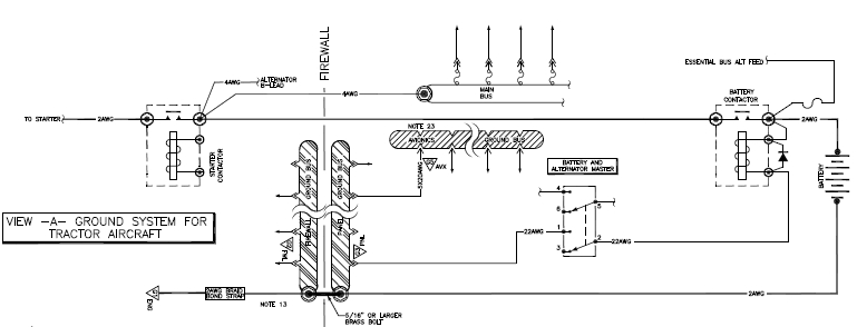

The strongest odds are in favor of a poorly
architectured ground system. You spoke to a
constellation of wires in the ground system
that give an initial impression of 'ground
loop city'.
Figure Z-15 from the 'Connection illustrates
some of the common pitfalls
http://tinyurl.com/6w87rvb
and suggestions for crafting a 'clean' ground
system.
[img]cid:.0[/img]
The symptoms you described MAY NOT have root
cause in your ground system architecture . . . but
unless the ground system was initially crafted
with the simple pitfalls in mind, then one cannot rule
out grounding as a contributor to your woes . . .
but let us look elsewhere first.

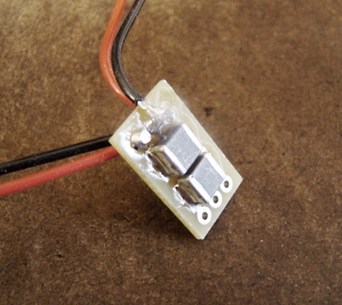

Your problems that manifest with your LED lighting
products are most likely associated with radiation
from their switch-mode power supplies. Some years
ago, we offered a filter kit that tamed a popular
switch mode supply in a DIY lighting kit. Sales
volumes went way down on that product and it was
discontinued.
I have a filter that was crafted for a customer
some years ago . . . to mitigate conducted noises
that were not accounted for in the initial design
goals.
[img]cid:.1[/img]
I can send you one of these to try on your landing light.
If it proves adequate/useful, I'll throw some more together
and we can sprinkle them around on the other LED antagonists.
This is a cut-n-try approach . . . given the limitations of
diagnostics-by-wire . . . it's about the best we can do . . .
If you'd like to try this, shoot me a mailing address . . .
