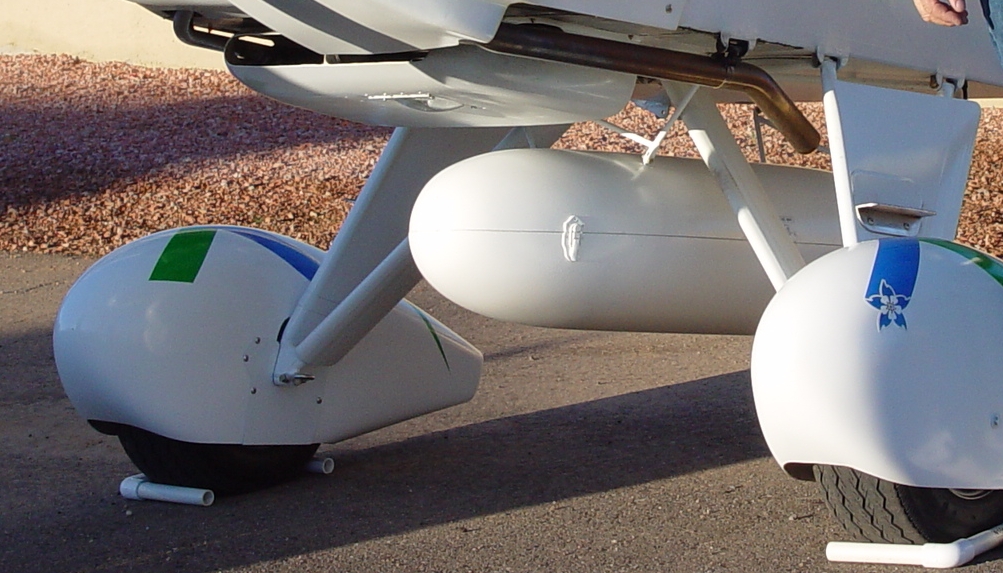

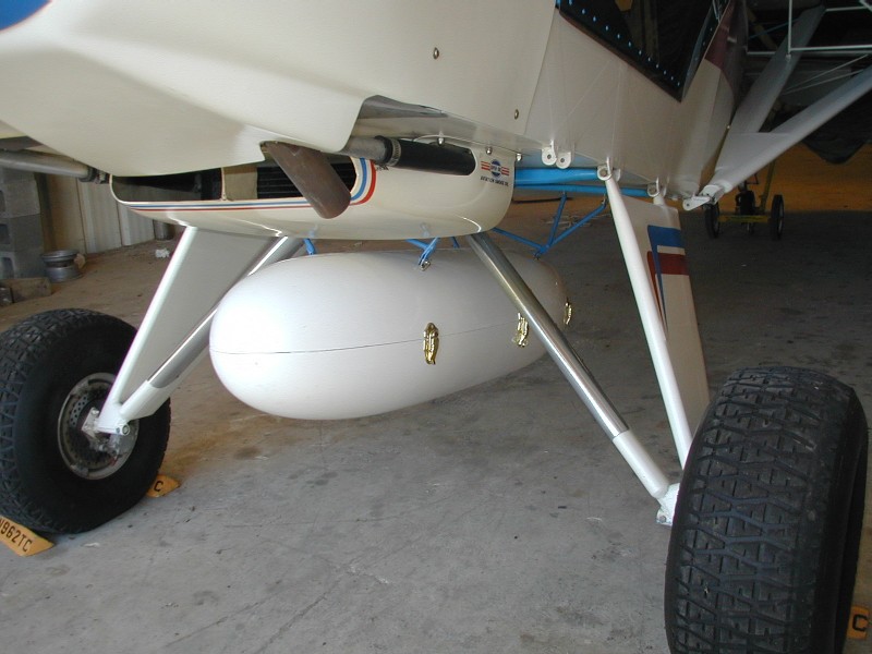

FLIER(at)sbcglobal.net
PostPosted: Thu Oct 19, 2006 11:27 am    Post subject: Cargo pods.... Reply with quote
Floran,
Did your pod come with two mounting brackets -- front
with two legs and rear with 3?
I've had a pod on my IV for 5 yrs now and use it
often. Some time ago I took some detail photos for
another gent that was mounting a pod but the attached
is all I could find this morning.
The front mount is simply two AN eyebolts up through
the floorboards just behind the radiator scoop. The
tripod rear mount attaches directly to the tabs on
the tubes.
Ted

cliffh(at)outdrs.net
PostPosted: Thu Oct 19, 2006 6:15 pm    Post subject: Cargo pods.... Reply with quote
The picture you sent look like the mounting brackets that I received from
John McBean
My scoop is different. The rear of the scoop extends back to the rear
mounting bracket on your cargo pod.
It has an adjustable door on the rear that I can adjust from inside the
cabin to control the radiator heat. Just like on a F-51.
Floran H.
