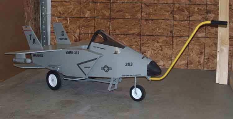

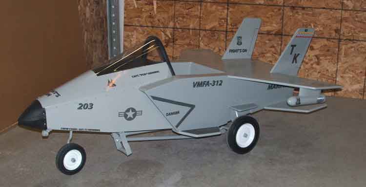

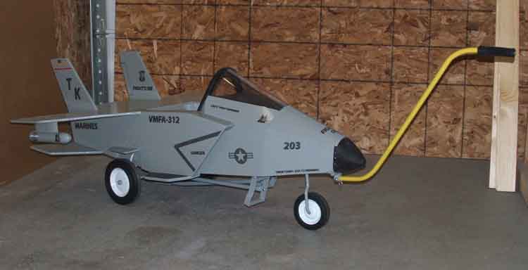

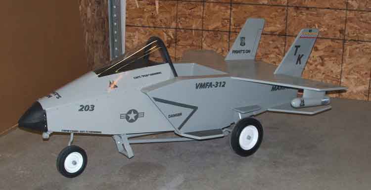

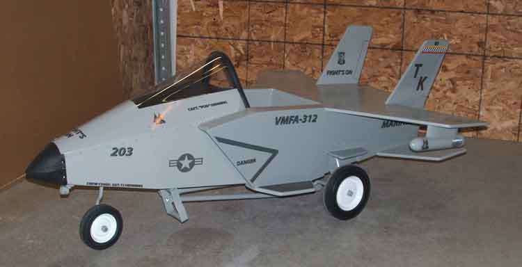

PostPosted: Wed Oct 18, 2006 9:15 am    Post subject: Ruboff decals for panel lettering Reply with quote
Ink-Jet & Laser waterslide decal stock (8.5 x 11 sheets in clear or white)
is available from:
http://www.beldecal.com/model_decals.cfm
I've used it for all the decals on a pedal plane that I recently completed
(photo's attached) and was extremely pleased with the results.
Todd Henning
West Bend, WI
CH701
