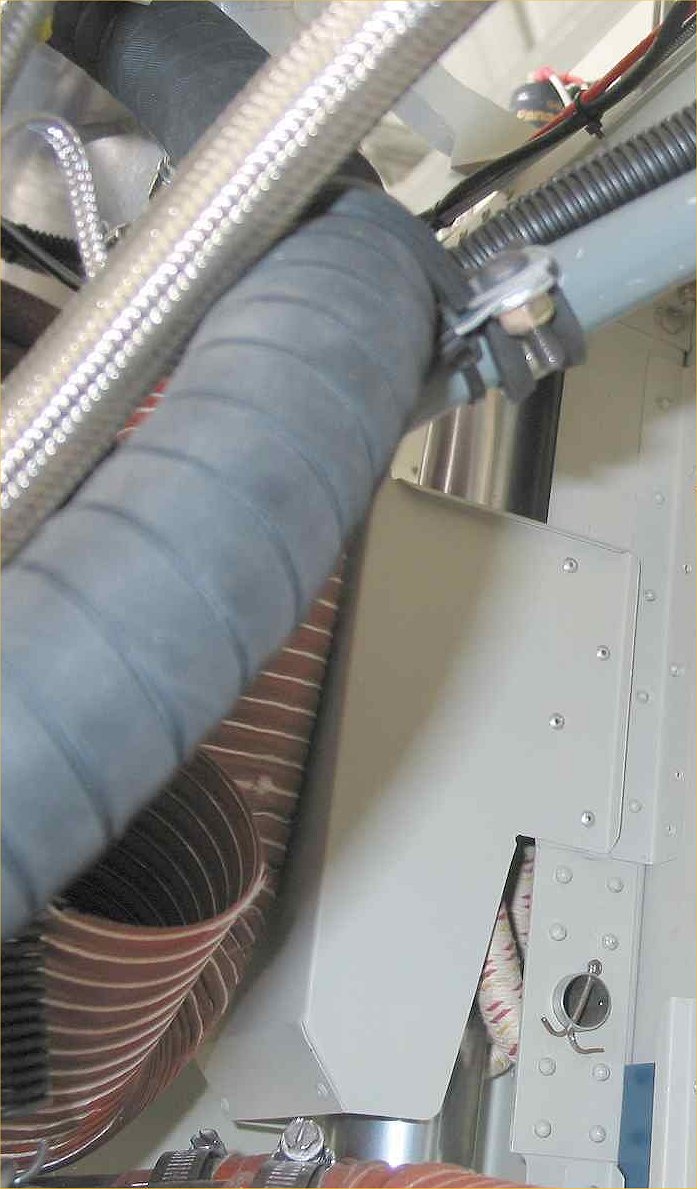

peterd(at)metec.co.nz
PostPosted: Sun Oct 08, 2006 5:46 pm    Post subject: Nose gear bungees Reply with quote
Hi George,
I did make up a heat shield (see attached image) to deal with the issue of radiated and circulated heat after engine shut-down. FWIW, I have yet to prove any benefit, but it was simple to do at the time.
Tail winds
Peter Dunning
CH601HD/6-3884/912S
