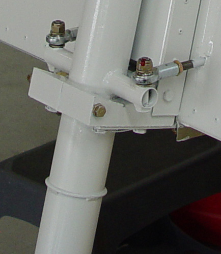

PostPosted: Sat Oct 14, 2006 12:55 pm    Post subject: Tow Bar Reply with quote
Larry, do you think the stop ring is needed? Zenith apparently does because
I think the current kits have one (see attached picture). My antique
doesn't.
-- Craig

larry(at)macsmachine.com
PostPosted: Sat Oct 14, 2006 1:58 pm    Post subject: Tow Bar Reply with quote
Craig,
If you break a bungee, and don't have a stop ring of some sort, the
cowl, muffler, and whatever that
contacts the fork is likely to suffer more damage than with it. The
ring shown here is likely adequate,
but not removable or adjustable. I think you'd be wise to have one in
any case.
Larry McFarland

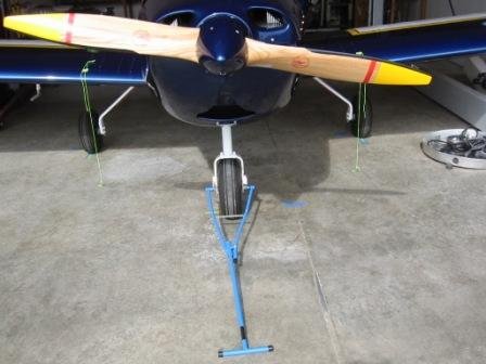

webmaster(at)upac.ca
PostPosted: Sun Oct 15, 2006 5:37 pm    Post subject: Tow Bar Reply with quote
For the life of me I can't figure out why some people think that pulling a plane from the prop hub is a bad thing. After all, this is where all the loads are from the prop during flight anyhow!!!
I am however very careful to only grab the root of a blade when I push/pull. I've made 2 tow-bars for my 601 so far and my second attempt worked out much better since it's articulated. Total cost of the parts was about $13 CND and 2 hours of cutting/welding and I'd highly recommend making one since it makes directing the plane much easier. Of course this is a nose gear plane so tail draggers will have to figure out a tail wheel bar. Should be easy if you Google some RV stuff.
I'll try and post some pictures next time I go out to the hangar.
