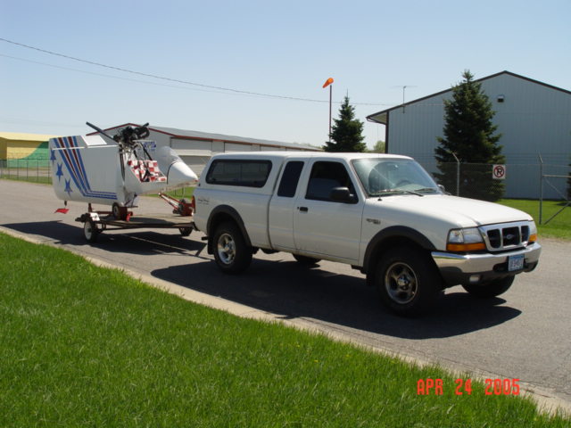

I tow my plane . I used to tow it each time I flew...But now I only tow it
Home for winter storage ( MN ) and then back to the hanger in Spring...
I still fold it up after each flight , that way I get half price hanger rental.
GottaFly...
Mike & "Jaz" in MN
 Filesize:  60.91 KB
 Viewed:  888 Time(s)
