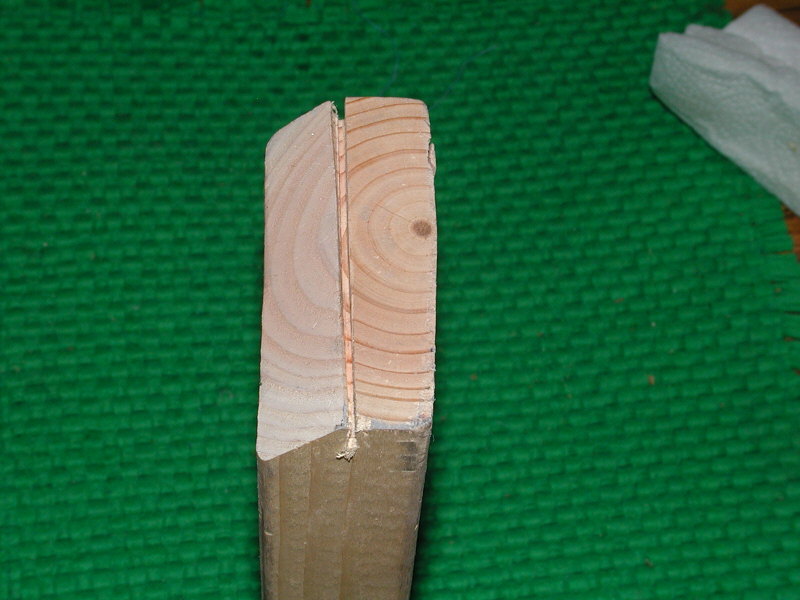

lcottrell
Joined: 29 May 2006
Posts: 1494
Location: Jordan Valley, Or

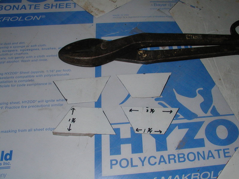

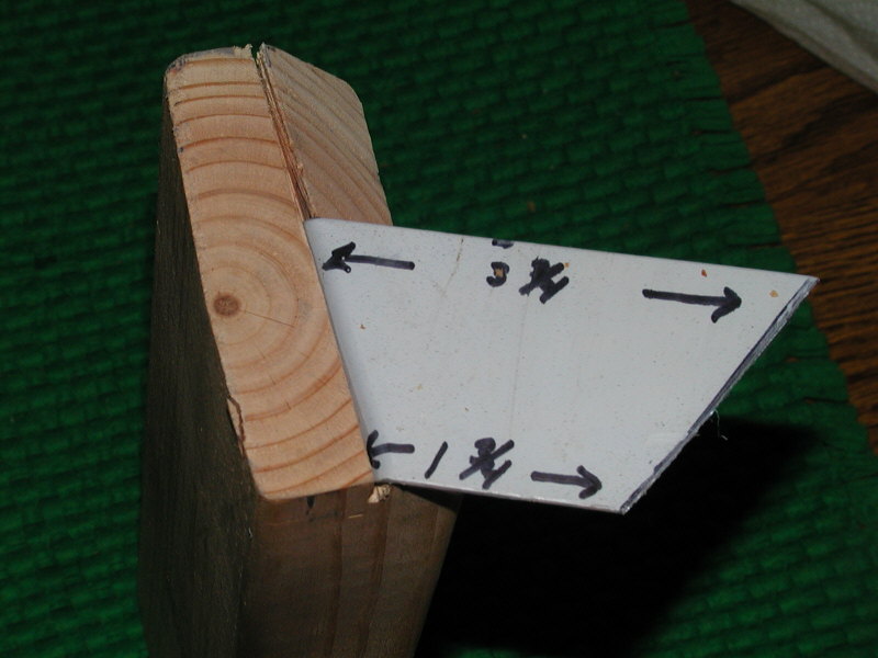

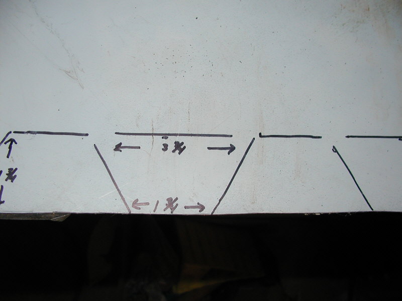

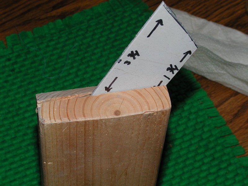

PostPosted: Mon Oct 09, 2006 8:03 am    Post subject: VG's for doubters ;-) Reply with quote
 Filesize:  171.18 KB
 Viewed:  378 Time(s)
 Filesize:  54.83 KB
 Viewed:  369 Time(s)
 Filesize:  89.85 KB
 Viewed:  363 Time(s)
 Filesize:  82.74 KB
 Viewed:  379 Time(s)
 Filesize:  87.89 KB
 Viewed:  361 Time(s)
 Filesize:  69.9 KB
 Viewed:  385 Time(s)
 Filesize:  138.88 KB
 Viewed:  403 Time(s)
jbhart(at)onlyinternet.ne
PostPosted: Mon Oct 09, 2006 9:52 am    Post subject: VG's for doubters ;-) Reply with quote
At 10:01 AM 10/9/06 -0600, you wrote:
Larry,
I like your bending fixture.
