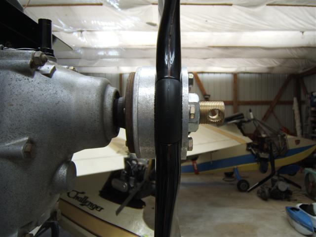

Planecrazzy, Probably never thought of your name in BOLD, but there it is a topic addressed as Planecrazzy.
Brother of the sky. You put a bug in my ear a while back about "you have the 5 inch spacer?", regarding the prop distance from the back of the wing.
I thought hard and long about that and it f, for whatever reason, stuck with me. Today I moved my prop in line with the front mount tabs for the wings and discovered that it is within 39 1/2" of the tabs in front. The prop therefore is within 4.7 inches from the rear of the front of the aileron tube.
However, it is within 2.7 inches of the Aileron horn when it is in the up position. Now, the Aileron horn is midway (approximately ) or greater to the center of the prop . Therefore, the prop tip would not be coming close to it. When IVO states in their installation instructions: " five inches from any obstruction." I find it hard to imagine, but I must believe, that the prop could flex BACK 5 inches and Front 5 inches, or 10 inches total, at the tip!
What has been your experience? Because “in the air is the last place to actually experiment with things that go boom“!
Ohio Ralph
See picture of existing prop mount. Stack-up from ‘B” box prop mount to prop centerline is 2.0”.

Hey Ralph,
I didn't say I had a 5" spacer...I said IVO calls for 5" of clearance...
I have a 3" spacer... ( $80 bucks )
Jack Hart has done some experimenting with the flexing....
He taped paper to the aileron and Flew.... Then he looked at the paper streamers that he had placed in the area of the prop arc...
Jack....Do you have that page or data handy ???
Here's a picture of my prop extention...
Gotta Fly...
Planecrazzzy ( That's 3 - Z's )

Hey, Planecrazzy, Sorry. But what I said was " "you have the 5 inch spacer?" There was a Question mark refering to you (first person) asking me if I had the 5" spacer.
That covered, That is the largest 3" I have ever seen. Must be the angle.
Any help would be appreciated.
Ohio Ralph

David, According to IVO's installation instructions, because of flexure of their brand prop, clearance between the leading edge at the end of the prop (my assumption), can be as much as 5". I'm not sure if the fact thta the prop could be used on a pusher as well as a puller if the 5" clearance is total fore and aft or per side. Thats a lot of movement in my humble opinion. Now if that is only at the ends of the blades (tips), then half way up on each blade half (or 1/3, if three blade) would not flex any where nera that amount.
I really don't want to stick a spacer that long on the back of my gear box. If I am anywhere near correct in my math, the longer a moment is the more foot pounds at distance it has to work with. Even if the clearance is minimal between the bolt shank and the individual mounting holes, it has a larger moment of purchase. I also know that the sheer rating on these bolts is pretty high but man.
| Ohio Ralph
Ralph:
I believe the blades flex most on start up and shut down. Hooking a
strobe light with sensor to your airplane, and shooting it at night
will show you just how much the blades dance.
Early on with my 912 and again on my 912ULS I had blade strikes on
start up, but it took a long time to determine that this was when the
strikes were actually happening. A two inch extension on the 912UL
and a 4 inch extension on the 912ULS took care of that problem.
Coning of the prop can best be demonstrated with the main rotors on a
helicopter. If you get a chance to watch a Flying Crane pick up a
heavy load to a hover, you will see what coning is. That's because he
is maintaining an operational rotor rpm and increasing pitch and
power.
I don't know how much coning effect we get with IVO's or Warp Drive
props in flight. Perhaps Jack Hart has done some extensive
experimentation in that area. I doubt that there is very much based
on prop speed and fixed pitch props. As rpm and airspeed increases,
seems like centrifugal force would reduce coning.
I don't think you can see how much the prop blades flex on start up
and shut down, but when you get a good blade strike, you can feel and
hear it.
